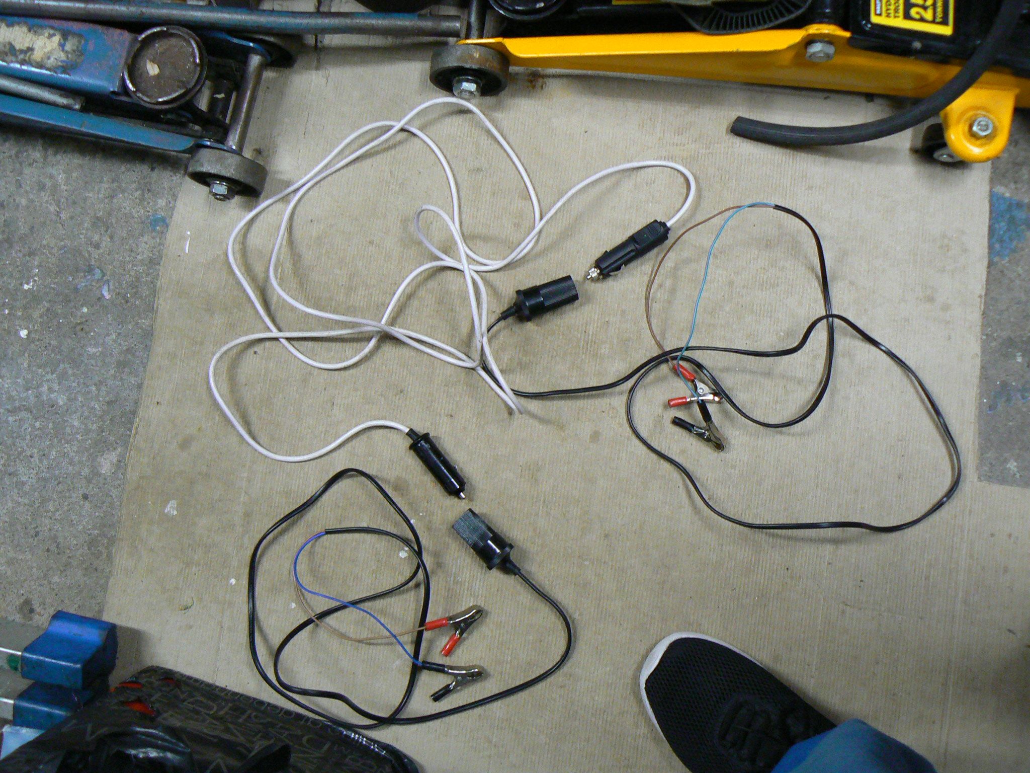

Oh yes, I learned about "unexpected" current draw some years ago. I built myself a set of "minder" leads with the ability to have either croc clips or ciggy lighter connection either end:
It is quite versatile and I was getting on well with it until I used it to save the radio code on my boy's Punto whilst we removed it's battery to replace it with a new one. One of the ciggy lighter adaptors has a fuse in it which blew, probably because my boy opened a door - but I'm not sure. Since then I've replaced the fuse with a solid wire soldered across it (so in effect there's now no fuse and I need to be a bit careful when using it). The only problem I now have with it is that if you are using the croc clips on the battery lead terminals it's quite easy to knock one off when you're removing or refitting the terminals to the battery posts.
Of course, as anyone who knows FIATs will tell you, I didn't need to use the leads on the Punto because, for many years now, FIATs have stored their original fit radio codes in their body control computer module so when you reconnect the battery it will automatically recognize the radio without having to feed it the code manually. So this gave us a "get out of jail free card" when we were doing the Punto battery!
On reflection, I get on quite well with these leads as long as I'm careful what I'm doing so maybe I should forget about the OBD port connector and just carry on with the "devil" I know?
