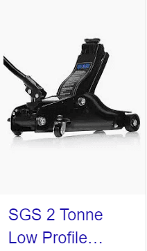

Consider your scissor jack for emergency use only for changing a tyre when in a pinch!
If you intend to do your own maintenance - get your self a floor/trolley jack and some axle stands.
This is mine - not expensive.

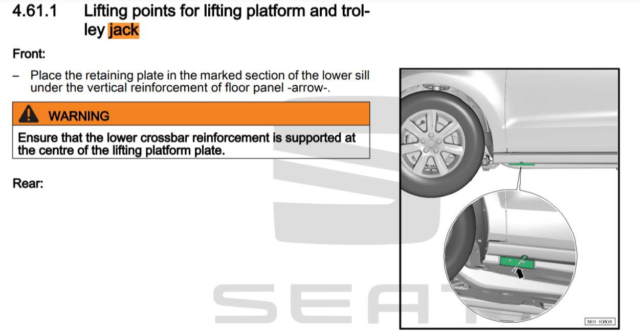

Many thanks for the info. The owner manual only mentions using the reinforced section of the rail behind the sill. So I should use the trolley on the sill, then use an axel on another load point? I have seen another post about these "hidden" load points on the subframe but a bit unsure where they are...
SuperV8
May 30, 2019
1,359
604
The sill has a small mark front and rear - this is the area suitable for lifting where you would put your scissor jack. Using your trolley jack on the sill you should use the rubber bung I mentioned above.

So long as you use the official reinforced jacking points, it's fine. It's how I change the pads and discs on my cupra ST, and it's no different if you were jacking from the front and then putting the axle stand on the back.
There's just not enough room normally to fit the jack and an axle stand side by side at the same point.

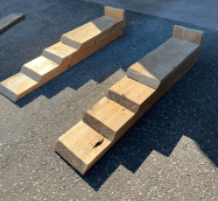

For oil changes - I suggested the easiest method is ramps, rather than jacking.
You can build simple wooden ones:
e.g.
I'm perhaps veering towards using ramps ( + chocks for the rear), I only recently bought the trolley jack (a Sealey 2.5 ton low profile one), so could actually return it to Halfords, though I guess might be useful if I ever need to take a wheel off. I'm a little nervous about getting the car onto ramps, though, can see it could all go horribly wrong if you mess up the approach or overshoot (though I guess having stops at the end make that less likely). I don't have a workshop (or the ability) to fabricate ramps myself, so would need to buy some off the shelf ones - maybe something like these Rhino Ramps. though the top platform looks a bit short?: https://dieselpartsdirect.co.uk/11909mie.html
