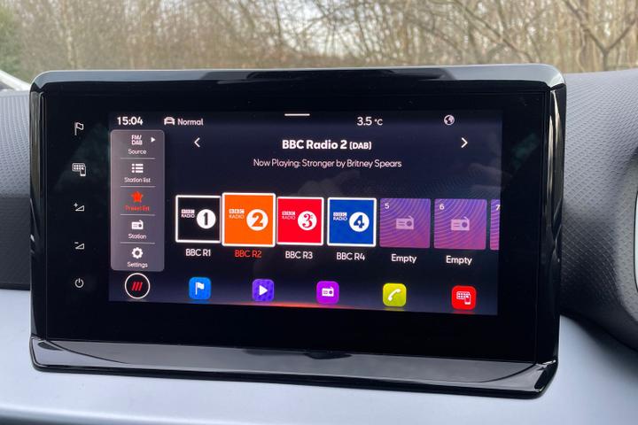

The 9.2" screen infotainment system on my FR model *does* have navigation, if it makes any difference. It looks the same as this one (picture not of my actual car):

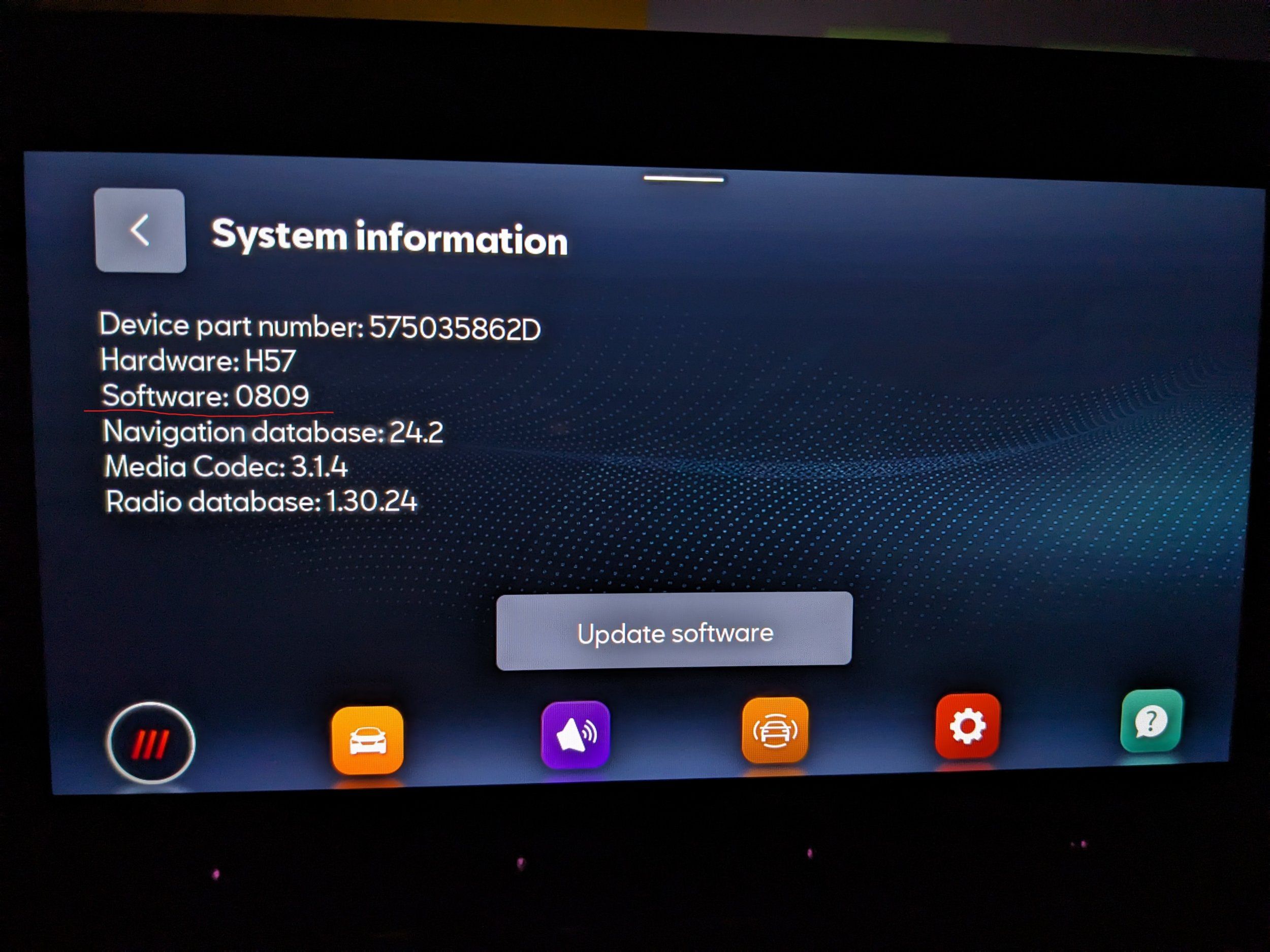

To find out which version is applicable to your unit, go to settings & then system information. Here you'll find your existing version information.
I got there in end, part of the problem I was having was that the main "Settings" icon wasn't displaying in the bottom bar by default, but have now figured how to add it. Looks like I'm on Firmware 809, so think I'll need to get the firmware download.

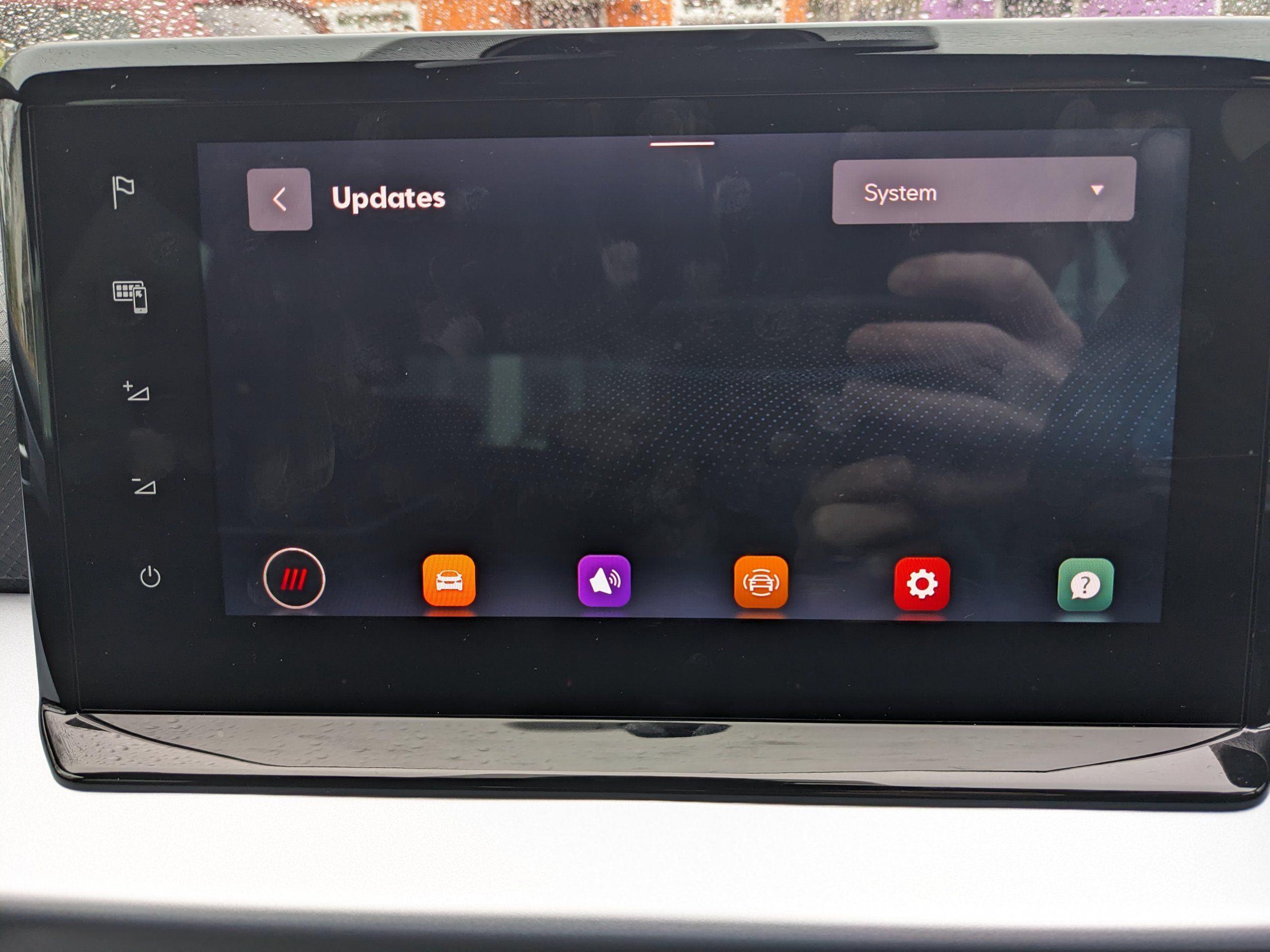

Hi - so I purchased the 0870 firmware update and copied the extracted folders to the root of my 32Gb USB-C drive (which is FAT32 formatted), as indicated in the MIB3 5F SW Update guide, but I can't see how to actually apply the update, I've:
1) Turned on the ignition

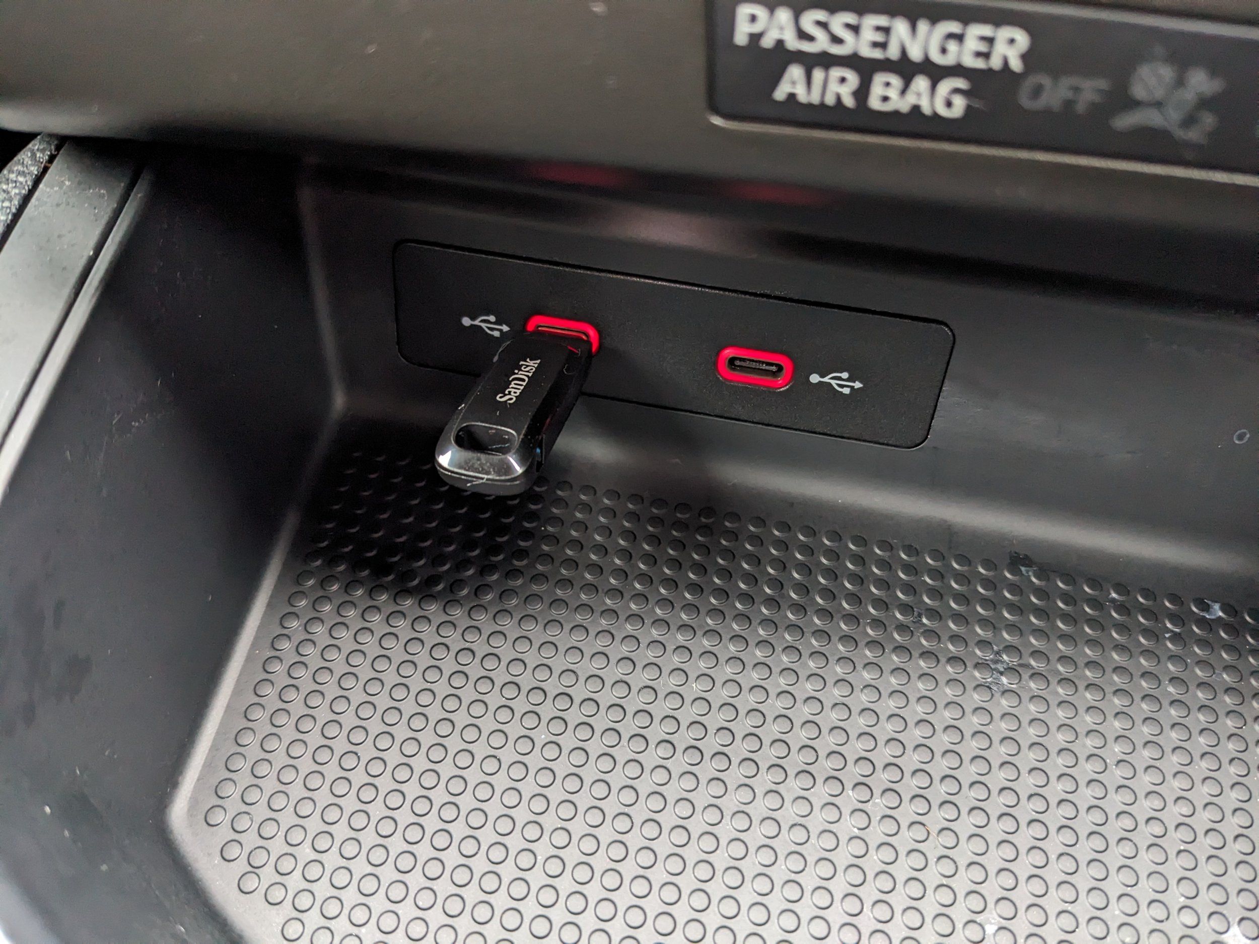

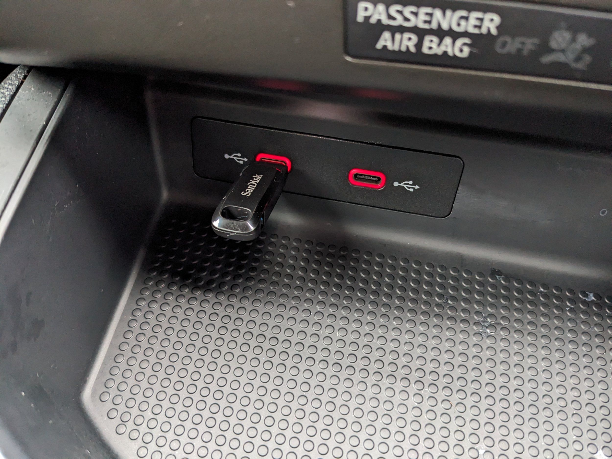

2) Inserted the USB-C drive into one of the car's USB-C ports
3) Navigated to the "System Information" settings page
4) Then clicked the "Update Software" button on the "System Information" settings page

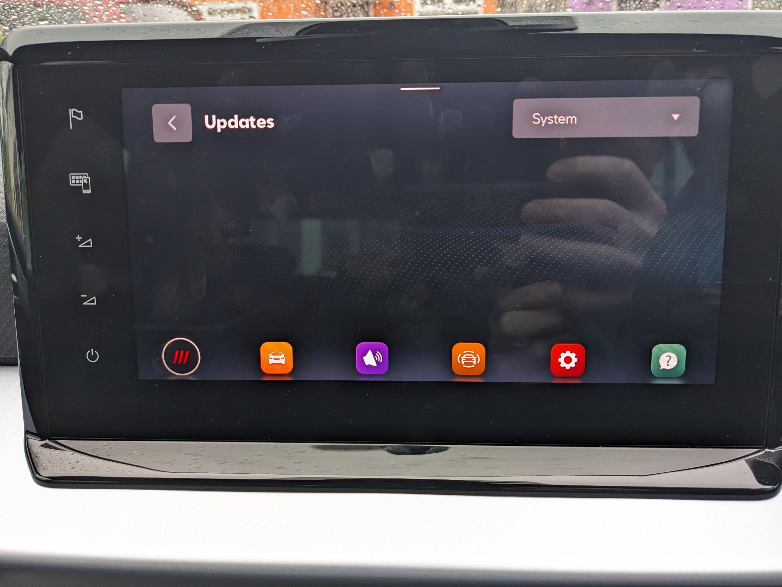

5) I then see an (empty) "Updates" page, but nothing happens and I can't see anywhere to trigger the update from the USB-C drive:

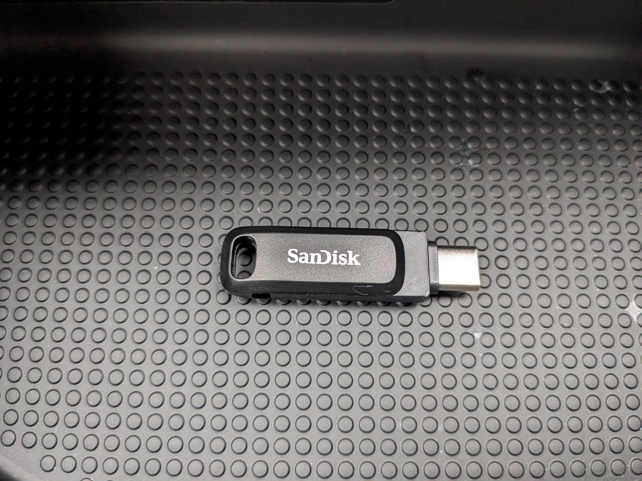

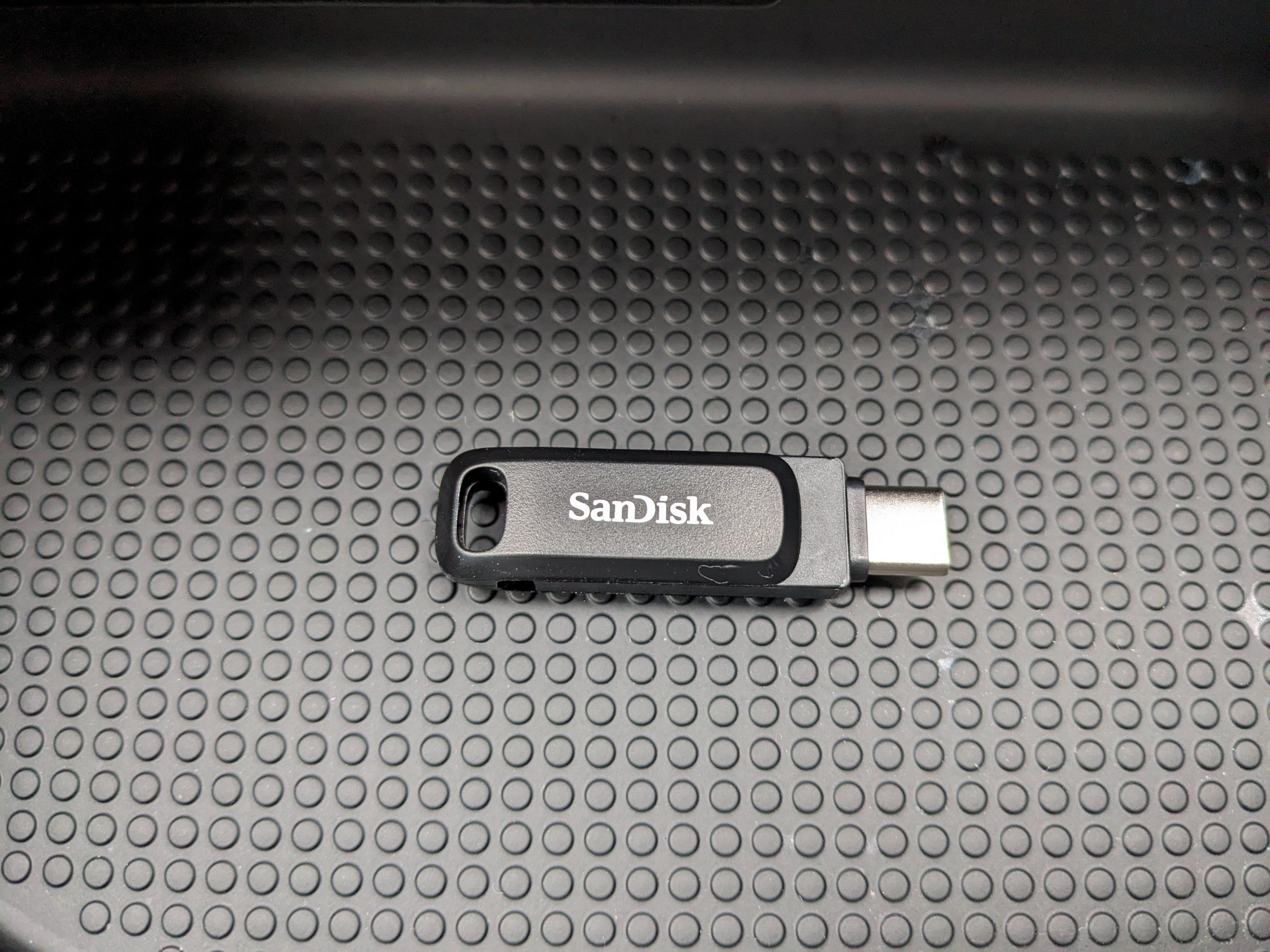

The USB-C drive is not using an adaptor of anything like that, its just a double-ended USB-C/USB-A drive:
Any suggestions for how to get the update to apply?

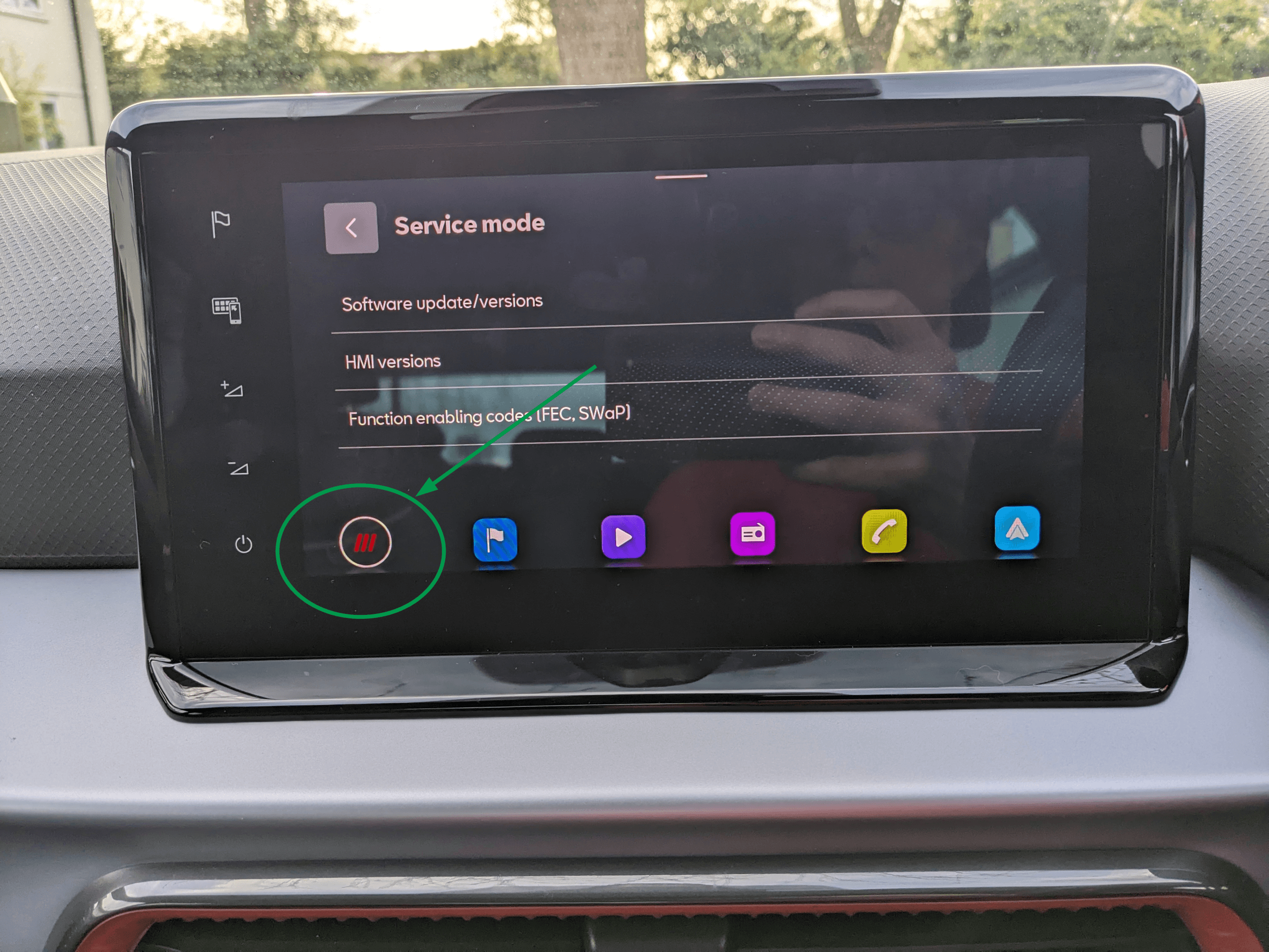

Please have a read through the instructions again. You need to hold the menu button, then go to software updates. The unit will then reboot into the engineering menu and allow you to update

I've not been able to get it to do that, I don't understand which "menu" button I'm meant to hold, I don't see any physical or on-screen menu button and holding down a press on any of the on-screen "Settings" buttons either does nothing or does something else. I guess I'm perhaps missing something obvious, but I don't get it.

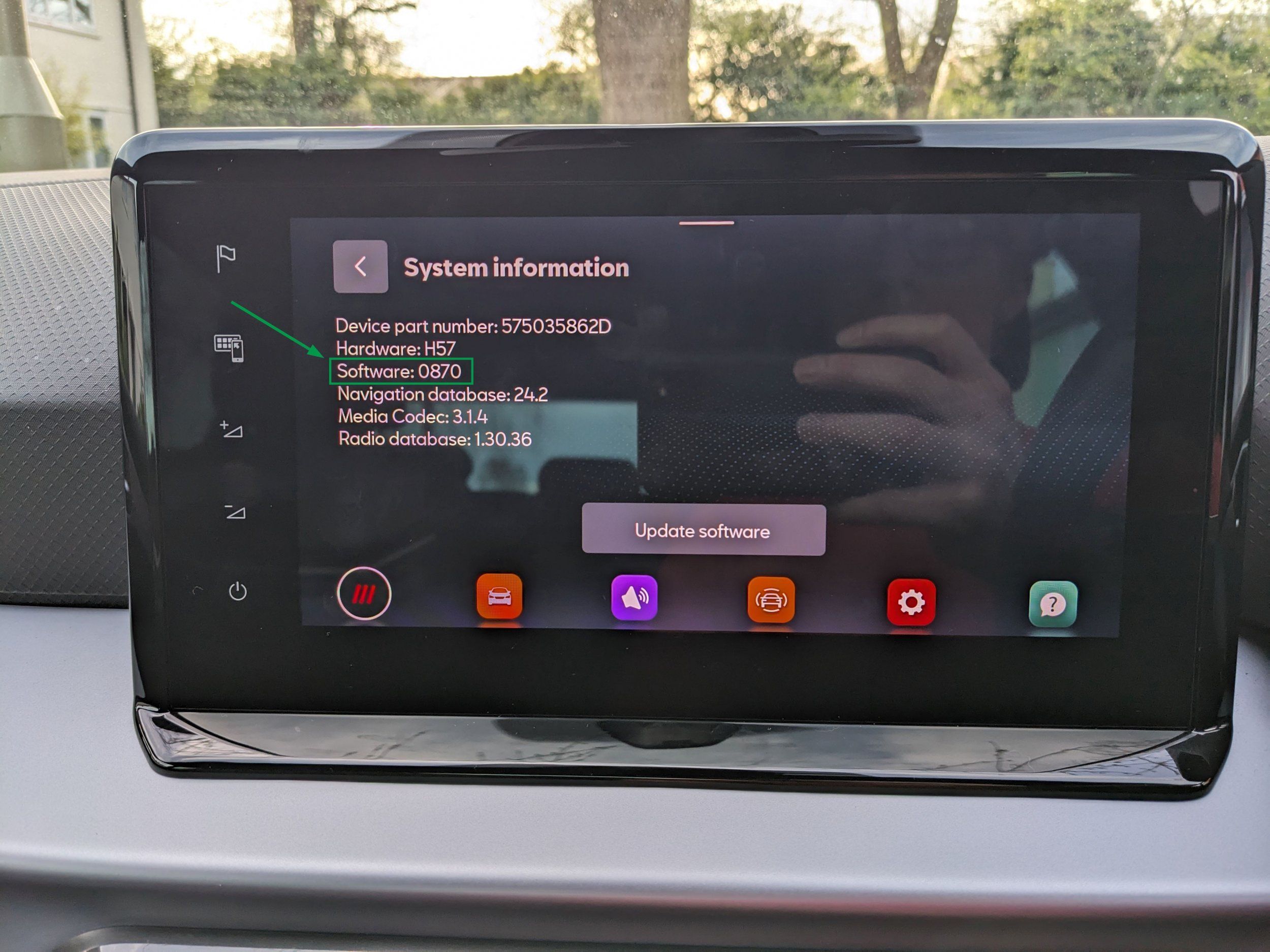

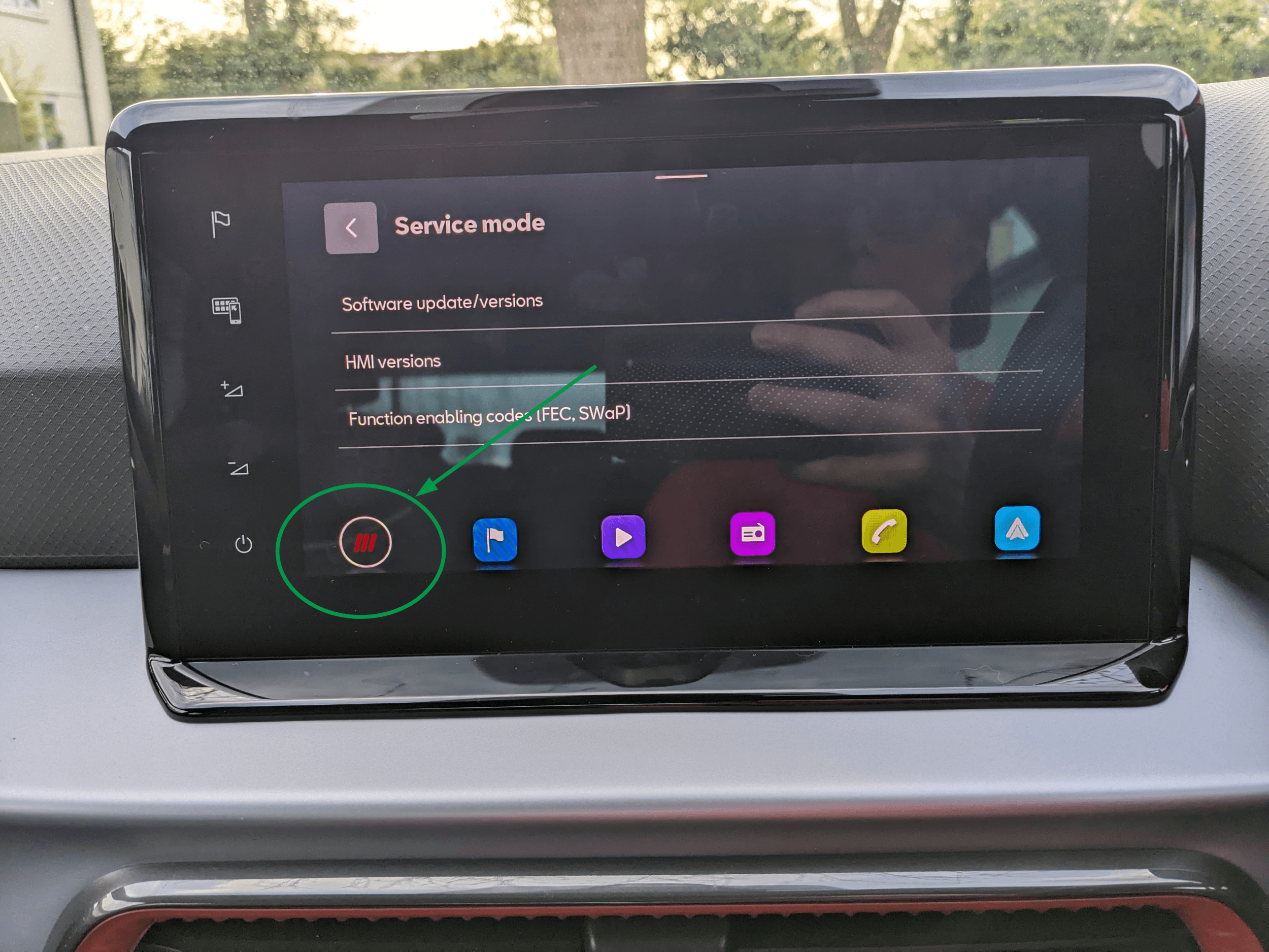

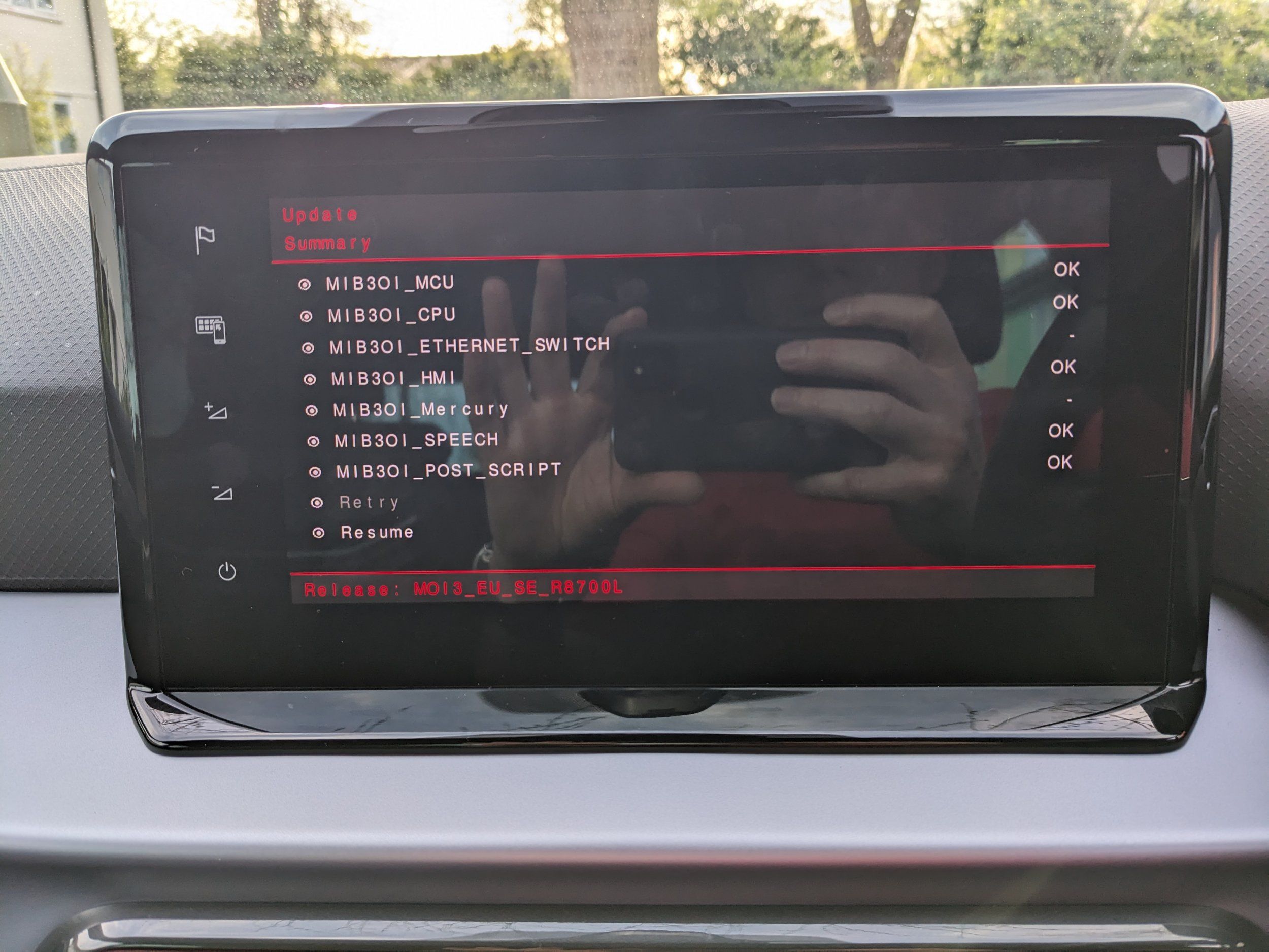

Okay, i figured it out in the end, I needed to hold down this button on the screen to get to the "Service Mode" page:

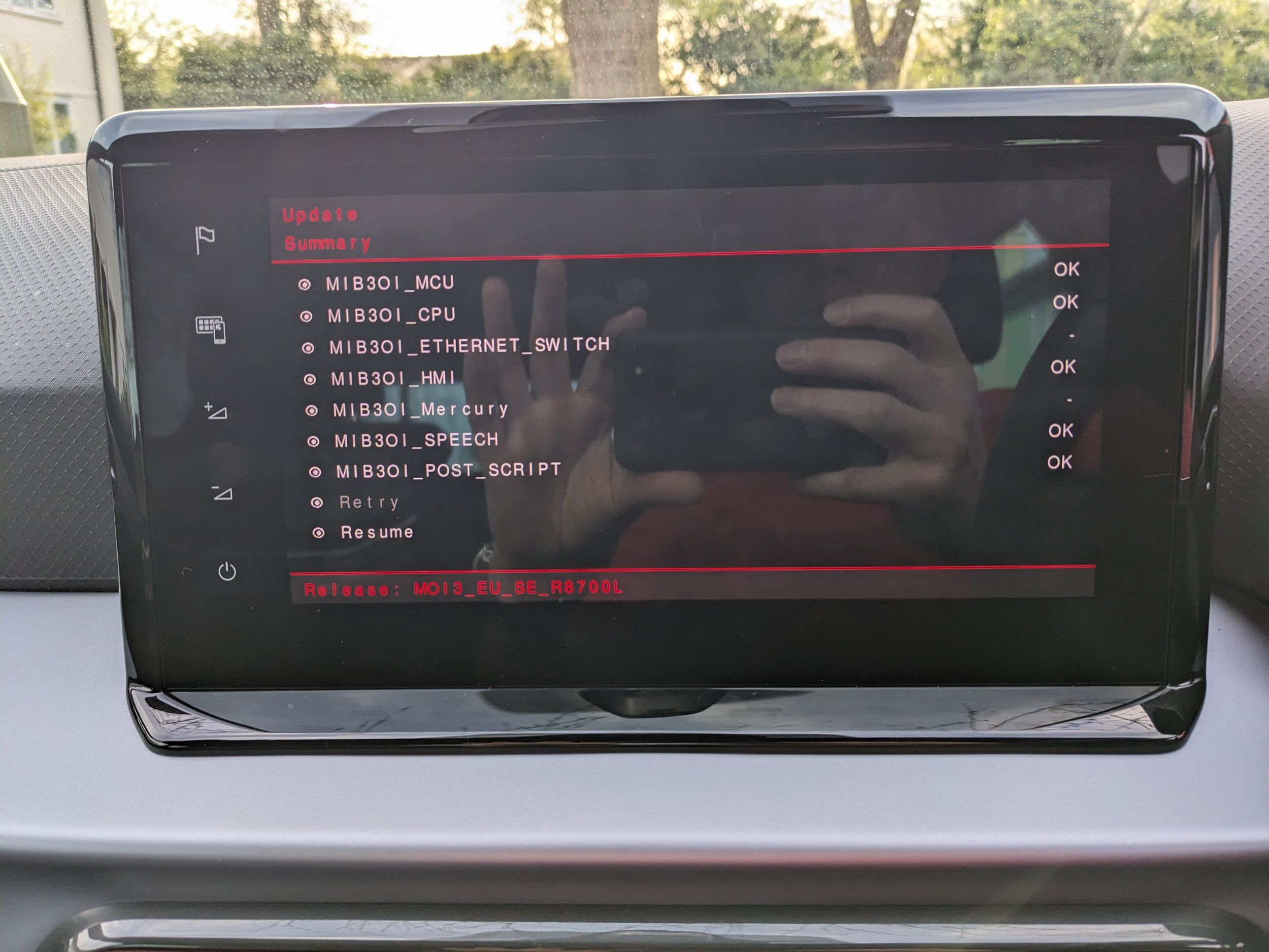

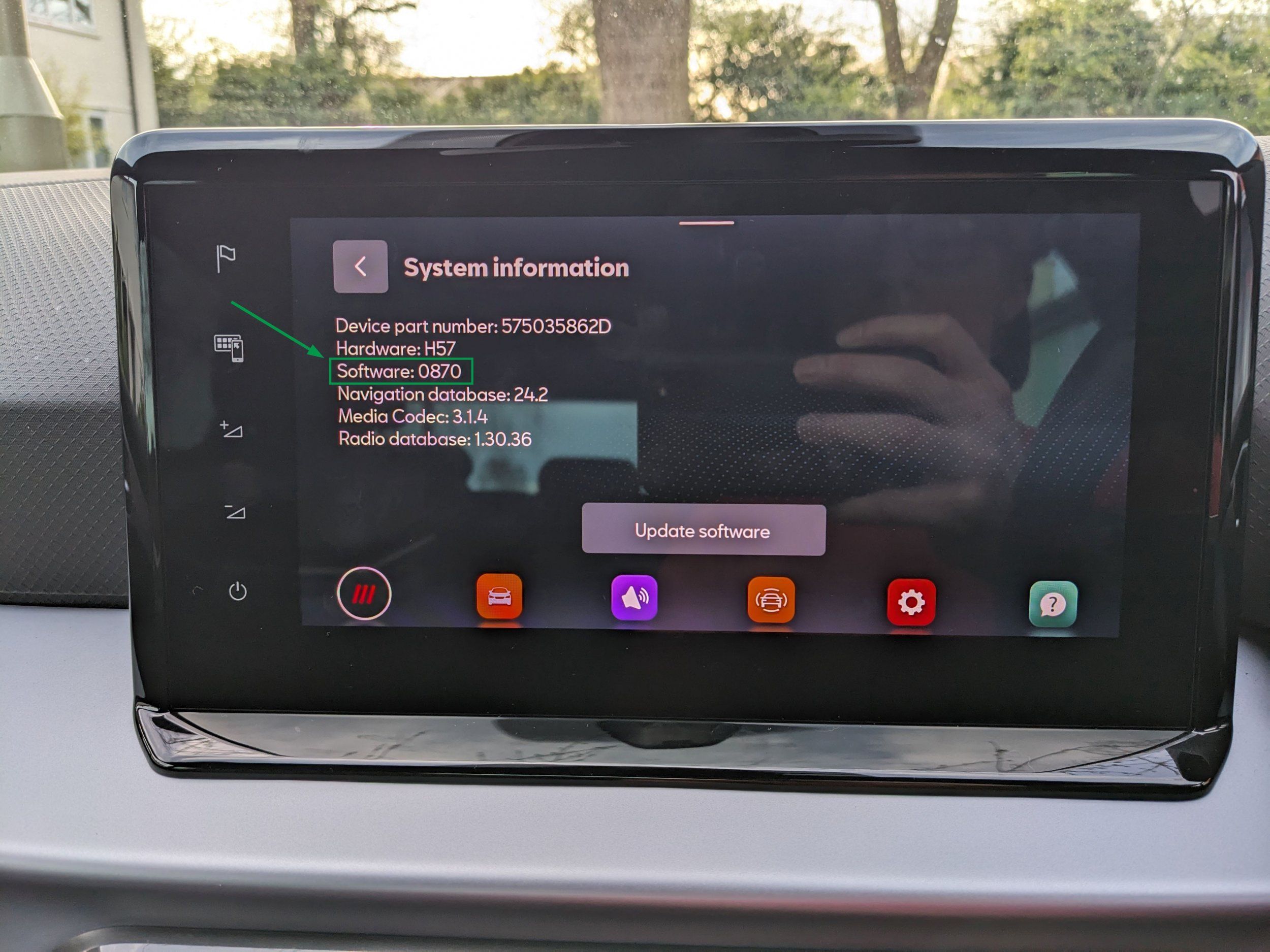

I was then able to get into the red engineering section and apply the 0870 updates:
So I'm now updated to 0870 :)
So all good now!
