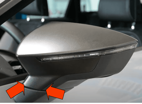

Not sure about all of the issues that you are having but I had to replace the drivers side mirror a few weeks ago due to the motor failing. It got stuck sort of halfway and you could manually force it to click back into the mechanism but then it's at a quirky angle and unusable. To get it in a usuable position it's out of sync and a little bit loose/floppy. Short term fix but not ideal. Heating and mirror adjustment still work.
I ended up buying a new OEM one on eBay for £80 and fitting it myself using a couple of really helpful You Tube videos. Took about an hour and some trim removal tools.

That's exactly what mine did - so it's knackered!
Changing is the same as non-powered, except there is one extra set of wires and connectors for the motor and that's it.
I used these 2 You Tube vidoes to help remove door card and then change mirror.
Door card.
This is the N/S door but mine was O/S and the process is the same. Just be paitient with the clips and understand how the specific trim tool unlocks them (I watched that part of the video a few times).
Mirror:
You will need some plastic trim removal tools to get the door clips off. Or you can force them and break them and buy some more.To be fair, you only really need 2 of the tools but they are good for other things.
I used this one:
Spare clips:
Even using the tools, I still chewed up 3 clips and will replace them in the spring when the weather is more agreeable. They still work but the door card rattles at the bottom when I shut it and it's not a proper snug fit.
Replacement Mirror:
The cover is primed and you just take it off and fit your old one.
Mirror cover removal:
Some seem to pull off easily and some need a trim tool to help it. BE CAREFUL if you use the trim tool along the bottom edge. I split mine slightly because it's a bit fragile, particularly in cold weather.
It was pretty straight forward and really nice to have the mirror working properly again.
