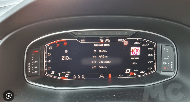

serdar_18fr
May 29, 2021
337
200
I had no idea there were two versions, thanks! Is it possible to find a 300 with the revised version or would it only be on the later 290s (which came in on a 68 plate). My preference is the 300 because they don't have the GPF
I only know that the factory started to use revised version after 31.07.2018.
The cars built later than that should have the new one.
I don't know when exactly 300 production ended or 290 production started.
It would be fairly easy to check yourself by pushing the view button on the steering wheel repeatedly and look for the view with the squared off dials, as in the attached photo, or asking the owner whether the cluster has this view.
Reactions: jr795
