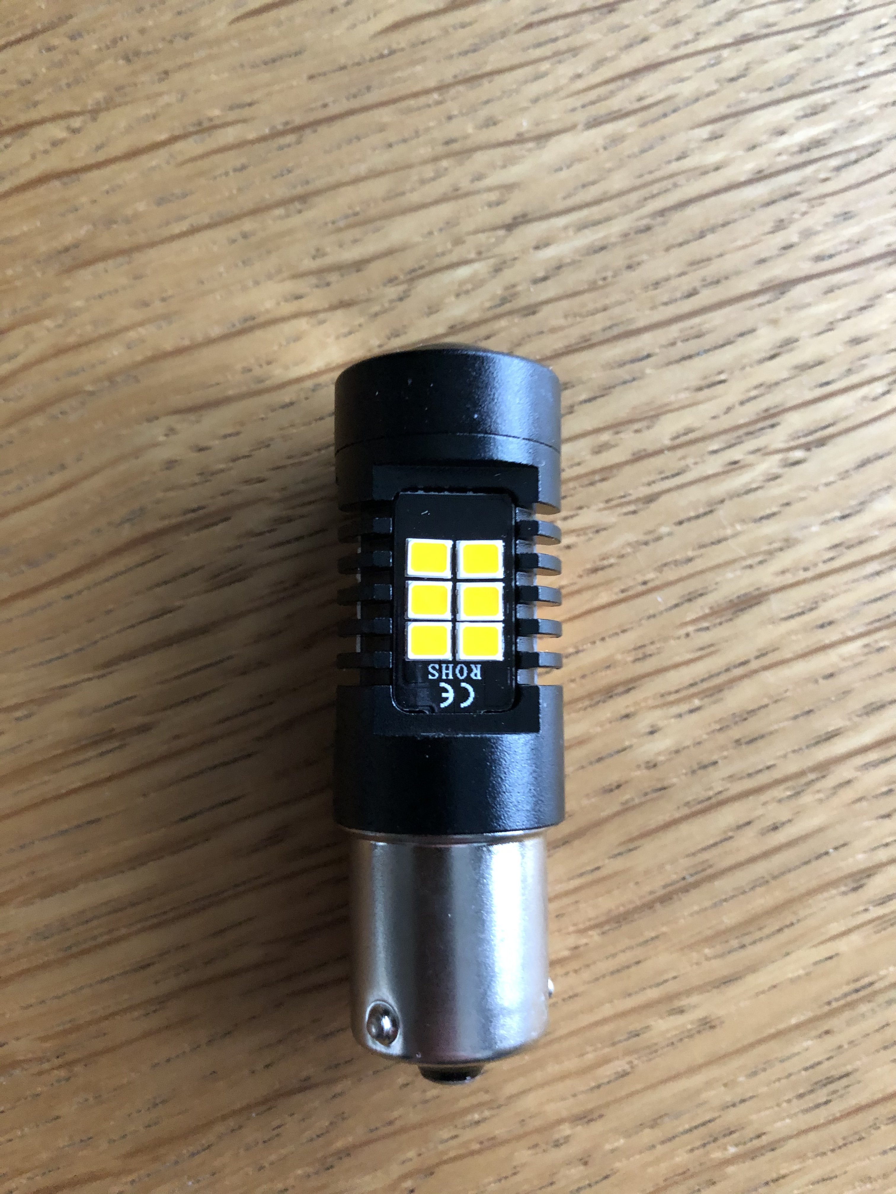

The Spanish Ateca board has picked up on a 21 SMB rear indicator, VANSSI 2x PY21W LED Bulb BAU15s 7507 LED Amber 21SMD Replacement Bulb Turn Signal Indicator Lamps High Performance Black Series. These have been found to be Canbus error free. The light strength is about twice that of the original.

This is what they look like against the bulbs I took out:
Fitted in the car not illuminated, heavily reflected around in the reflectors:
Essentially there are three SMBs mounted behind a top len, plus 6 mounted per side on a three sided bulb construction ((3x6) + 3 = 21) - see first picture and links.
Below is a picture showing the left one fitted and the right one with the standard bulb. The different brightness levels can be seen:
Fitting can be fiddly opening up the mount which is contained by four lugs but depends a lot on luck. The left was easy, right more difficult to release the final clip.
