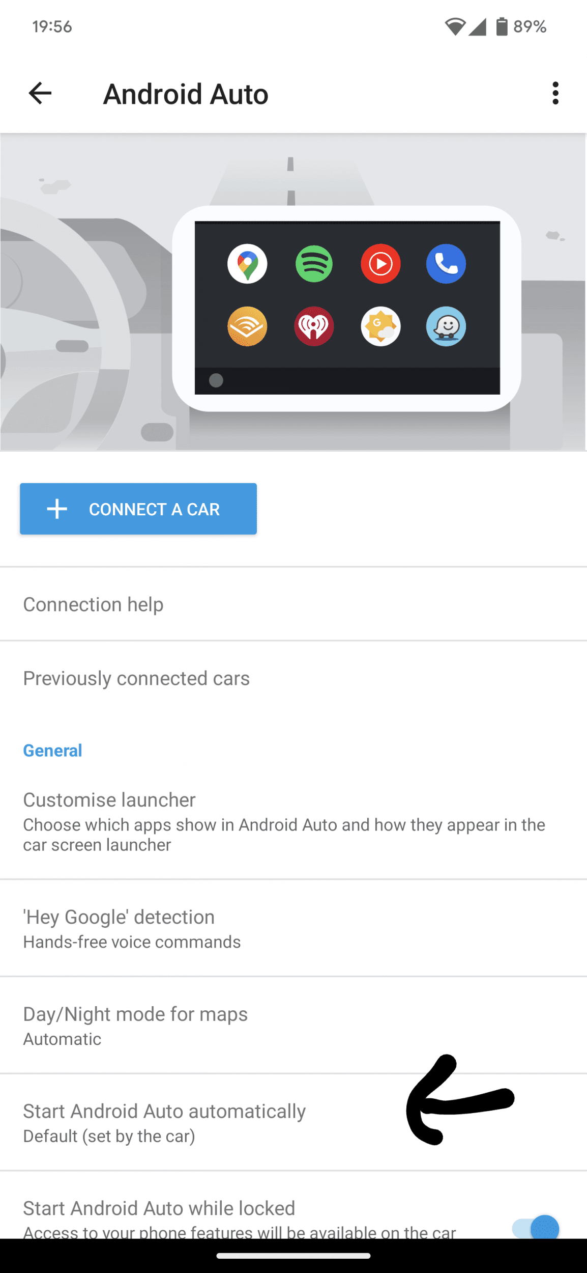

Hi Horsebox,
could you tell me where in the phone setting can i do that ?
I must be blind but i cannot see the needed parameter :(
Thanks!
