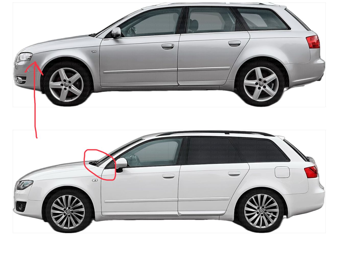

They do look very similar, but there are a couple of very subtle differences that I can see (there may be more) - see the side profile images of an A4 Avant and Exeo ST below so they probably wouldn’t fit. I’m assuming the saloon and Estate versions of the ST use the same front end panels. Similarly, I’m assuming this is also the case with the A4 saloon and Avant.
Differences between the Exeo and A4 appear to be;
  • The waistline crease that runs along the side of each car looks as if it slopes downwards towards the headlight on the A4 front wing (arrowed on the picture), whereas it doesn’t on the Exeo.
  • Difficult to tell for certain (might be due to the angle of the image in the picture) but with the bonnet to wing panel gap where it meets the bottom of the A pillar, on the Exeo (circled on the picture) it looks as if it curves slightly upwards whereas on the A4 it doesn’t seem to, so there may also be differences between the wing to bonnet contour on the Exeo and A4.

Parked my Exeo next to a B7 A4 yesterday & only obvious difference I can see is the repeater seems slightly different shape.
Think only certain way is to have a spare A4 wing & try it!

Looking at these two pictures of each car above, the door handles look slightly different too, however I can attest they are identical as I have 2 A4 doors on my Exeo!
So these sketches might not be perfect facsimiles 🤷‍♂️

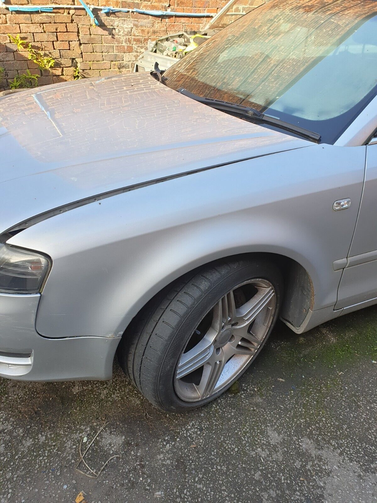

Answered my own question (and yours). The Cabrio looks a very similar shape around the headlights, but with a different rubbing strip (minor detail) and a different pressing against the door (more significant). This one is on eBay for £100.

Thanks for this. What is the difference at the door? Maybe I'm not seeing it?

Ah! I see it!
Cill line different & moulding on Exeo stops on door!
Ah well, back to drawing board! 😄
