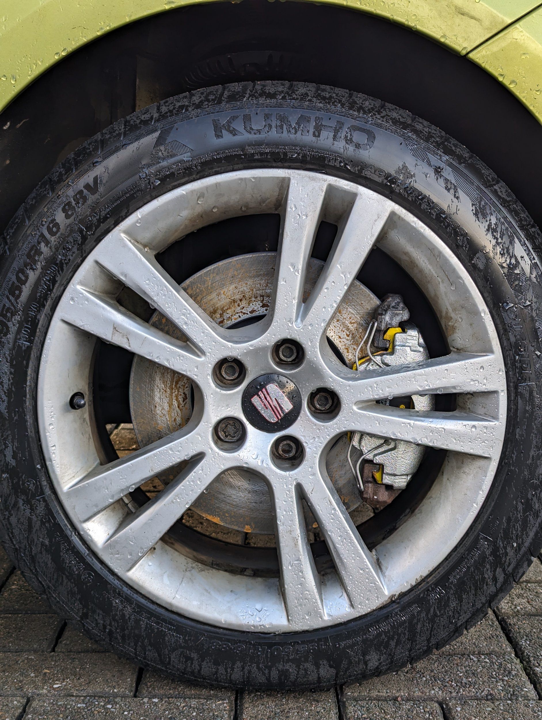

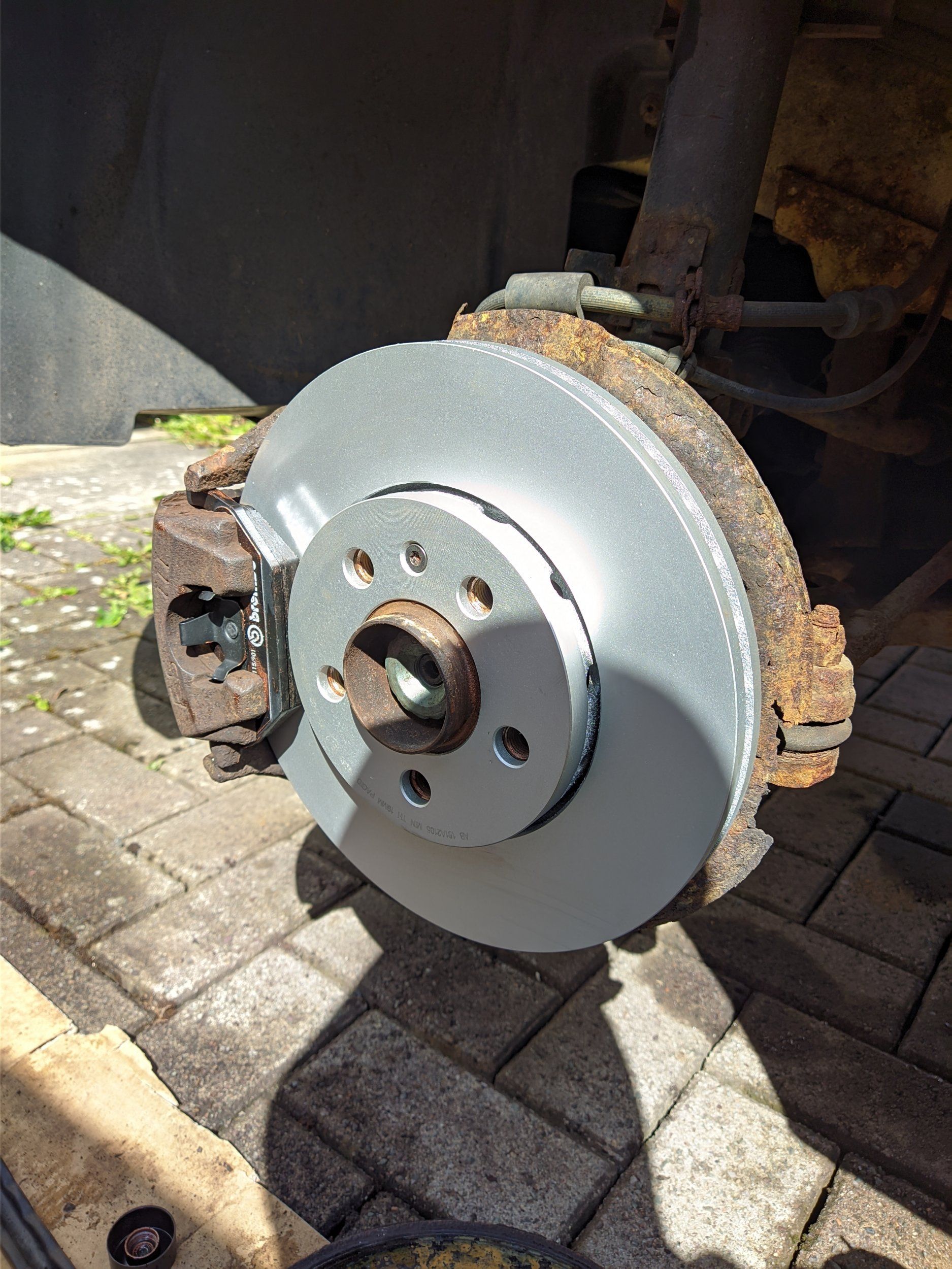

Before, my brake setup looked like this:

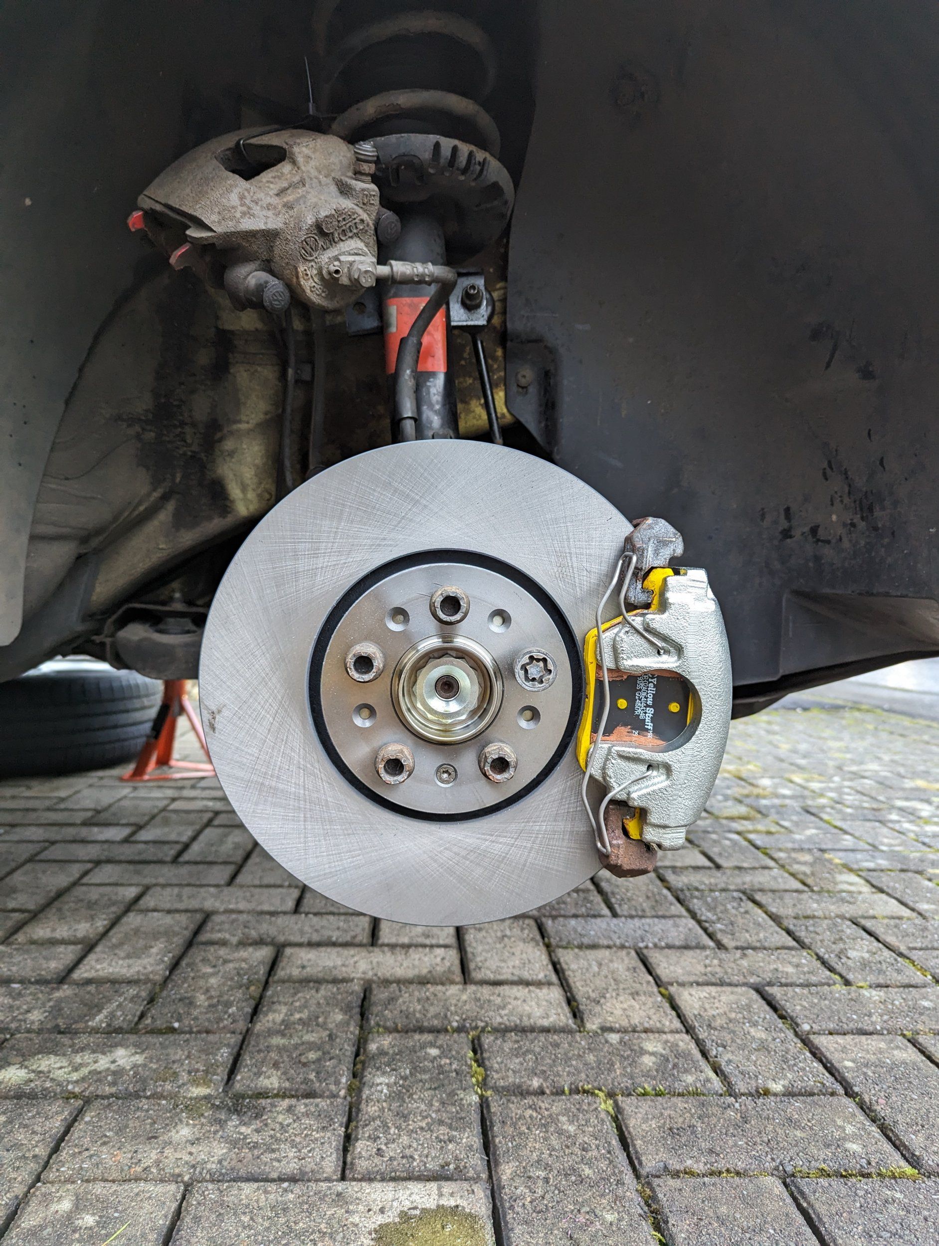

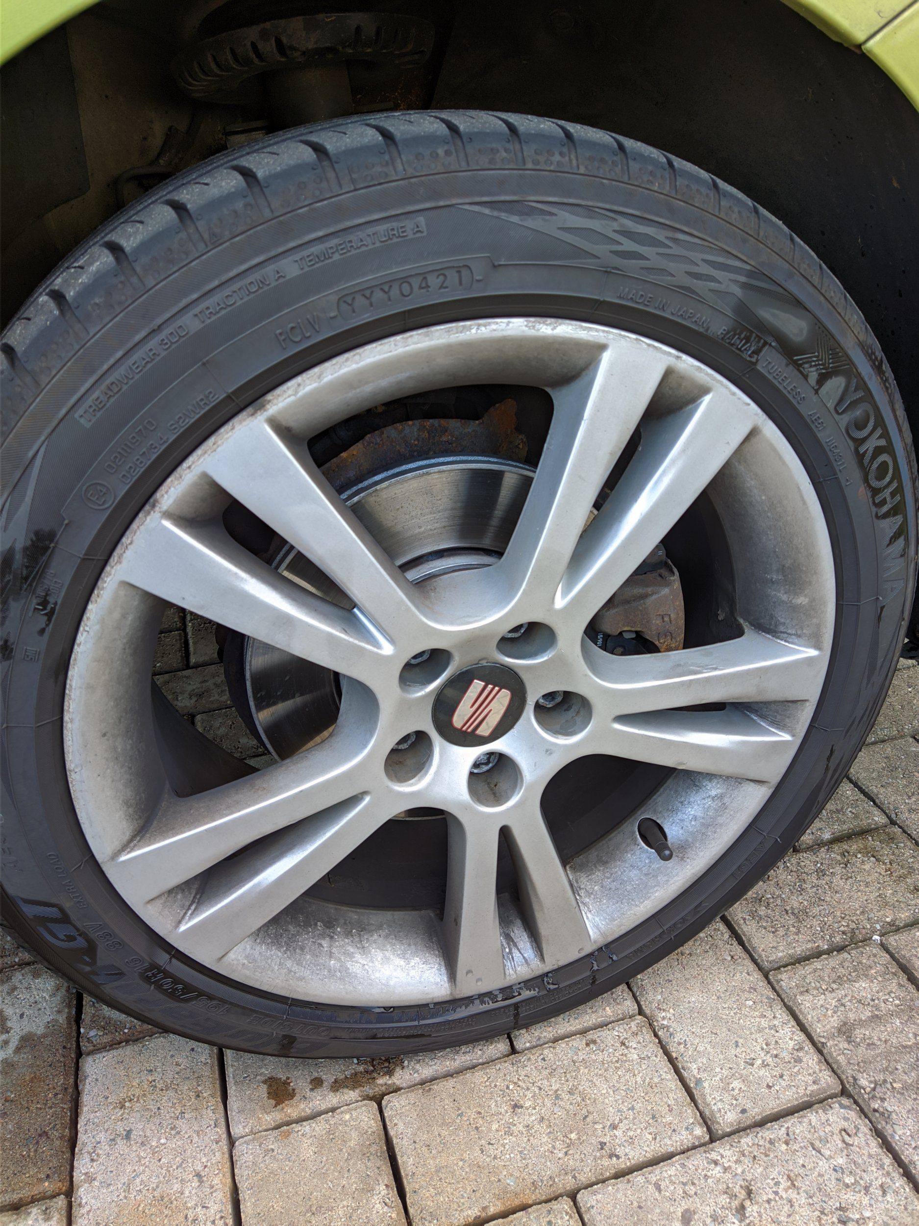

Now, this is what it looks like:

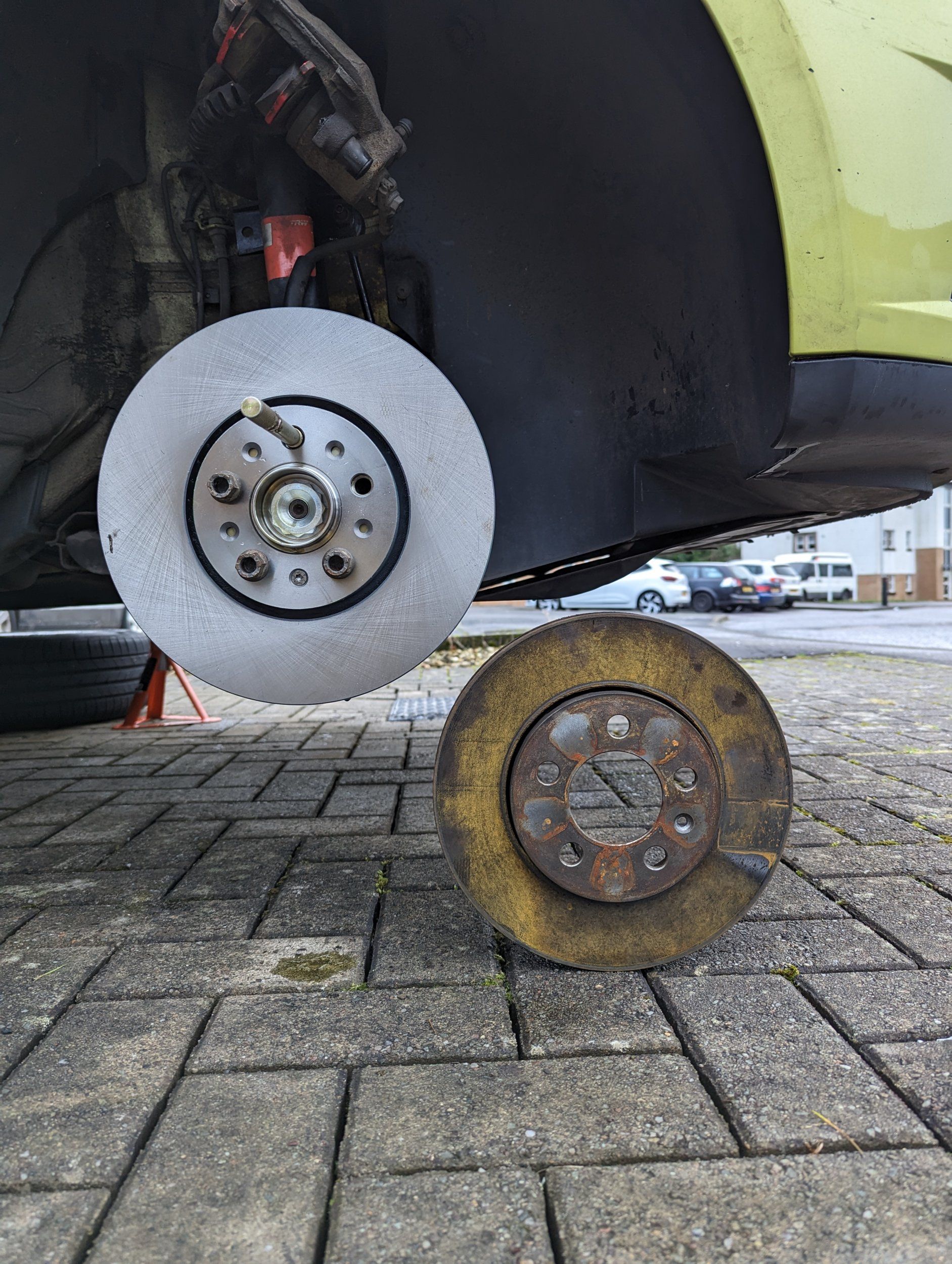

Side by side with the smaller brake disc.
