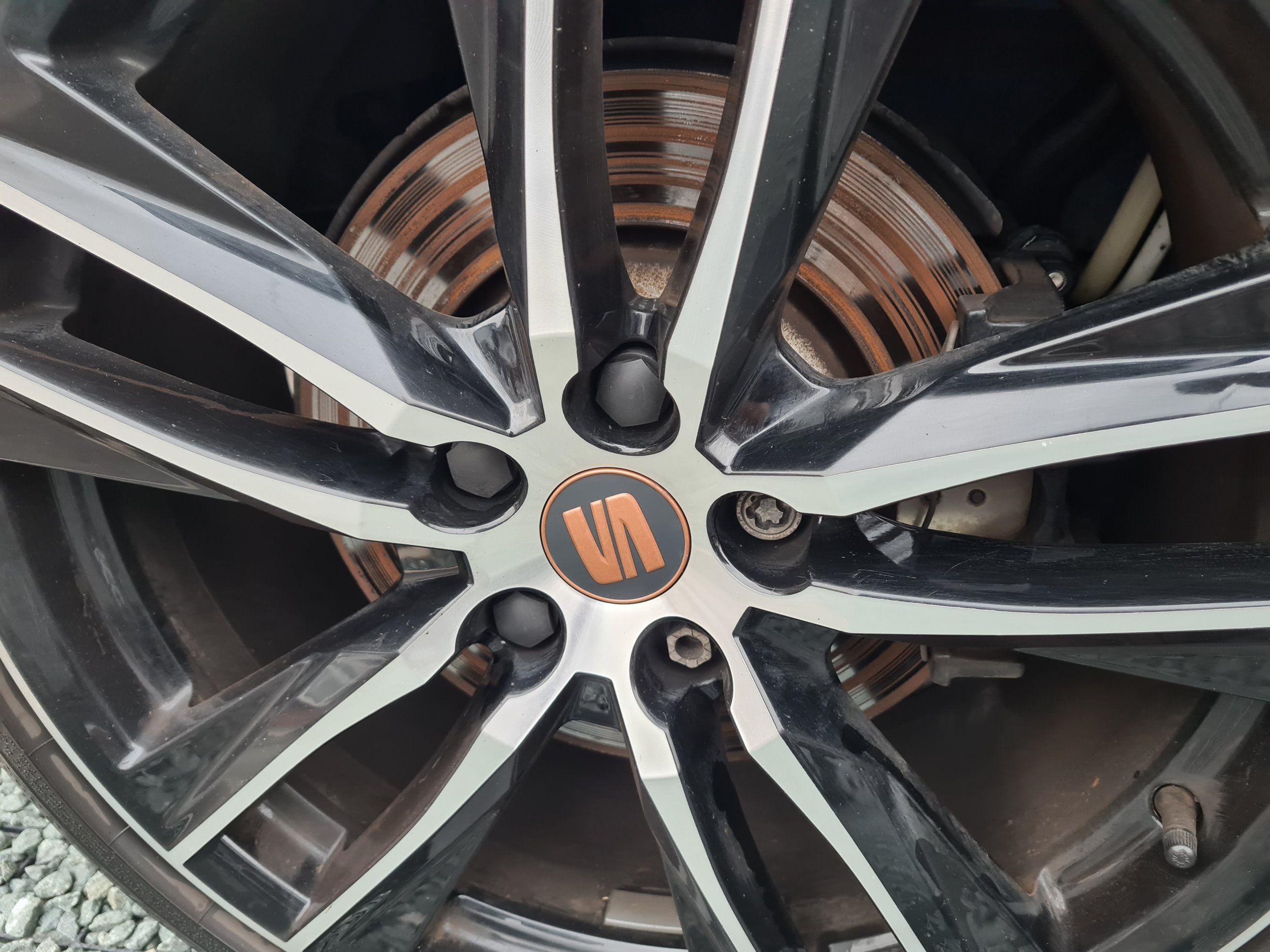

Hi there. I took delivery of a 2019 290 Lux in Mystery blue with full leather, keyless and charging dock from Evans Halshaw last week.
Car is in very good condition. Interior is perfect, externally there a few light scratches as expected and the alloys are good. I know these cars are driven hard so expect a bit of wear and tear after 2.5 years. However rear brake pads and discs need changing by the looks of them and Evans Halshaw are not being very responsive to my request. I have to book in at a local one for an inspection which they can't do until 15th Sept.
I have until Tuesday to send back but am very reluctant due to the hassle!
V5 transfer and awaiting payments etc....
Car has done 11,900 miles and I only have a receipt for a service carried out in June by Evans Halshaw. I have rang Seat who have no record of a service. However its only done 12k miles so may not have been done?
Question is, should I be concerned? Car was priced in my price bracket and similar ones listed at places like Motorpoint, Arval, Cazoo and Cinch are 1.5 to 2k more. There is nothing locally to me either.

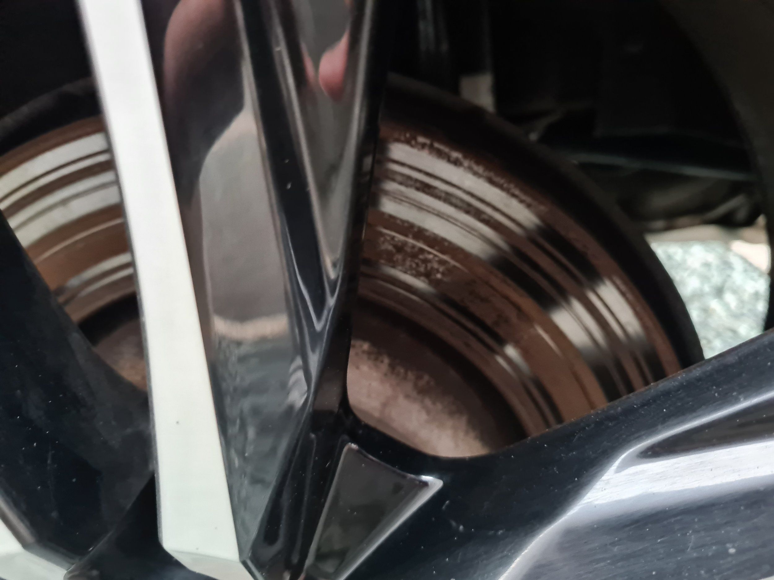

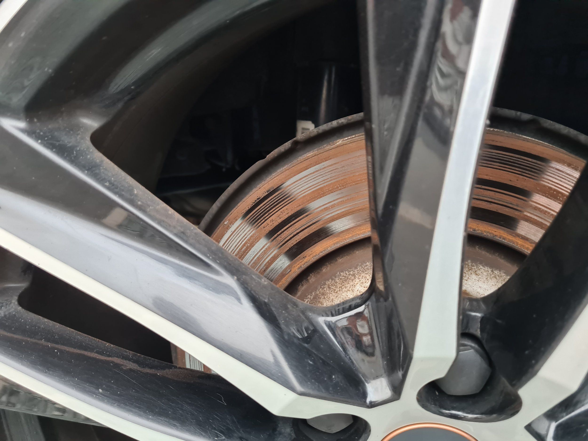

Evans Halshaw say the brakes would have passed the min requirements and my concerns are cosmetic, but there is scoring and 4-5mm of pad left only.
I am in 2 minds to get the brakes done and get a service.
What would you do. Should I be worried by anything. I am concerned about the validity of the manufacturers warranty?

4 or 5mm of pad material is approx 50% life left, how bad is the scoring? Would a roughing off the pad surface be enough to make the clean the discs? Really poor prep, I would have the the disc surface was clear before you picked up the car.

It’s £1500 cheaper than anything else you can find. Keep it and take it to an independent garage and get the pads and discs changed if you’re concerned. I suspect it’s that the rear discs haven’t had much use, and have been stood a good while during lockdown. Rears won’t (or shouldn’t) wear our before fronts.

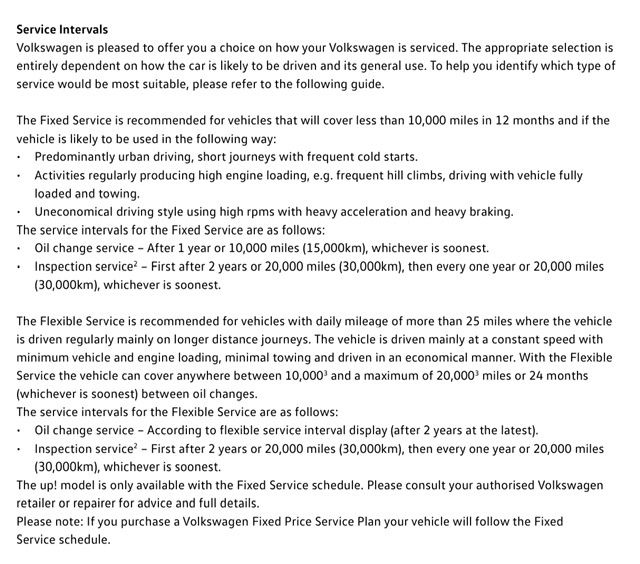

If the car was first registered in 2019 and was on variable / flexible servicing, then AFAIK the first service is due at the sooner of 20k miles or two years. That would explain why it’s only had one service - at two years old. If it was serviced at a Seat dealership or an independent Seat specialist who has access to Seat’s on line servicing system to update the digital service record, then you can ask the dealer for a print out of the car’s service history, although this is unlikely to show much more information than the receipt you already have for the service carried out in June this year.
With VAG servicing details all now held digitally, IMO its even more important than ever to keep receipts of all servicing and maintenance work so you have a historical record of work carried out on the car which could be useful when the time comes to sell the car.
So would it be acceptable to go to 20,000 miles without a service?

I think it largely depends on how the car is used, although modern oil technology means that cars can generally go for longer between services. Having said that, I‘m a low mileage driver and I always have my car’s service regime set to annual time and distance servicing.
My car’s a VW where there are two different service regimes; time and distance and flexible / long life. AFAIK Seat also have these two different service regimes too.
This is from a VW Polo brochure from a couple of years ago, and I dare say the same parameters apply to Seat cars, which are essentially the same or very similar under the skin to the equivalent VW model;

the rear discs look like it's been sitting about for a while.
If an Italian tune up doesn't clean them up I'd look at getting them stripped and cleaned. It's common for the rear brakes on MQB platform cars to seize.

when nobody is looking, drive it hard using all the revs and do several big stops from 70 ;) down to about 30. Get some good heat into the brakes.
If the brakes are OK and its just surface rust this should clean them up.

Update: Have spoke to Seat UK who have confirmed the vehicle was set to flexible servicing so 20,000 miles or 2 years for a service was required. It has evidence of a Service in July this year so 6 months over the time. They are unable to confirm that if I have a warranty issue whether it will be covered until the problem occurs. Should I be concerned?

Regarding your brakes check out this thread: Seems there is a technical builtin for rear brake issue;
