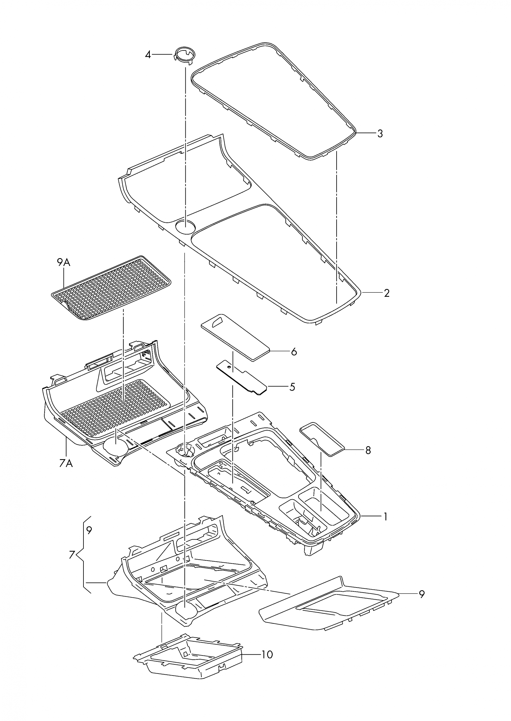

So after some time in PETKA I found the parts that I need.
For the drawer insert: LHD 5f1 857 974a QB(satin black) (7)
RHD 5f2 857 974a QB(satin black)
For the retaining frame: 5f1 864 089 (10)
For the rubber mat: 5f1 863 330b (9)
For the wireless charger- antenna booster: 81A 035 502
for the charger you will need the 6-pin connector: 4b0 971 978C

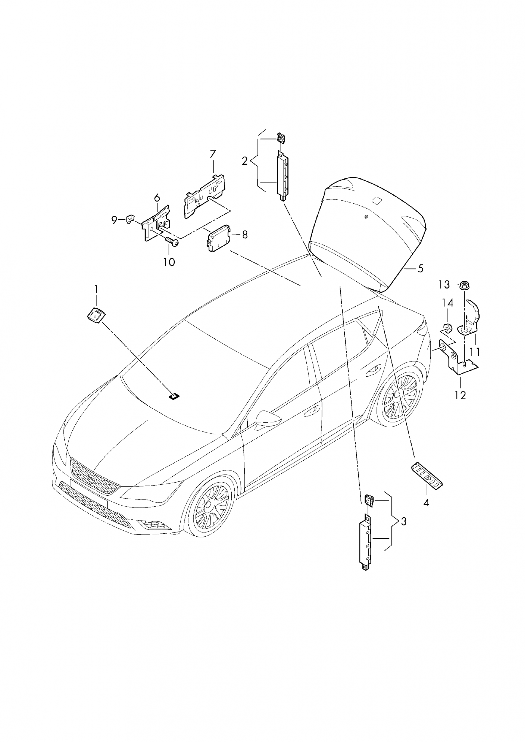

You also can boost the signal but I didn't look for this. but if you need it you will need also a 2way signal amplifier + the antenna + the cables + the brackets and bolts for it and the mounting place is at the rear of the car so...
