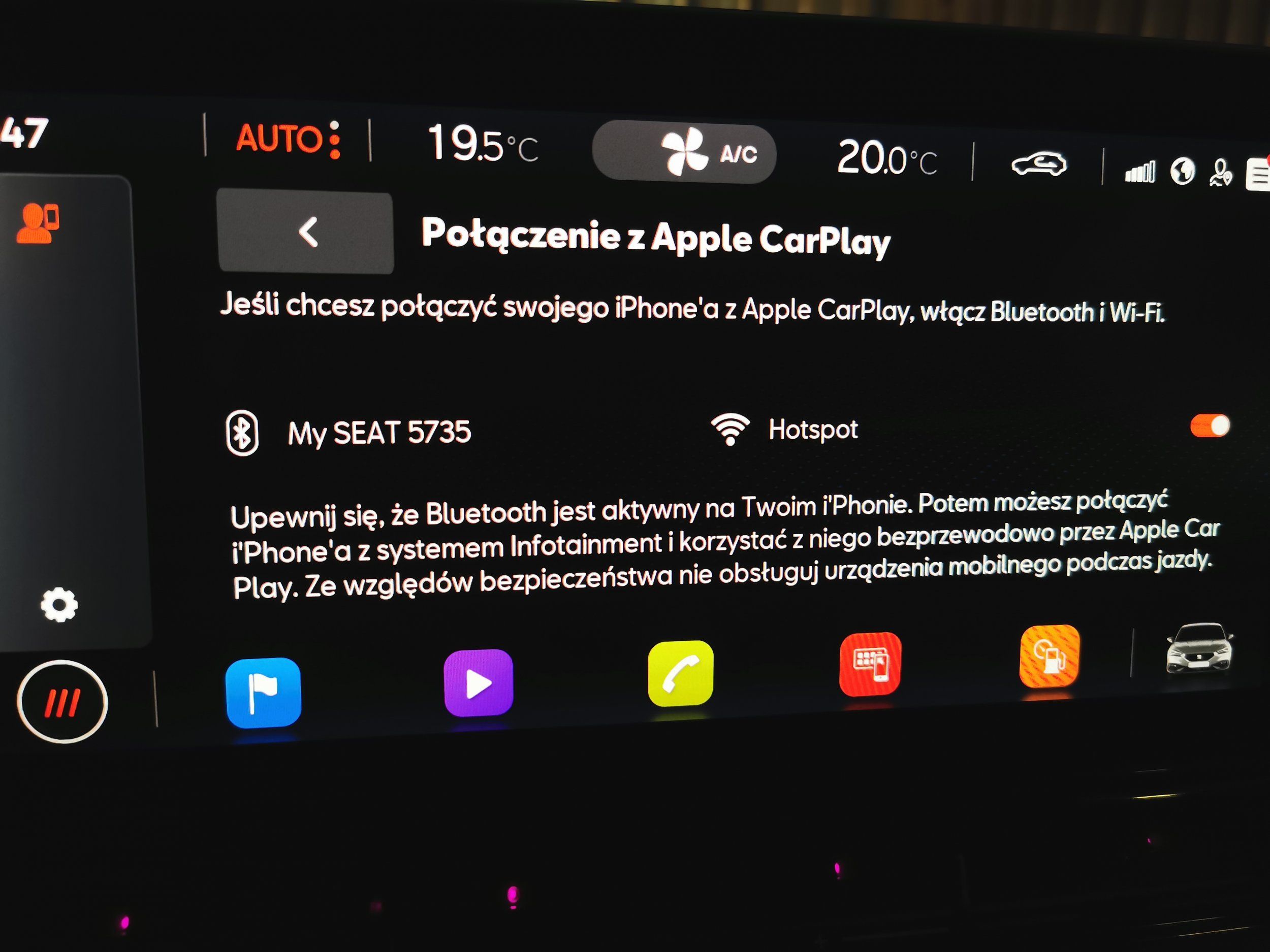

During the test drive, I connected the iPhone, the phone asked if I wanted to connect wirelessly. But that's it, nothing else happened, he never asked again.
In my car, he never asked. The dealer says it's matter an update and we have to wait.
Make sure BT is active on your iPhone. Then you can connect your iPhone to the Infotainment system and use it wirelessly via Apple Car Play. For safety reasons, don't operate the mobile device while driving.
As you can see it works.
