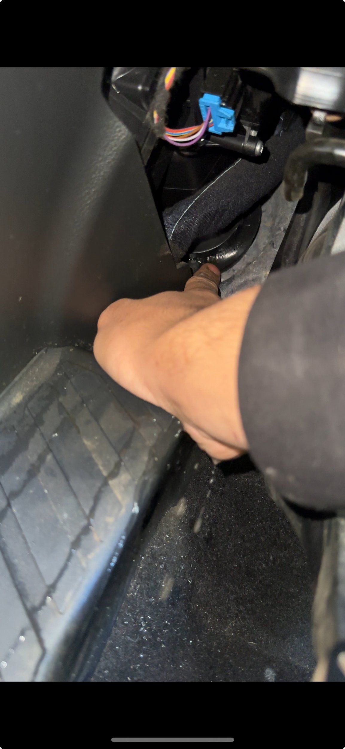

It is on the left hand side as viewed from the drivers seat. I did further diagnosing and found the leak was coming from this area near the centre console by the left clutch pedal from this foam as shown in a picture below. I took off the drivers and passenger side B pillar and saw nothing accessible. I also took off the windscreen scuttle to see the front windscreen wiper area and everything was fine there. As said it is just when the rear windscreen wiper fluid is in use.
Very strange, I'm thinking that the water is leaking somewhere on the pipework on the left and running along to the centre dash area, I would suggest removing the trim around the bonnet release handle and perhaps remove the glovebox to observe behind it.
BTW the 'B' pillar is where the top seat belt mount is, I suspect you meant the 'A' pillar?

I mean the panel between each side of the centre console. Also I will have to look taking the bonnet release area out. Just doesn't make sense how it is getting there
