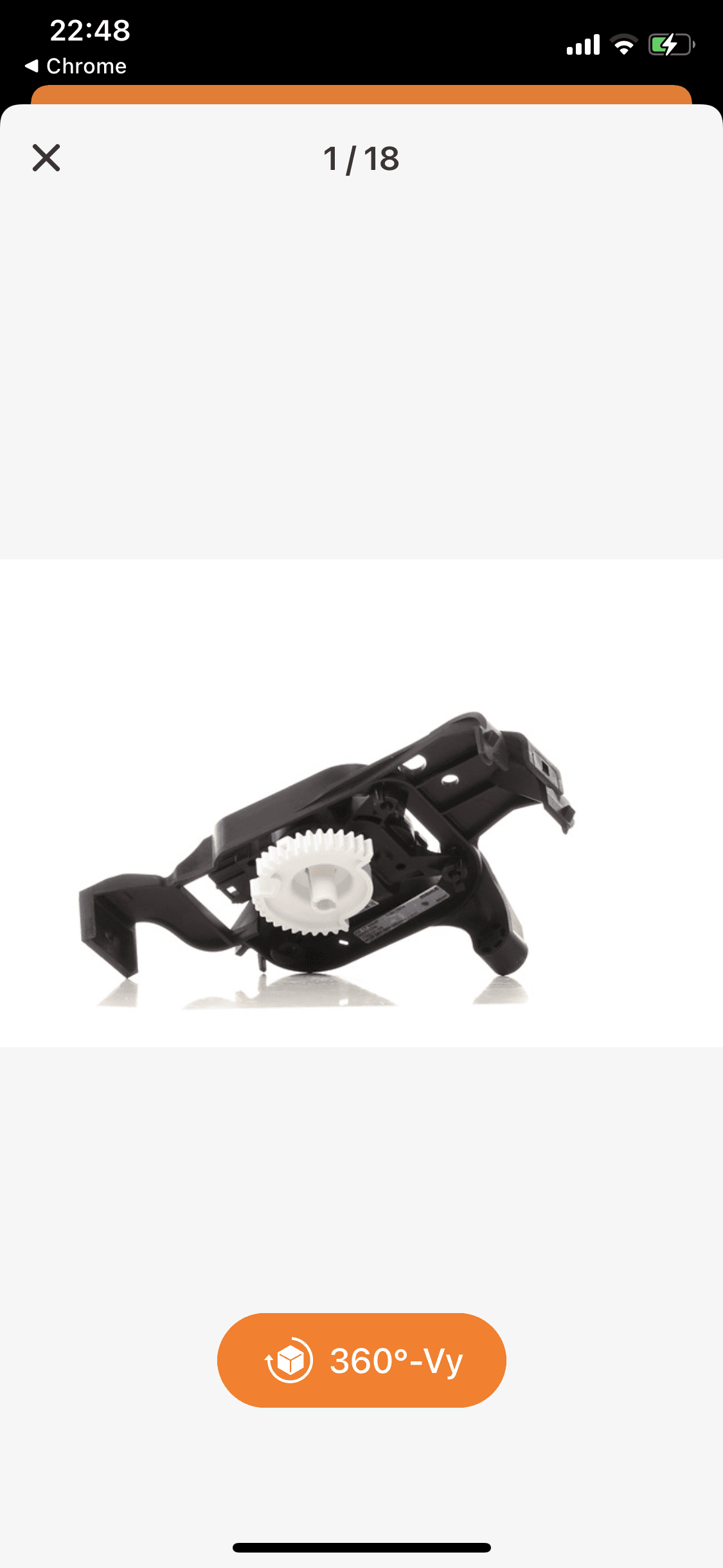

Seems to be the recirculation fan motor, did read somewherw that Vw has automatic recirculation when reversing so that exhaust doesnt enter the car via the fans inside. Turned off the AC and put on recirculation air when in idle and the same sound came from the glove box.

This was the issue, its controlls a flat plastic thingy that closes the freshair into the car.
