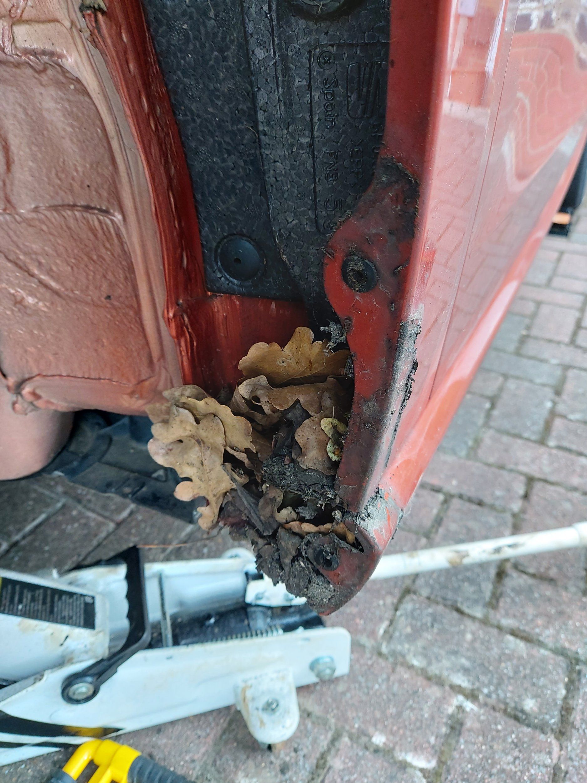

The first image shows the debris found behind the wheel arch. It's mainly decomposed leaves:

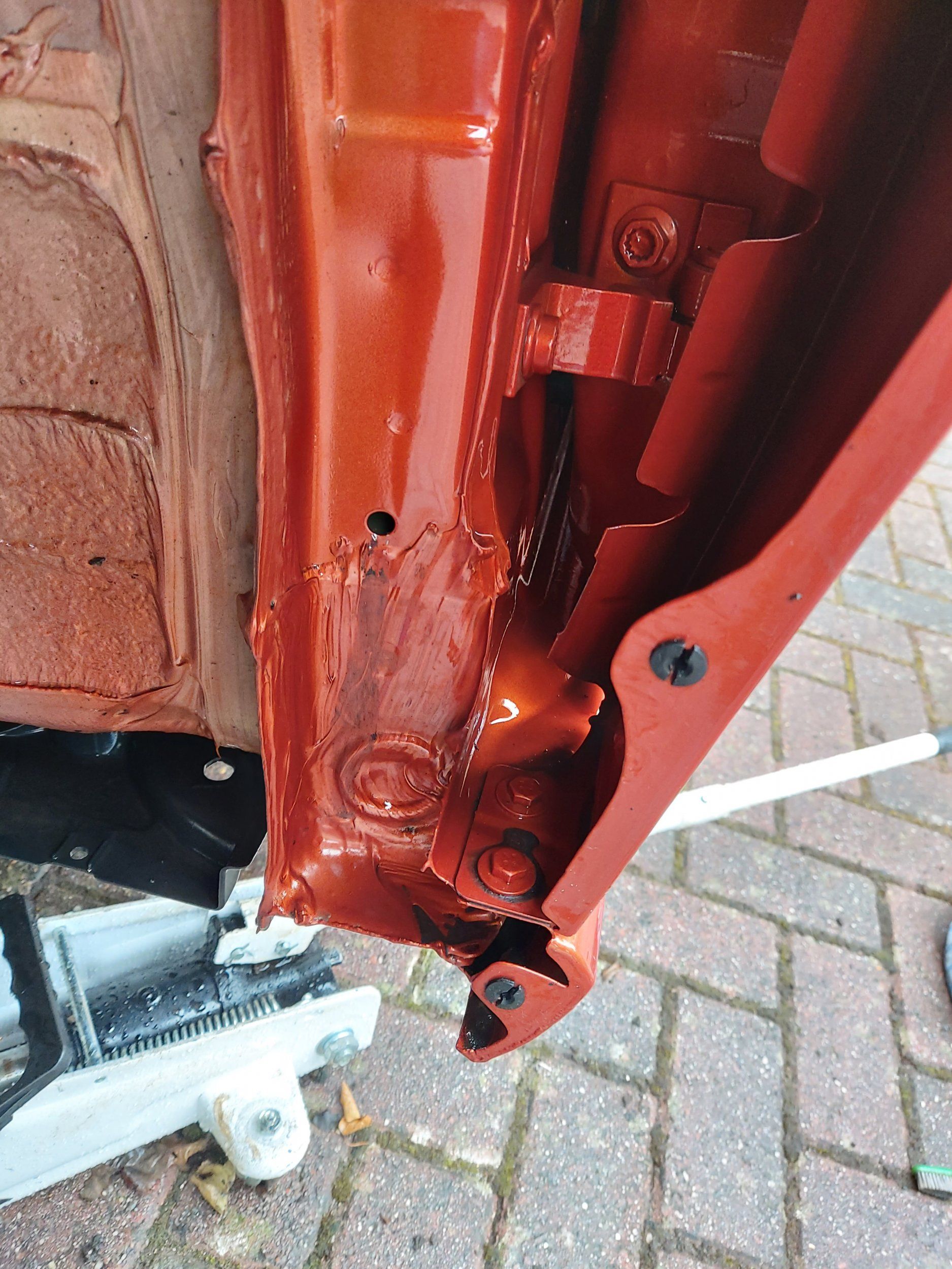

The second image shows the cleaned wheel arch. Hosepipe and brush used here:

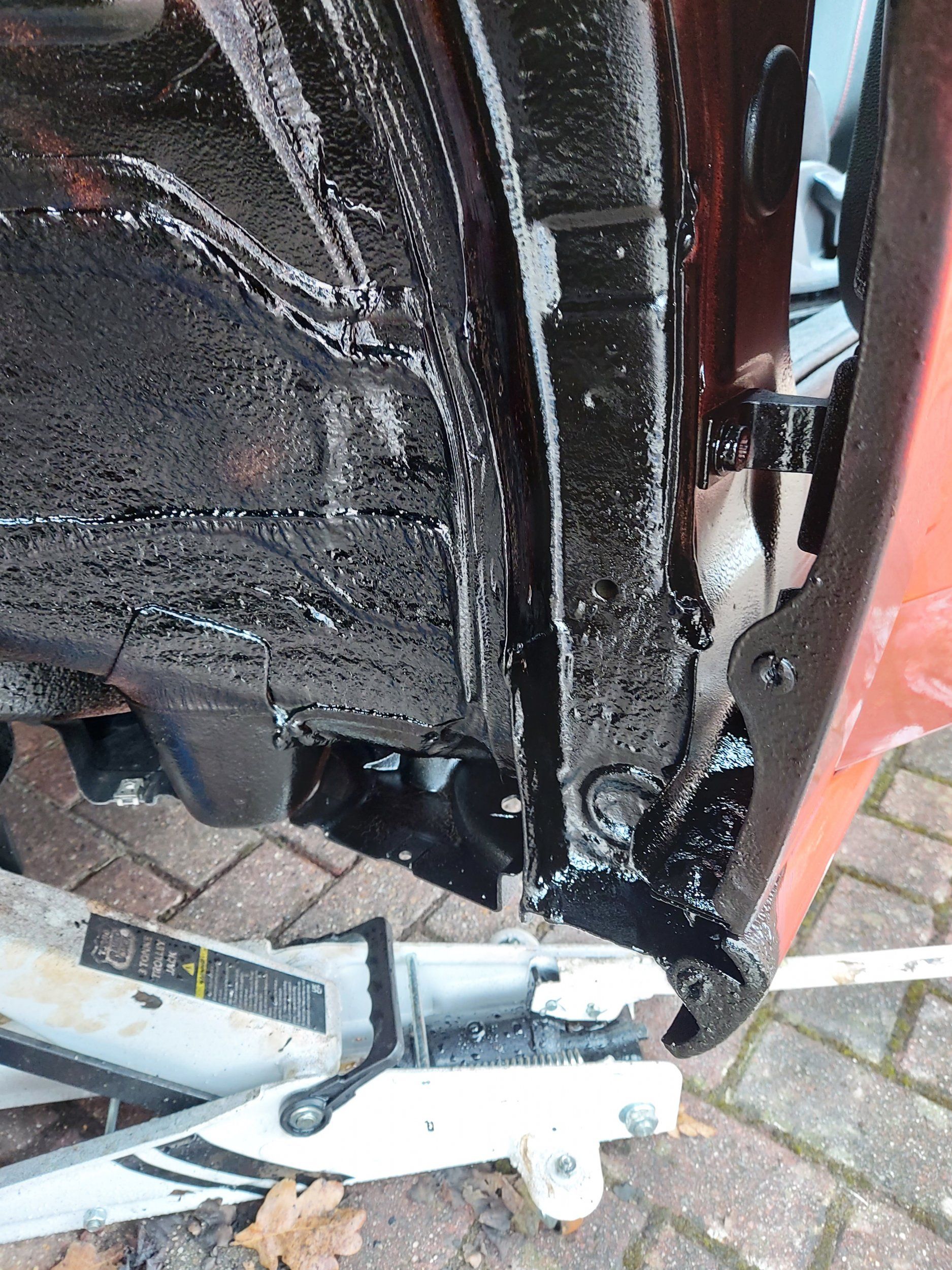

The third image shows the Hammerite/Waxoiled arch. Should be good for another 5 years:

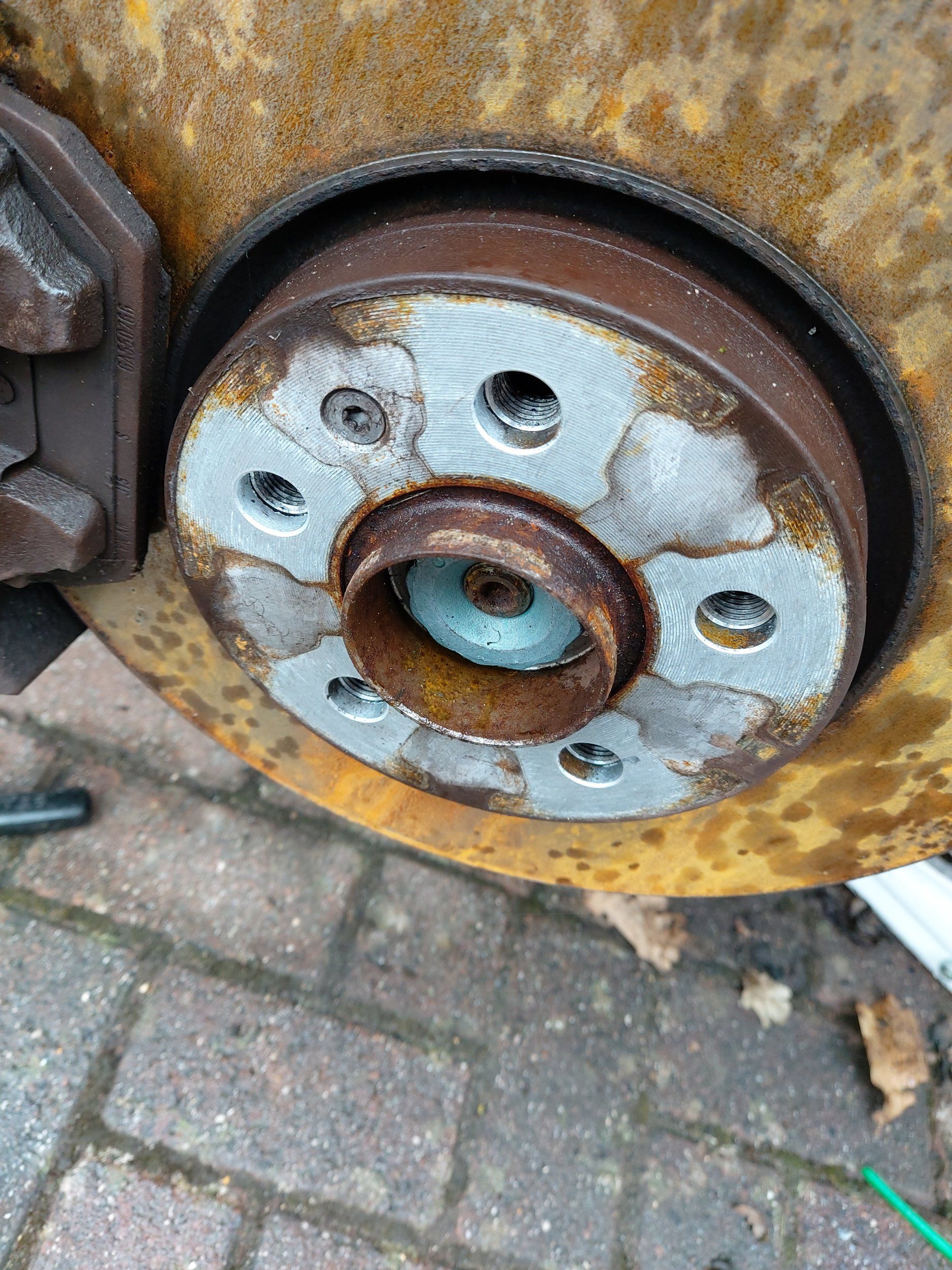

The fourth image is unrelated and shows corrosion on the wheel hub. The wheel was corroded in place and had to be removed by removing the bolts and hammering a flat screwdriver between the wheel and the hub. Some people loosen the bolts and bounce the wheel on the ground. I generously greased the hub before wheel replacement. I don't think I could have put the spare on if I had a roadside puncture. All 4 hubs are the same. There is white corrosion on the alloy wheel, I suspect galvanic corrosion.
