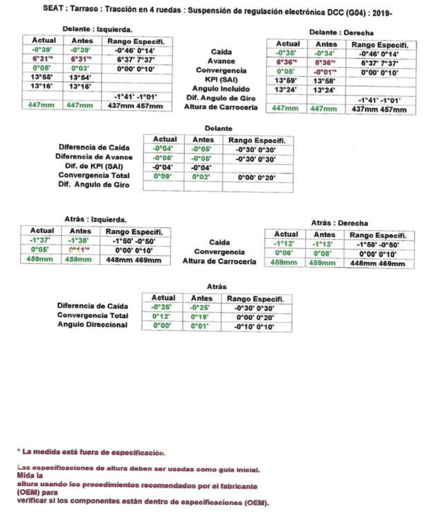

In the Spanish forum a poster shared the 4-wheel drive DCC values (see below), does anybody know whether the front wheel values are the same as the front-wheel non-DCC cars?
Reactions: Tell
Tell
You would think so surely.

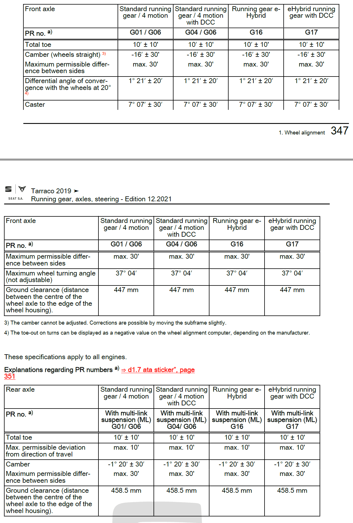

OK answering my own question again here, downloaded all the repair manuals from Erwin and life has become much much easier:
Reactions: Tell

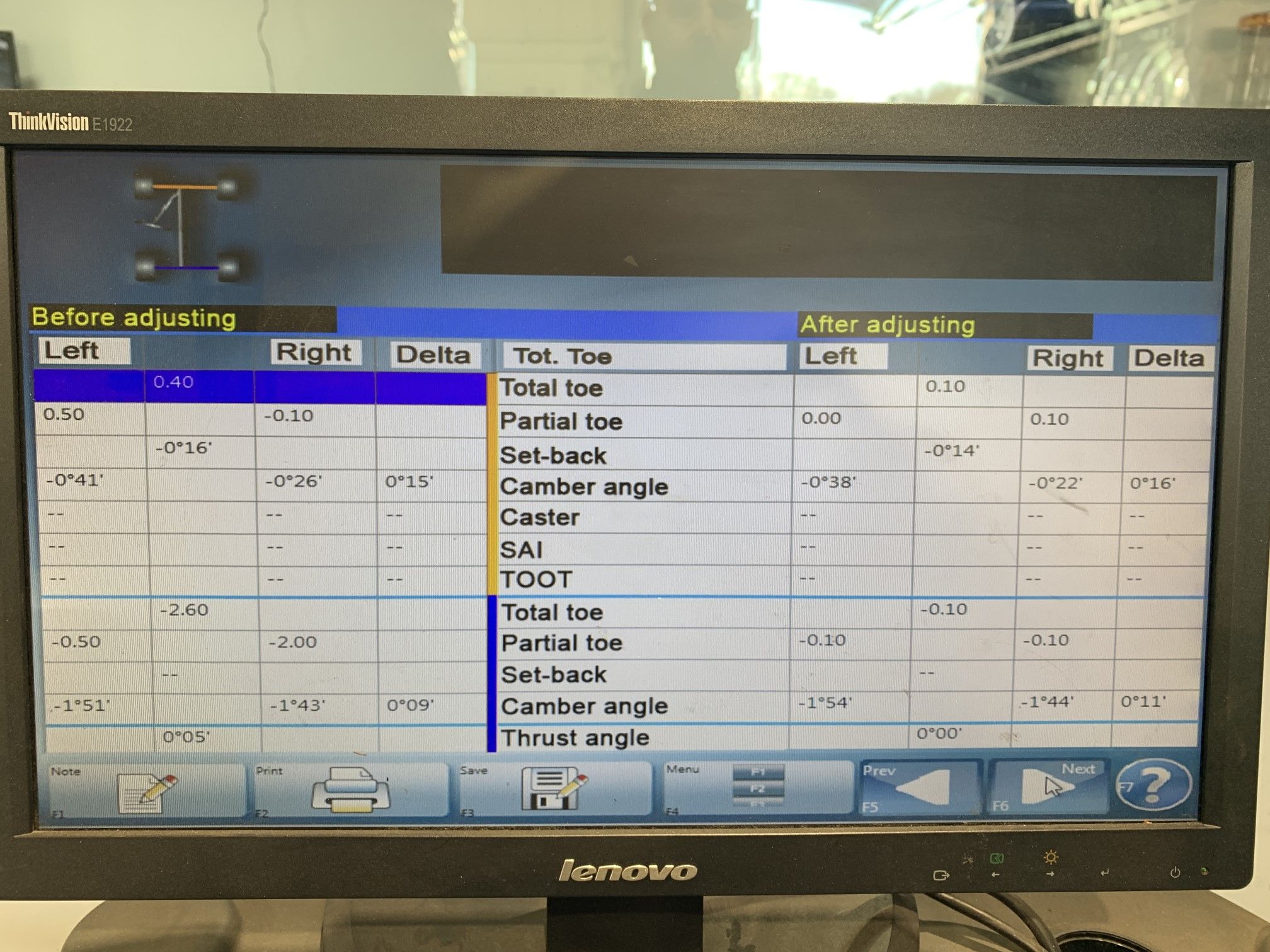

Which is all good if one has the reference values but these are sadly missing from Erwin (the assumption being that the workshop has the necessary specialist equipment). A bit of mixing and matching with my Spanish friend's report and we have the final values.
  • Tarraco Wheel Alignment Values.pdf
Reactions: Tell
t_v
Feb 19, 2021
98
78
Aaaaaaand result. Finally, as you can see with the new wheels alignment was off across the board. The rear left camber is marginally off but it is within tolerance.
Toe values are in mm so -0.1 means .1 of a mm which is essentially 0. Happy as Larry and my steering is finally dead straight.

At last. I reckon they get passed around on closed groups, so some tyre places have them others don't.
All the info (for the VAG group at least) are on the respective brand's Erwin site (costs around 9 euros for an hour's access which is plenty enough to download all the workshop manuals one needs).
The problem is that these are directed towards VAG workshops and assumptions are made re availability of tools/equipment so a bit of research to put everything together is required as in this case.
