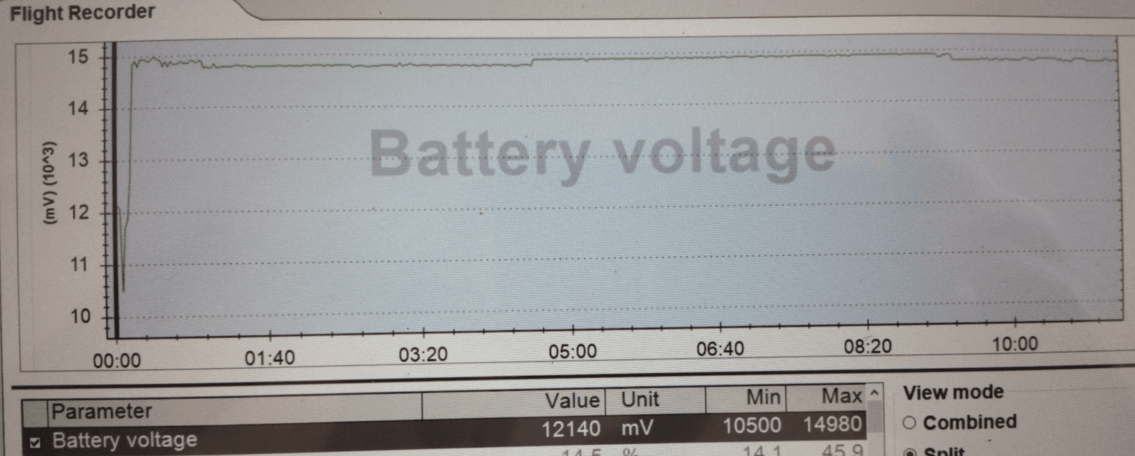

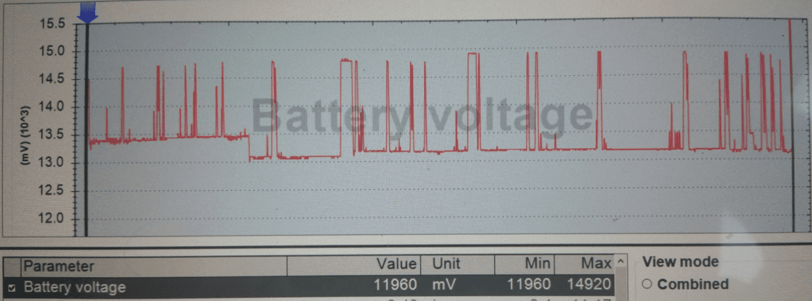

This is a log of my battery voltage on my trip to work - you can see it varies from just over 13 - to just under 15 volts! This was on my old battery.
It's not doing this to stop the battery over charging!
It's doing this to try to save a little energy (improve MPG) - all these peaks in V are when i'm braking/slowing down - so it's charging the battery for free!
The battery needs a little space for this to work - which is why you never/rarely see the SOH reach 100%
This was a later log - as my battery was near 'retirement', the 'smart' function was disabled.
