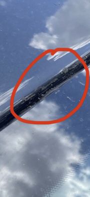

Sorry I can’t be anymore helpful. Would you mind taking a picture of the outside of that area and the roof area, I have a mate I’ll be seeing at work tonight who may have an idea (y)

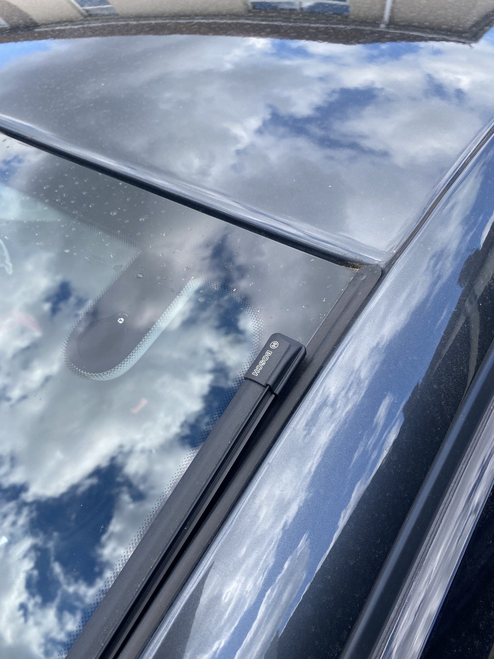

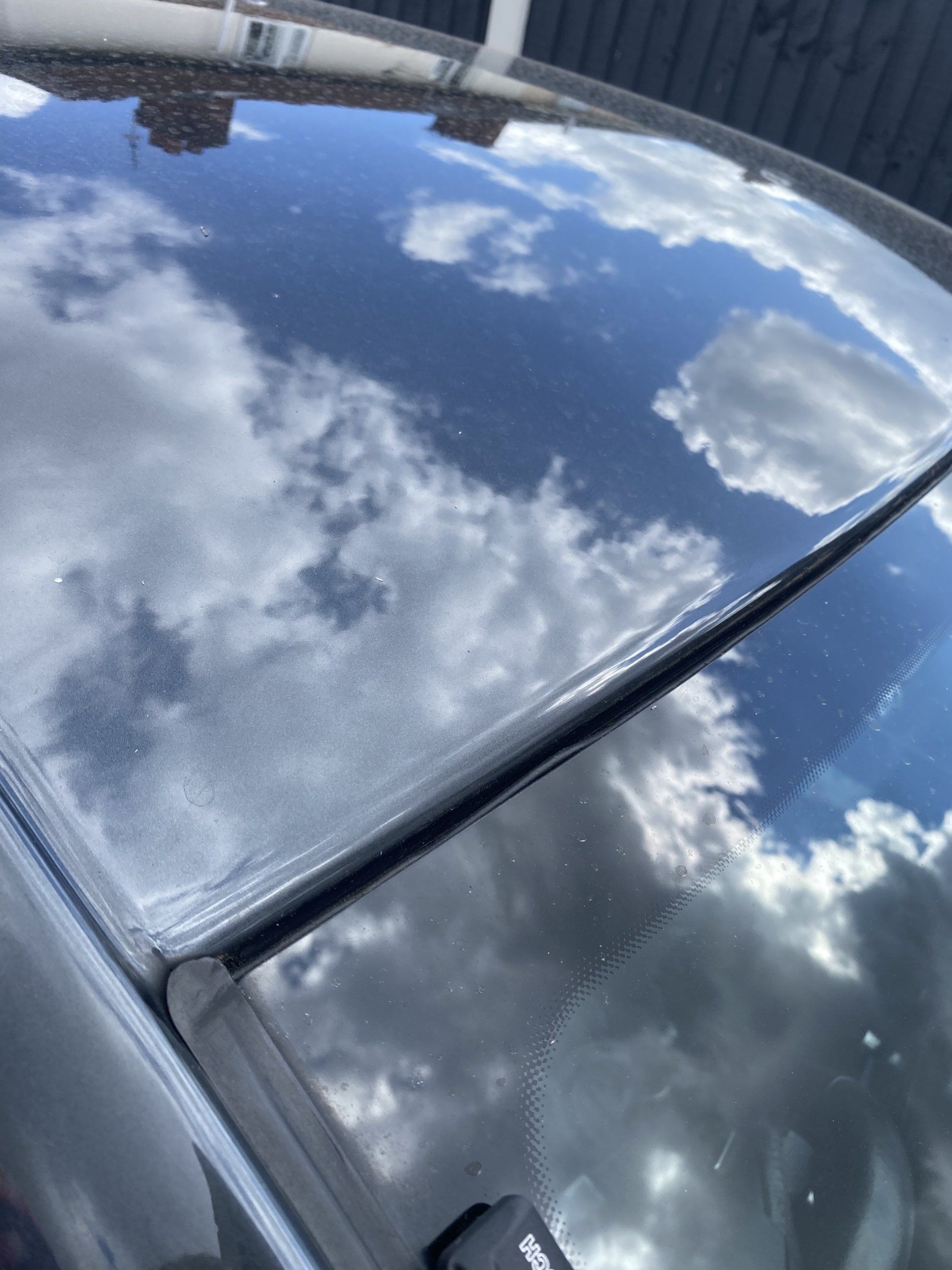

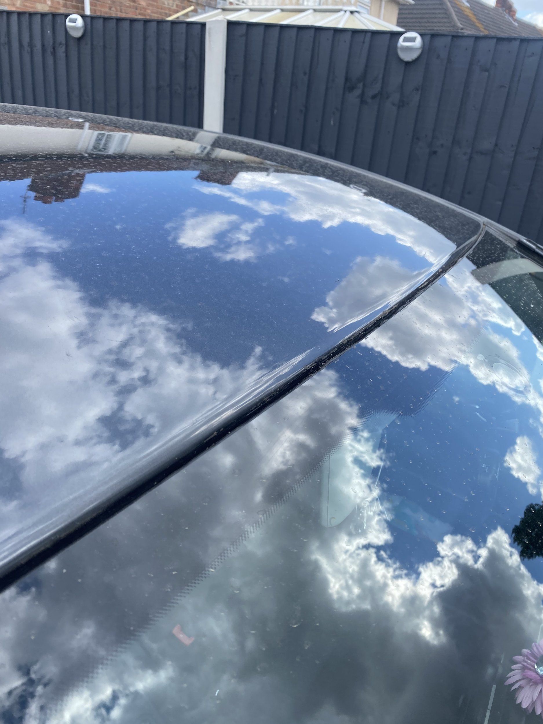

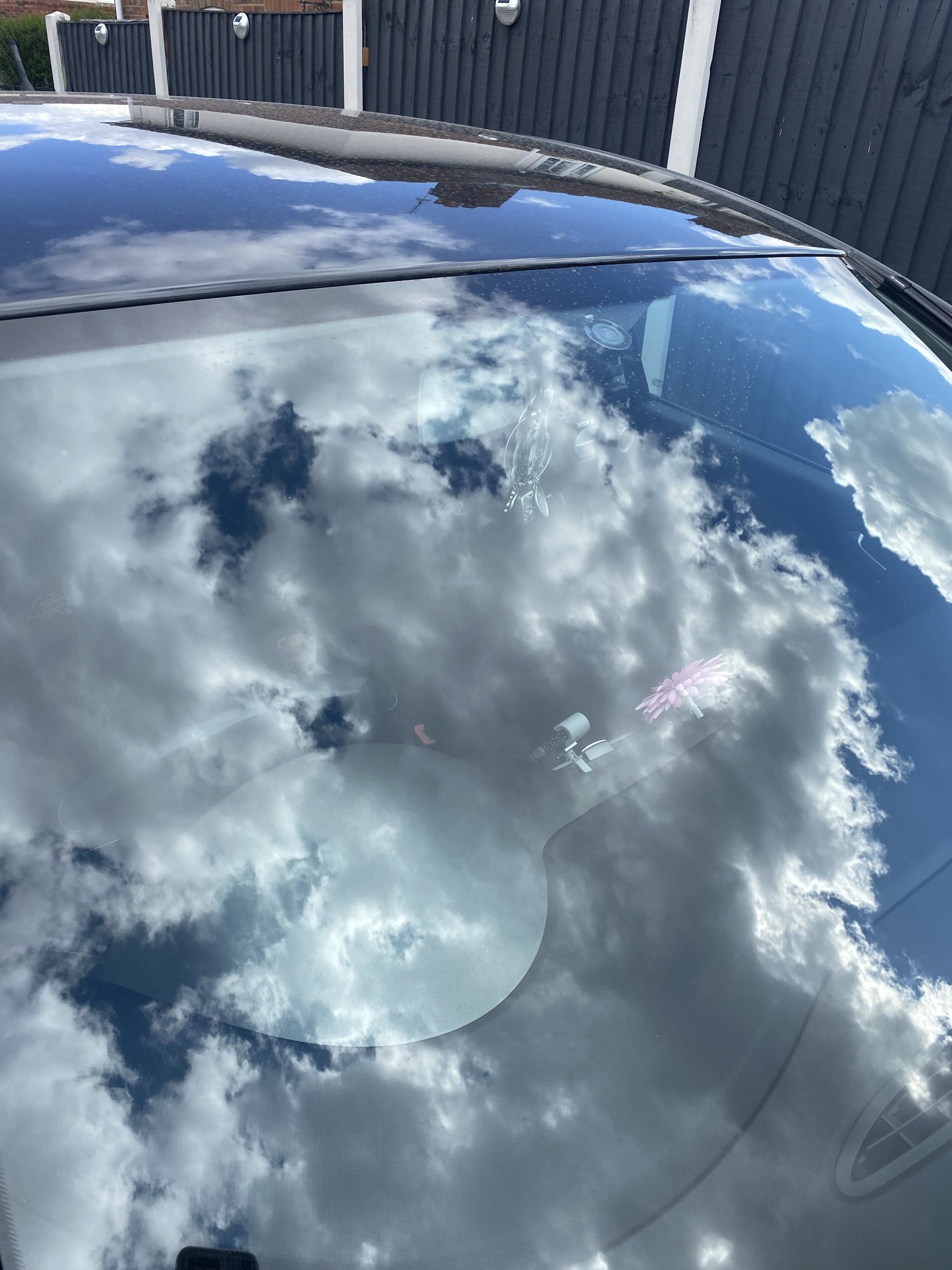

Excuse the mess of the silicone still trying to get it off paint work , haha.
thanks for helping

Sorry for the late reply (constant work). That definitely looks like an issue with the seal. It will be leaking as your driving forward and coming in and up through the seal. I would get a glass specialist to have a look. Maybe your insurance will cover screen placement !

That’s my bodge job of something in there 😂😂
not leaked since I did it but I’m going to wait for more down pours and car parked in different positions to see if it continues then I’m going to speak to windscreen folk ,
