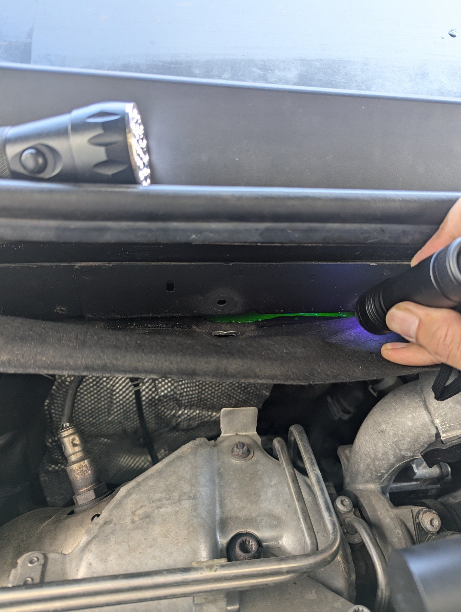

Jul 6, 2024
I've got another update. I bought some water dye and poured around 30l over my car. A few minutes later still no water was visible. Later it rained and I was lucky. Some bright green water was dripping inside :)
In the attached pictureI highlighted the area where I could see the water dripping from. Unfortunately I have no idea what is behind and what this could mean. I also do not have any of the repair manuals as they are not online anymore. Any help here is very appreciated!

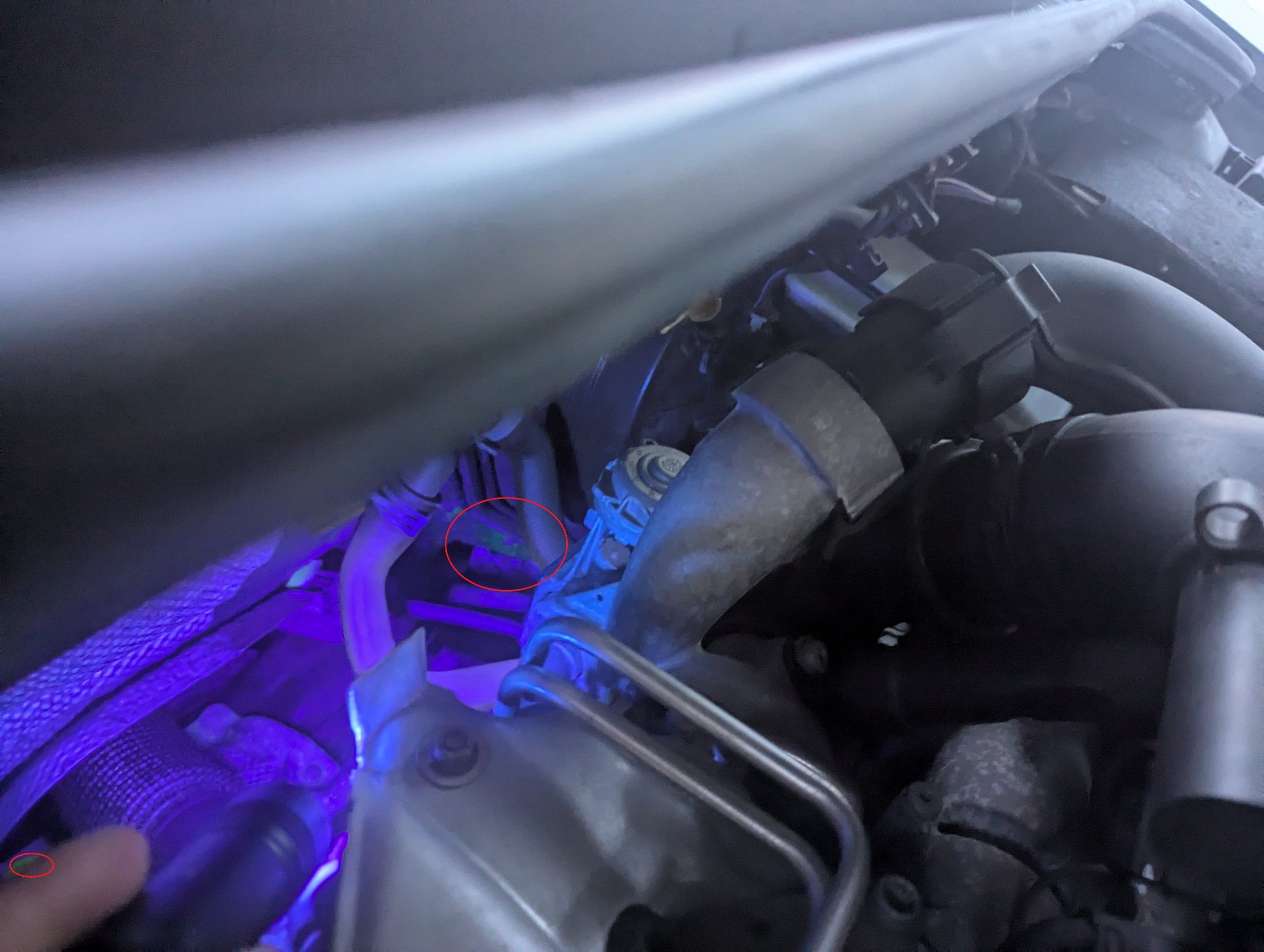

Now, a few minutes later I also have a picture of the engine area. I dont know if this does make any sense but maybe it helps. Besides a small drop where my finger is I found a larger area which should also be relatively near the ingress point. Any idea what that is?

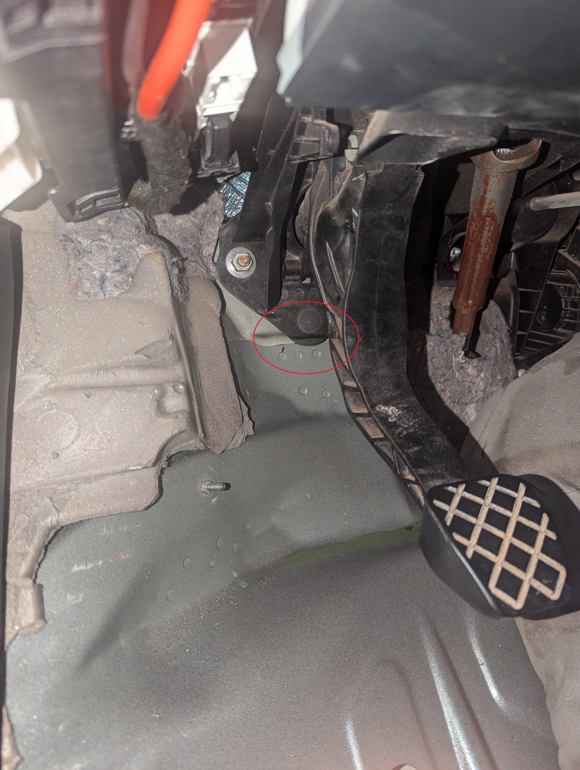

Jul 6, 2024
One more update. Unfortunately I cant edit my last post anymore...
I was curios where the water is coming from. The green area is dyed water that soaked some kind of cloth like material.
But there is no visible trace. So I thought the water must be coming from inside at this point. I dissasembled this material a bit a the top.
You can see the result in my new picture. From this point on I guess my best bet is the windshield?
