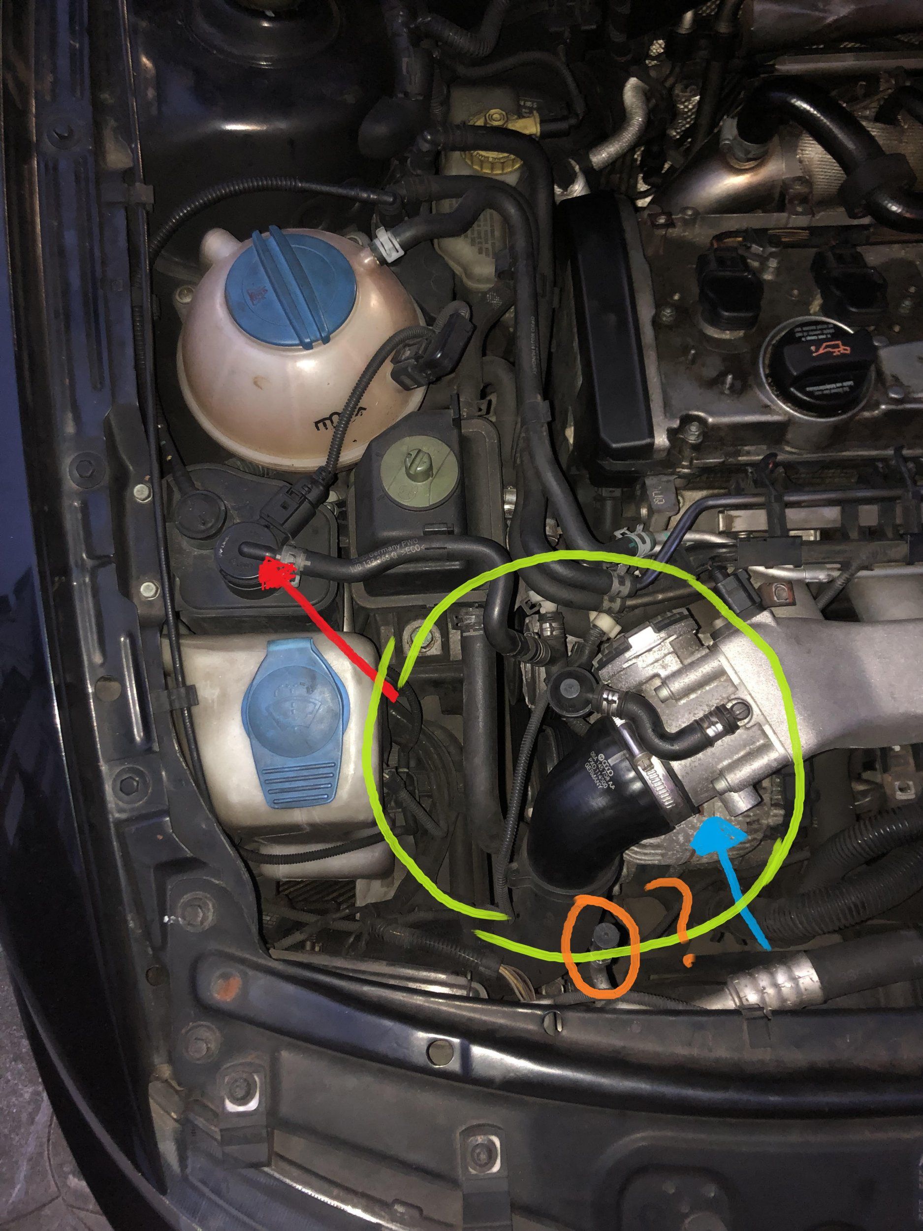

So I reset the ECU just now, CEL is gone, got two ABS lights still but mechanic mentioned damage to driver side ABS sensor when doing wheel bearings so I assume it's that.
Engine is actually running now. I let it idle for a few minutes then press the accelerator a bit and there seemed to be a lot of what I can only describe as "chatter" as I held RPMs at 2k. Is this normal after an ECU reset as it's relearning?
Something else I noticed during idle is that I can feel some air coming from between where the alternator sits and the throttle body. I thought it might be the belt motion moving the air but it doesn't feel like that anywhere else.
I've labelled a [picture I'll post below, my questions are;
Red arrow: Is that the N80 Valve?
Orange circle: What is this?
Green circle is where I can smell petrol and hear some kind of hissing, again not sure if it's the belt or something else making that noise.
Underneath the throttle body where the blue arrow points is where I can feel a consistent pushing of air.
Again thank you so much for your help and advice, I really really appreciate it, and sorry to be asking so many questions - for whatever reason I want to understand this engine and how it works. Anyway, here is the picture;

Orange circle is where you would top up your air con refridgerant
Blue arrow thats the intercooler pipework meeting up to the throttle body. It should not be leaking any air. If leaking you are losing boost from turbo

Yep Red arrow is the N80

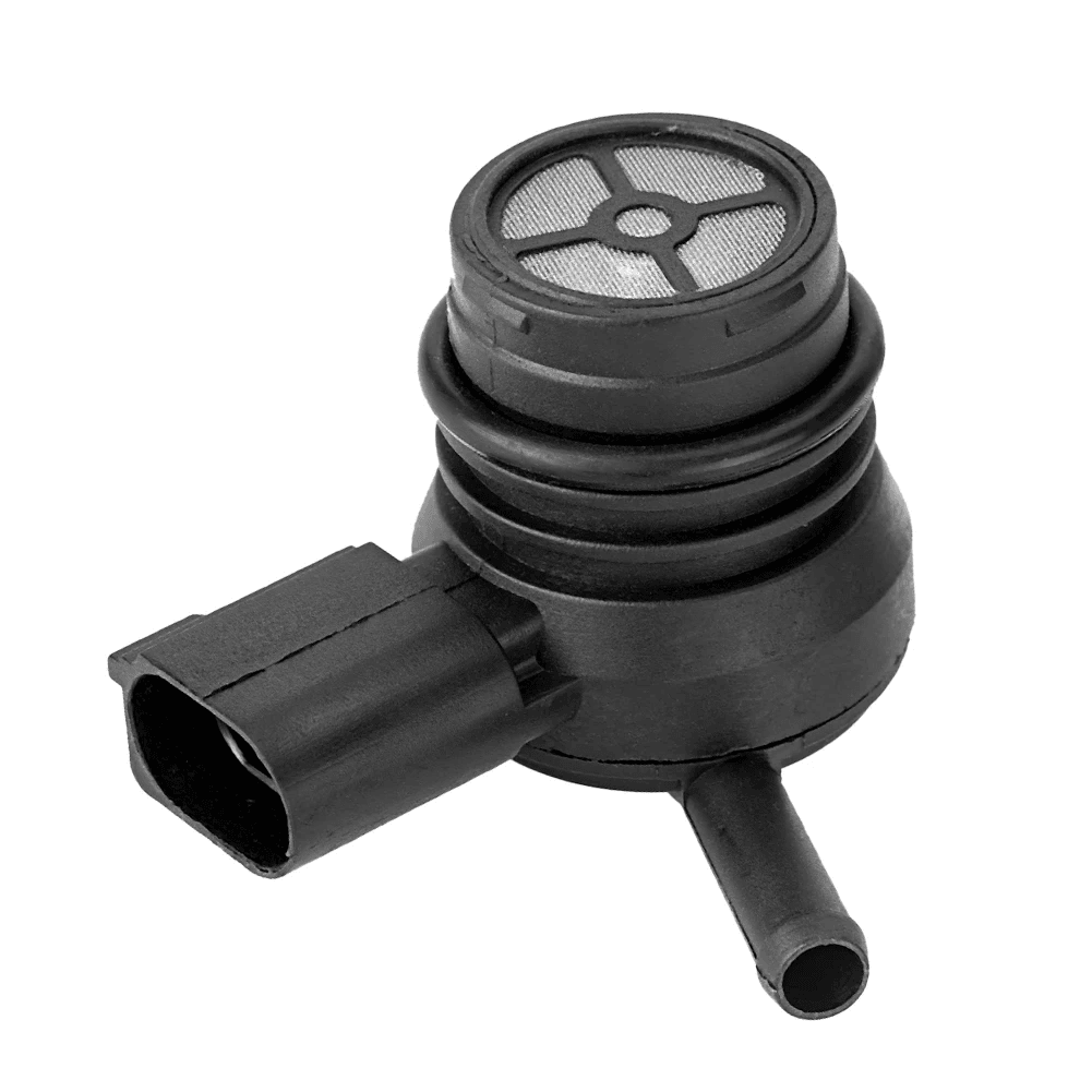

Hey so I've been able to get the N80 off to take a look, and was going to blow through it was suggested to see if it was stuck open.
All the videos I've watched are for N80's that look something like this:
Mine however, assuming because it's literally stuck into the charcoal canister, looks like this:
WTF? 😂
I get that it's doing the same thing but now my diagnostics are a little uncertain. I tried blowing air through and I couldn't, I also tapped it out on the ground to see if any bits of charcoal came out, none. Am I right in assuming this valve is not part of my problem?
