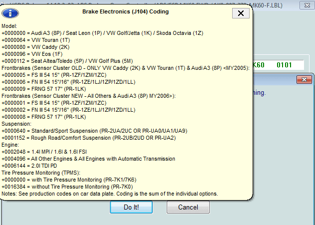

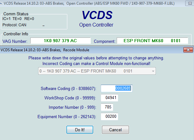

Hi, I'm trying to enable a hill hold control on my dad's car and I can't apply any coding to the ABS module on the VCDS:
Code:
Address 03: ABS Brakes        Labels: 1K0-907-379-MK60-F.lbl
   Part No SW: 1K0 907 379 AC    HW: 1K0 907 379 AC
   Component: ESP FRONT MK60      0101
   Revision: 00H11001
   Coding: 0002689
   Shop #: WSC 04941 785 00200
   VCID: 73E3A90B127A1EB963D-8026
No fault code found.
On the coding screen I see only:
The "Long Coding" button is missing and I don't know how to reach it. It's a SEAT Leon Mk2 (2008) 1.4 MPI version.
Can anyone help please?
