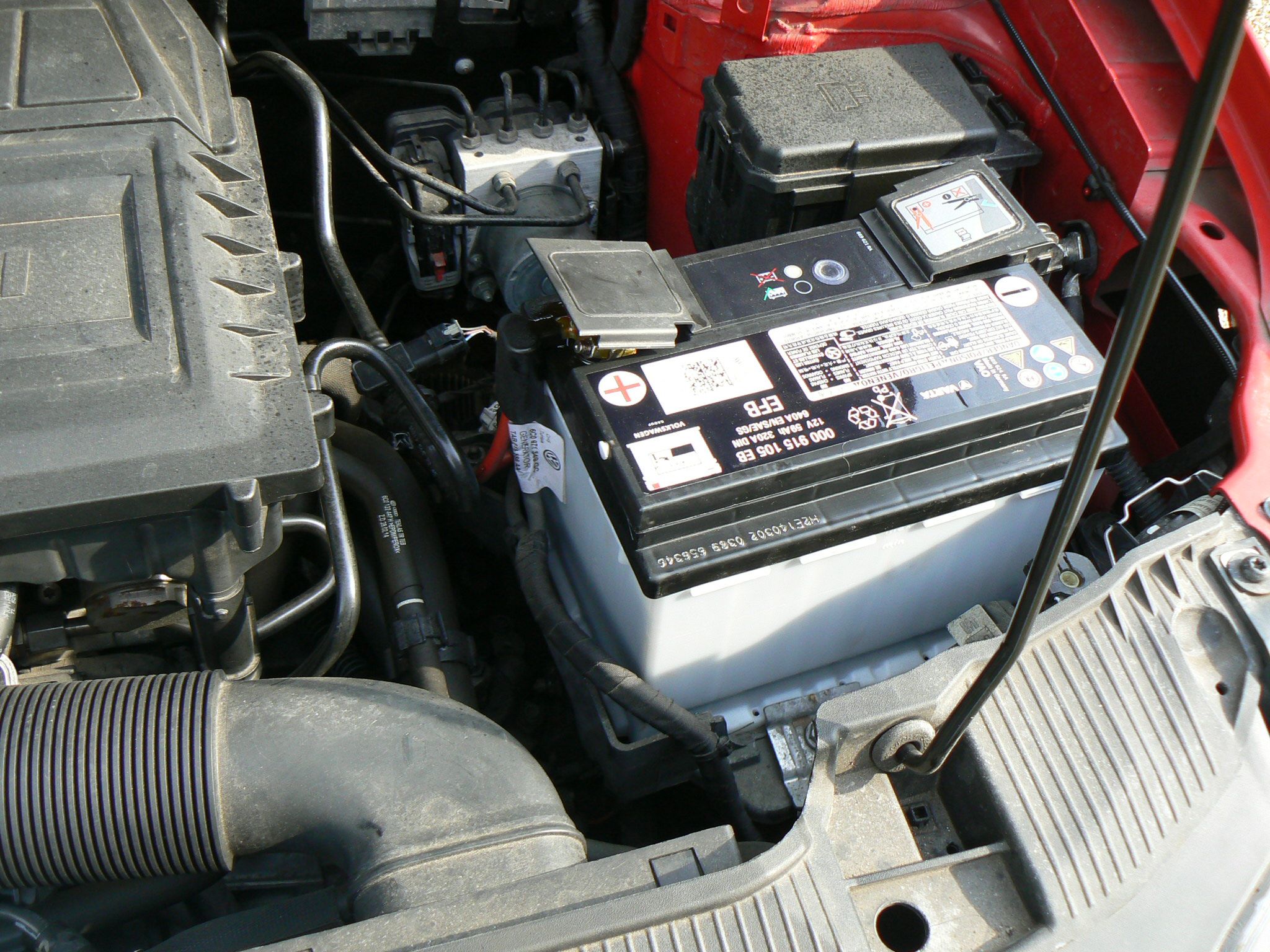

I've just had the battery replaced by the Seat dealer down here in north Devon - I'm a long way from home just now - They responded quickly to my request for a new battery and I found them very helpful and pleasant and I can thoroughly recommend them - Croyde Motors: https://www.croydemotors.co.uk/ - definitely good people if you're in trouble here in North Devon. It's a small setup with much more of the feel of a "family run" garage. I've just been having a quick look over the installation and it all looks very neat with the casing clamp nicely installed (ie. not squint as it was from the original factory fitting!) also terminal clamps correctly installed and treated to a dose if gel - looks like Holts Nocorode if anyone knows that stuff, however I've just noticed that there is a small white plug in the end of the top strip of the battery. If you look at the other end of the battery there is a small hole which I'd guess had an identical plug in it at some time. My assumption is that they are vent plugs to stop electrolyte leaking in transit? My guess is that, if they are indeed there to block the vents during transport, both should have been removed when the battery was installed in the car but for some reason only one was removed. However maybe only one needs to be removed? I just don't know. Of course maybe it's not a vent plug at all, but I can't imagine what else it could be. Anyone able to offer advice? I will be ringing the garage tomorrow just to check if i should do anything about this.

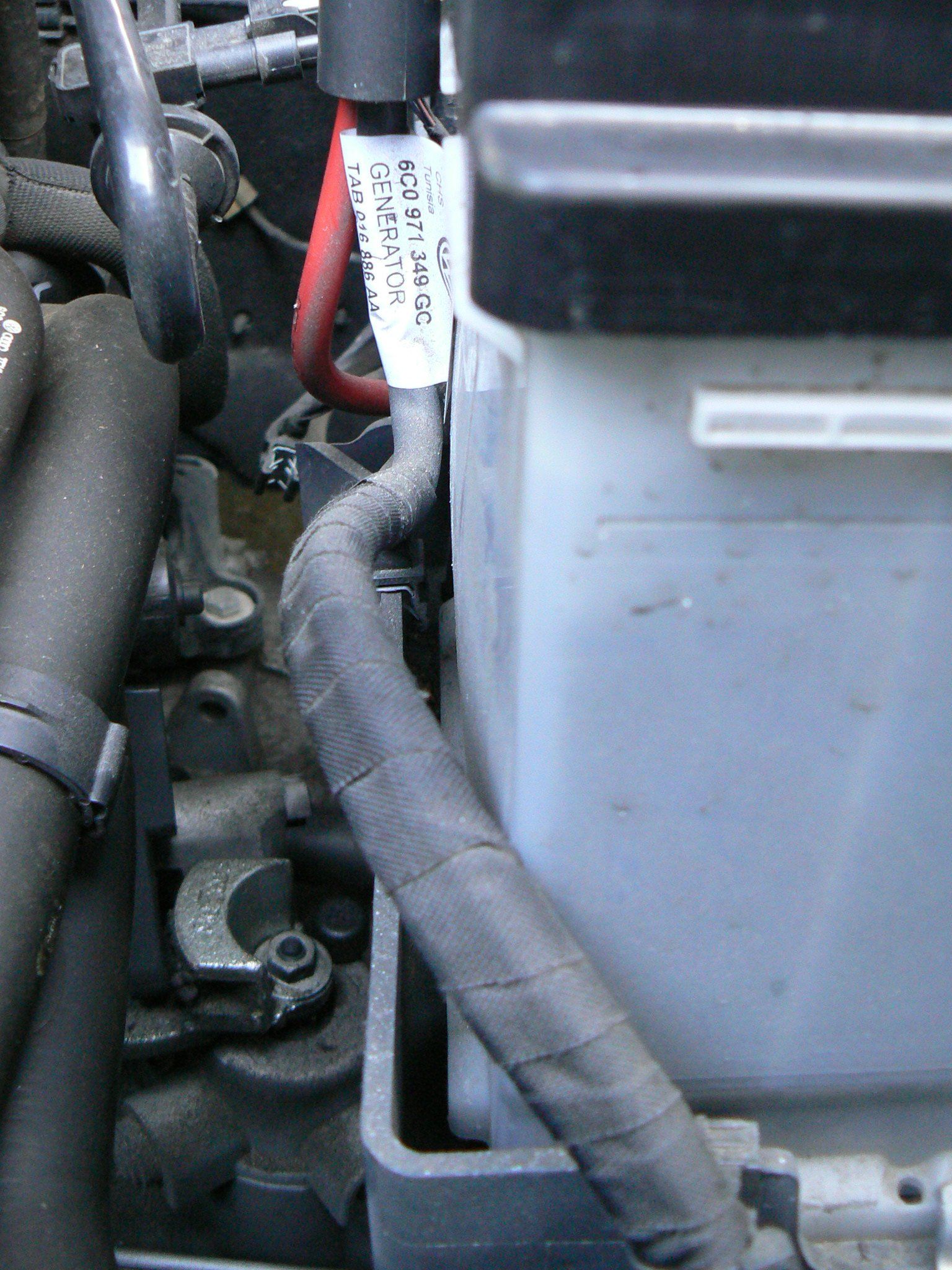

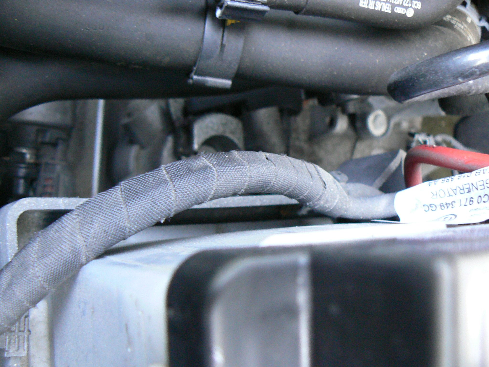

I'll try to attach pictures showing the little white plug in the left side of the top of the battery and the hole in the right side - that is looking at the front of the engine bay from in front of the car.
Oh, by the way, RUM and Super V8. I said I'd post pictures of the bulge in the end of the old battery due, I'd assume, to sulfation causing the plates to swell:
We were talking about thermal blankets too RUM. So here's the Ibiza installation, in all it's "naked" glory - not a blanket in sight!
Nice to see they swapped the terminal protector flaps over to the new battery too. I would expect this to be done but wouldn't have been particularly surprised to have had to ask.

Excellent stuff, I always find that dealerships anyway, tend to "open" these covers up when they need access to the battery posts - I prefer to lift them off!
Bulge, yes, not good, I can see it okay.
Plugs on batteries, I've always wondered about that as my new Bosch batteries do not have any instruction concerning them, I've forgotten if Bosch actually do fit plugs or leave the installer to poke something in to break open the appropriate vent.
Also, I've wondered if it really depends on which side it is convenient to vent it from in terms of how/where that battery is installed, also some cars including VAG ones, sometimes have a right angled fitting and flexible tube to carry away gases/liquid, I still have not found out what happens with my wife's Polo, but I can check up on that, my 2011 S4 has its battery in the boot, so has a vent tube exiting the boot floor.
This is just another of these maybe to some small things that you wish that you had taken into consideration prior to getting a battery changed, luckily for me, I can avoid that by examining both the old and new batteries side by side as this issue had already reared its heads in my "what if" section of my brain!

Okay, on the original Exide VAG EFB in my wife's 2015 VW Polo, there is a "hint" of a vent hole at both ends of the casing, the side nearest the engine has the potential vent point unbroken, and the the side towards the wing has the hole broken open, or "picked off". Obviously Varta's version of this is a plug which is either left where it is now, which makes sense as these batteries of that P/N will maybe always get fitted in that "way" which means that the other vent point is by default left open. I looked at the new Bosch batteries, and both vent points are "open", but the storage/transit covers that protect the battery posts have a single "break off" plug that looks like it should be broken off and fitted into the vent that is not to allowed to vent - if that makes any sense.
So, I'm coming from maybe a point of over thinking this, as maybe you are too - better to be safe than sorry though, and initially considering that both vent points on new Bosch batteries were sealed from the factory, and when the battery is put into use, the fitter simply pokes something into one side to "open it up" and if required fit a vent tube - when in reality, all these batteries will come from the supplier with both vents opened and a vent plug provided to close off the one that is not required, or maybe even as I suggested earlier, your battery having a small range of fitments into VAG cars, it possibly came with the vent plug already in the correct side.
Yes RUM, I notice that mine now look like "half cocked" wings. Previous to this they lay flat over the terminals, probably because, like you I prefer to just pull them off if I require access. I wonder if they would respond to being removed and then reverse bent, kind of "over centre" if you know what I mean, so they end up flat again - knowing my luck they'll probably crack along the fold line and I'll end up standing there thinking "B****r, wish I hadn't tried that"!
I think I've been very lucky not to have been stranded somewhere - bet it would have been a time limited car park knowing my luck - with a non starter. The old battery's voltage had been steadily dropping each day after standing for a couple of hours to let the surface charge on the plates dissipate after being on the CTEK. The reading on the last morning, taken just before I set off for the garage was flickering between 11.9 and 12 volts on my multimeter. If I hadn't had her on the CTEK every day I think I'd have had a "fail to start" probably last weekend.
Although I'd thought she cranked over pretty well with the old battery, she now cranks like she's been on a course of steroids and fires up almost instantaneously - a very noticeable improvement. I had quite a chat with the chap at Croyde and said what a bore it is to have to do this coding procedure. I mentioned I have VAG-COM (VCDS) and that there is a lot of conversation about how you can initialize non BEM coded batteries by changing the serial number of the battery in adaptions. He seemed quite aware of this and said, as I expected him to, that they've come across people who have tried this (or had a battery fitted by a non VAG garage who tried to do it) but were unsuccessful and had had to come to them to get the mess sorted out. - Which presumably would mean a new BEM coded VAG battery having to be purchased? - I've mentioned before that one of the owners of AVW is married to a very good friend's daughter and in fact lives not half a mile away from us. Of late, with Paul now in charge of their reception, it's not so common to find workshop people in the reception area so less easy to ask a technical question of someone "in the know" when you walk in - but much more time productive for them I'm sure, so I'm not "knocking" them. Very few workshops encourage customer contact with their mechanics. I'm just a little too reluctant to actually go round and knock on his front door, but I might ask our friend if he would ask the chap whether he would mind having a conversation with me about using VAG-COM to do this. I'm sure he would know definitively whether it's possible or even advisable to attempt this. If I ever get to speak to him about it I'll let you know the outcome - maybe via a PM as I wouldn't want to cause him embarrassment by posting in an open thread.
Forgot to mention by the way, that they - the garage in Croyde - seem also to have done a quick "health check" and check for any outstanding software updates while she was there FOC. They detailed that the check had been done and all systems found to be up to date on my reciept. As I'm now doing my own servicing she hasn't been checked for this sort of thing since her last dealer service when her warranty ran out some 3 years ago, so that's been a very welcome wee bonus!

Okay, on the original Exide VAG EFB in my wife's 2015 VW Polo, there is a "hint" of a vent hole at both ends of the casing, the side nearest the engine has the potential vent point unbroken, and the the side towards the wing has the hole broken open, or "picked off". Obviously Varta's version of this is a plug which is either left where it is now, which makes sense as these batteries of that P/N will maybe always get fitted in that "way" which means that the other vent point is by default left open. I looked at the new Bosch batteries, and both vent points are "open", by the storage/transit covers that protect the battery posts have a single "break off" plug that looks like it should be broken off and fitted into the vent that is not to allowed to vent - if that makes any sense.
Thanks RUM. I actually emailed Chris, the chap at the garage, last night but have not yet had a reply. It's now just after 11.30 am and, as their workshop will probably be closed tomorrow and we are intending to set of home first thing Sunday, I'm just going to make a small "nuisance" of myself and give him a quick ring right now - I'll be back on here very shortly to let you know the outcome.

Oh, there you go. Chris - from the garage - just rang. Yes that wee white plug is a vent plug, and yes the one facing the engine should remain installed in it's hole with the one facing the wing being removed - exactly as they have done. The thinking is that any gasses (hydrogen and oxygen of course) will be vented not towards the hot engine parts but towards the relatively cool inner wing thus reducing any possible fire/explosion risk. All very logical when you think about it. I must say again what a nice chap he is to deal with. I apologised for using up his time with such a mundane query but he assured me it was no waste of his time if it meant I was happy with their service. I continue to be most pleasantly impressed with this dealer.

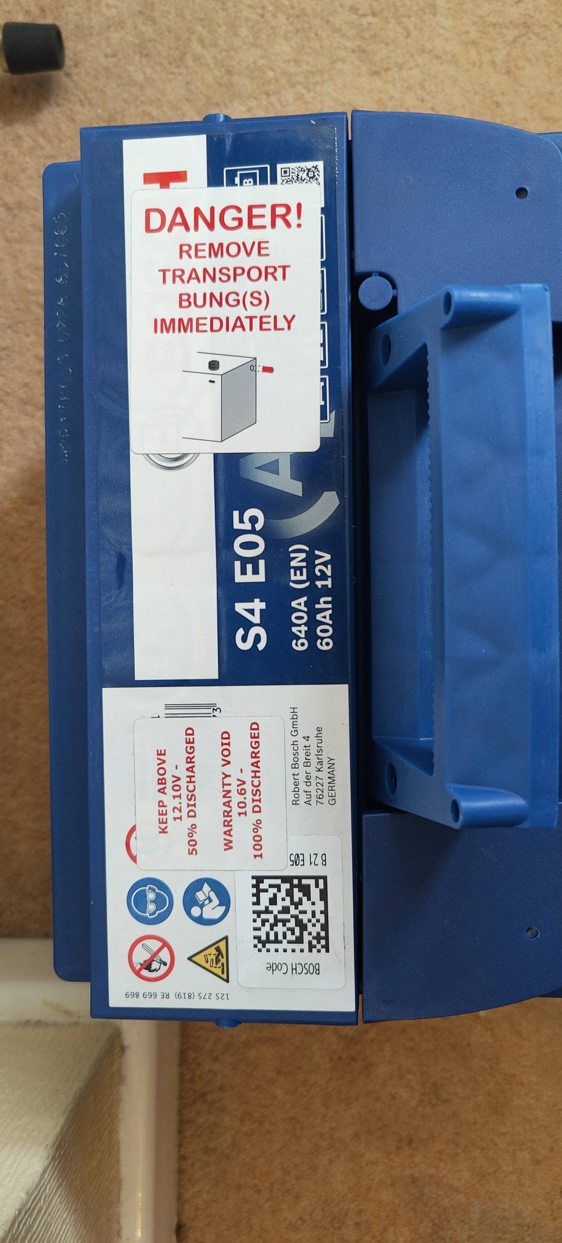

I've just ordered and received a new Bosch EFB battery for my 2014 Toledo, and the warning on the case is pretty clear - see the photo attached. I've removed the bungs - they were red.
That is handy, but a bit strange as my new Bosch AGM for the 2015 Polo 1.2TSI, bought in December 2021 has nothing like that on it. That battery you have might have 2 transport plug fitted, but it still has another one as part of the +VE post protective cover.
I would have thought that fitting transport plugs to a battery is a bit risky unless you could 100% control the temperature - unless your seller fits their own plugs and that label, which would explain why my 2 new Bosch AGM batteries and all previous new Bosch batteries came with open vents.
By the wording of your posting, I'm guessing that that battery was delivered by courier and not collected at a shop/store.
Edit:- I'd think that I'm being spot on there, both these extra labels are not Bosch's, added by seller.
