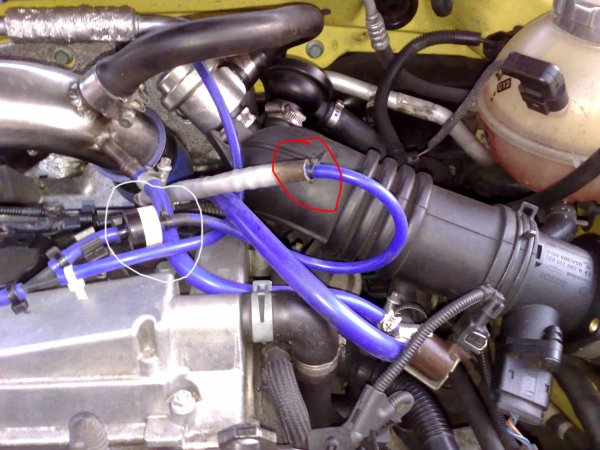

had a look tonight found the pipe circled rd disconnected so i re connected it to the part circled white
will this be the problem?
