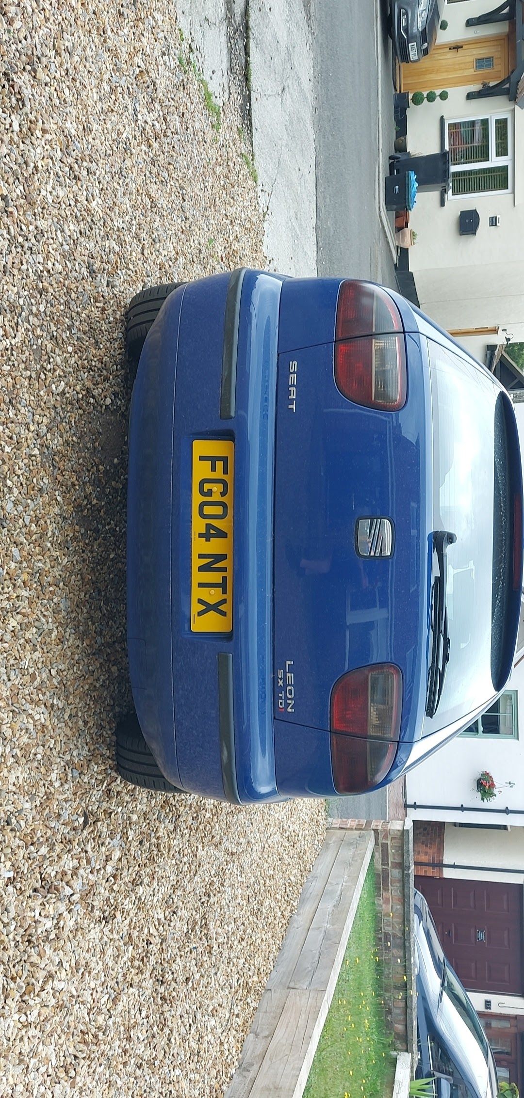

Hello everyone hope you're all well , I've recently had my car re Remapped as wasn't happy with the original results currently running 160bhp and 340nm with a gutted cat to a 2.25 back box delete pipe, EGR Delete (mapped out) and heat shielded induction kit.
I'm going to be purchasing a darkside SMIC kit and fit on the drive will I need to map it in before being able to drive , and would I even see much gain without upgrading injectors or nozzles.
