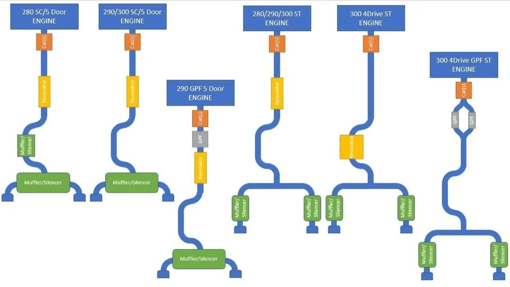

The pre face lift 290 and facelift 300 have one less silencer as standard than the 280 - and no gpf like the facelift 290

Thinking about it now I may have to go with the 290. Even though it has the GPF filter in and it wont have the sound that the 300 has I feel like it will be the better daily driver, I've been looking around at specs and options for the car and the 290 Lux seems to be a solid option. Again even with the GPF being there I've seem a few that have had a resonator delete done to them and they don't sound too bad, not quite the 300. Just feel like I need to meet in the middle of having a decent sounding car and good mileage for day to day driving.
