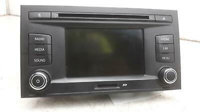

I have the basic radio installed from factory right now:
However I purchased a MIB2 and the 6,5" screen.

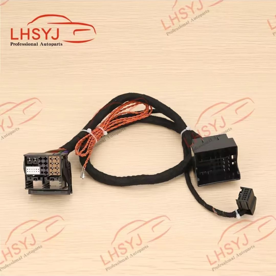

I have the part number for the new glovebox I require to fit the MIB unit, however I am unsure if I need a new cable, since I need the one going into my current radio and into the glovebox.
If so, is it some kind of extension loom or is the current cable loom long enough to be routed down to the glovebox compartment? :D

MIB1 5" to MIB2 6,5" you will need:
MIB2 unit (with the SD nav card )+ display unit
extension cable set
new rev usb port + cable
GPS aeral
DAB areal (if there is DAB in you area )
Component Protection removal and coding to your car
I didn't change my glovebox, just cut the back.
Seat Soud and rear camera are extra ;)
