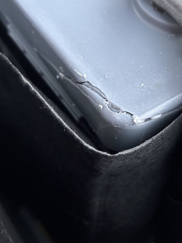

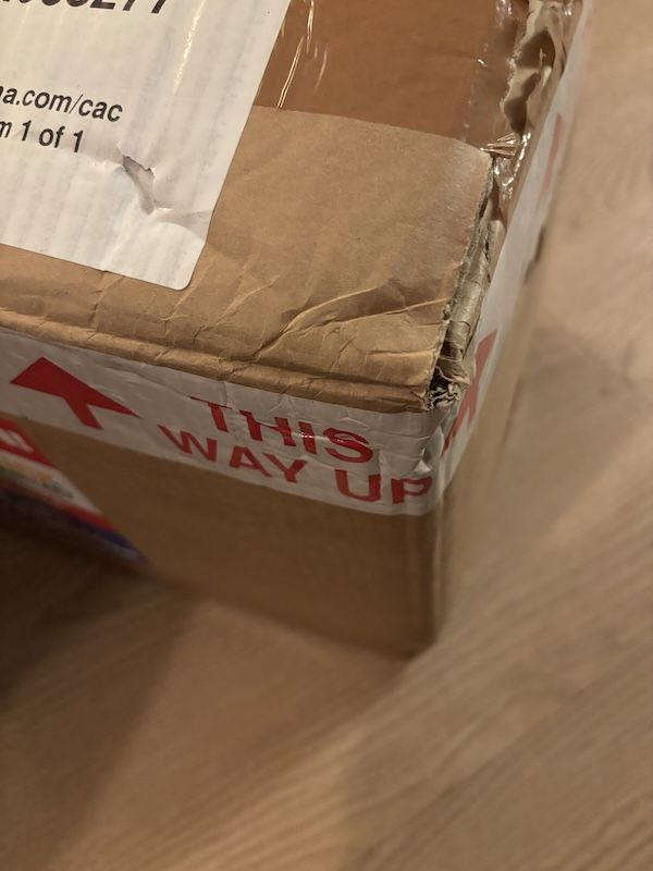

Boringly, the OBD scanner arrived just as it was getting dark, fitted the battery, whipped the positive terminal cover off and noticed a big crack on the corner of the new battery...box looked fine until I looked at it closely and it was squished in on one corner.
Bought it from Tayna though, and great service, no questions asked, just needed to send a couple of photos and they're arranging a replacement to be sent to my work next week, as they can't guarantee to get another to home tomorrow this late in the day.
The new battery's fitted and coded, and Tayna were fine with me leaving it in the car and just swapping it when the replacement arrives.
