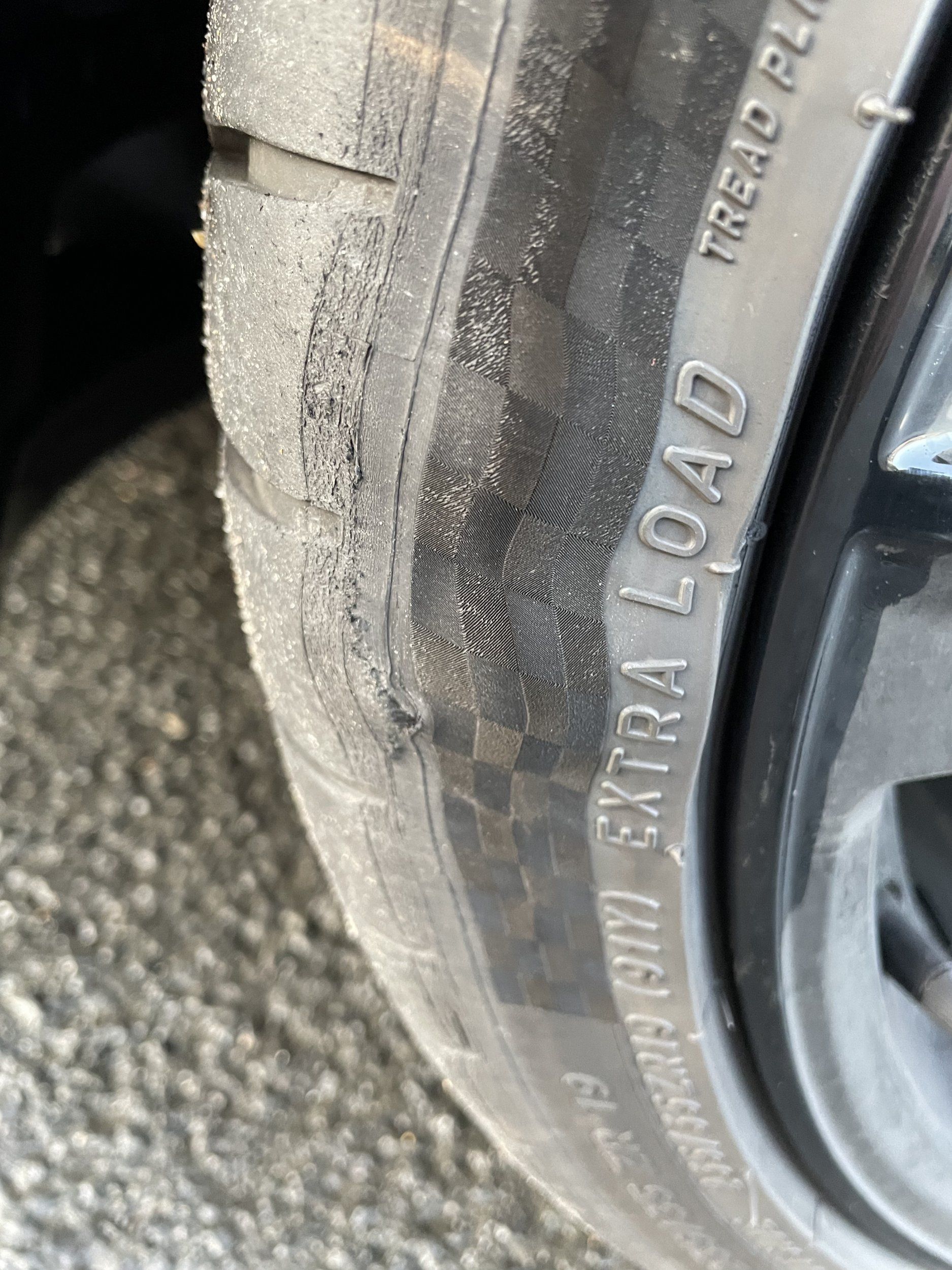

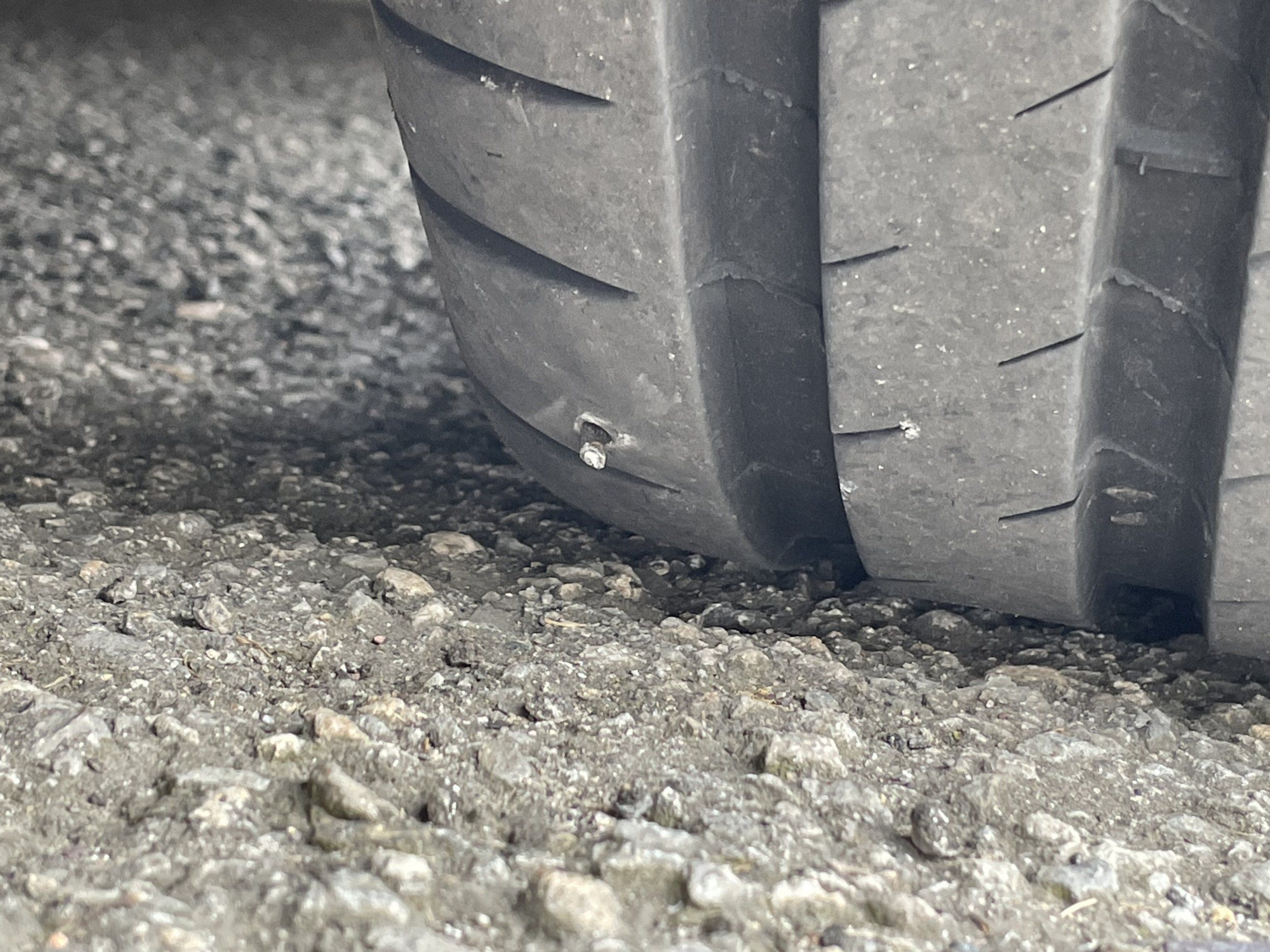

No idea where I got the inspiration from:
Nail was last month, and sidewall damage was debris on the way to work this morning 😭.
Thank the gods that I kept the two rear tyres after getting an unmissable deal on 4 tyres.

Feel like crying when I see damaged new tyres 😭😭😭
Hopefully the 'nail' one was fixable - that sidewall damage though 🤬

Unfortunately, the nail one was too close to the sidewall to get a repair done - new tyre as the tyre had less than 1k miles on it.
Hoping that there is no damage to the rim with the sidewall one - looks like Damage is in the vicinity of the spoke, so likelihood is reduced.

My techs would not repair a puncture less than an inch from the edge but more than that they would do, that nail might be around that mark? Of course they had nothing to gain by refusing to repair in order to get a sale.

The entry point was on the internal radius between the tyre wall and tread, so no chance.
I’ve repaired in this area on an off road platform (emergency repair) to get me to a point where a tyre change could be made.
As above, a PITA, but not worth risking mine or my families’ lives over a couple of hundred quid.

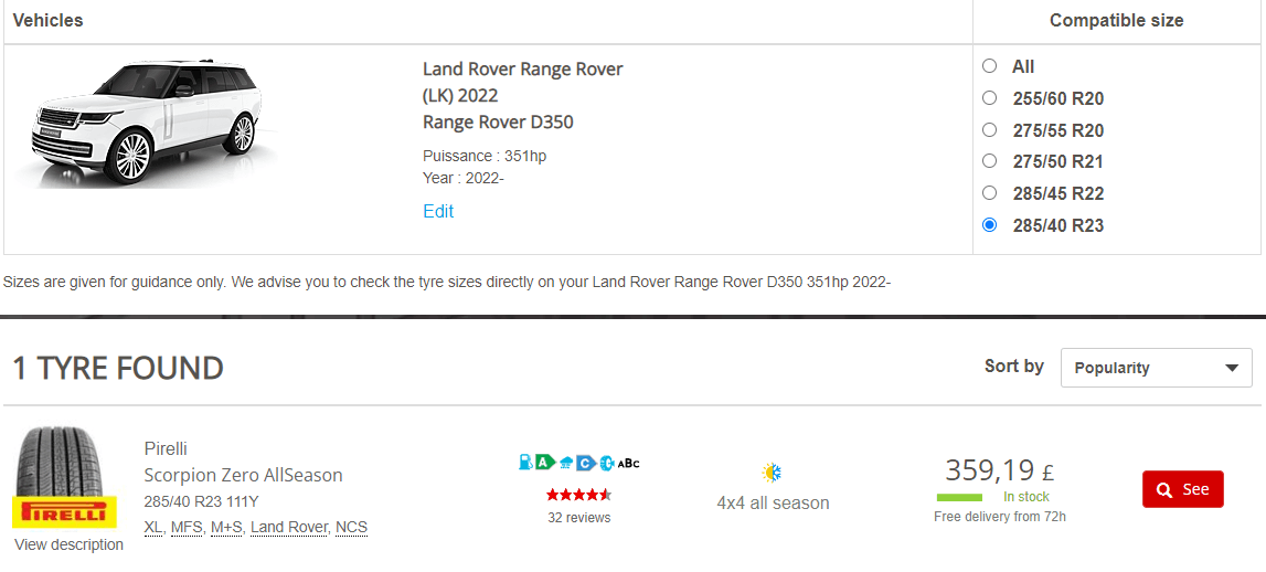

At least we don't have a new Range Rover on 23's! at £360 PER tyre!!! :sick:
My mate hit a pot hole and blew out his tyre - then the very next day hit the exact same pot hole and blew out his brand new tyre!! :eek:

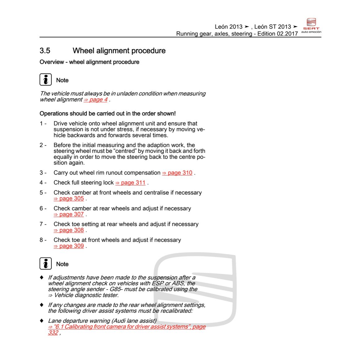

The alignment should be completed with new tyres anyway.
If carried out after fitting of new tyres its just been jacked up with wheels/suspencion hanging and body twisted unless on a ramp, I've seen many places track on arrival on the old tyres before its jacked/lifted off the ground as all is settleted on arrival, and have personaaly had good results before the car has been lifted, so whats correct???
So difficult to find a place which tracks a car right..

This according to the workshop manual:
You're supposed to check the ride heights before adjusting suspension as well - and adjust if necessary - which I'm sure not many do!
Edit# by adjust I mean add weights
They would normally bounce the car to settle it's suspension prior to any measuring/adjustments so i'm not sure jacking a side to change a wheel before hand would be an issue?
You defiantly need to measure both axle at the same time - i've seen garages adjust front and rear axles independently which will never give the correct result.
