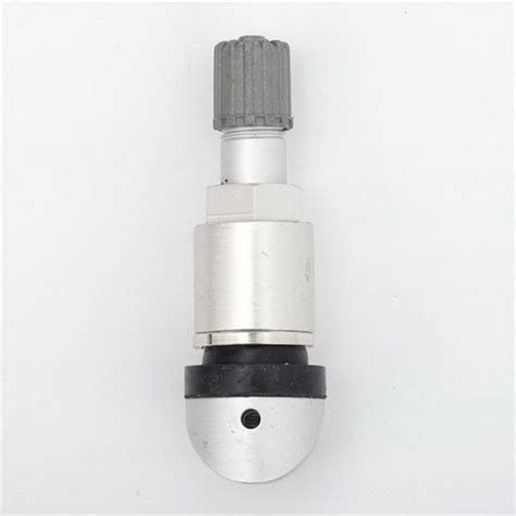

Yep.
A TPMS valve will look something like this:
