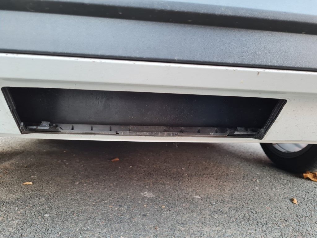

Hi all,

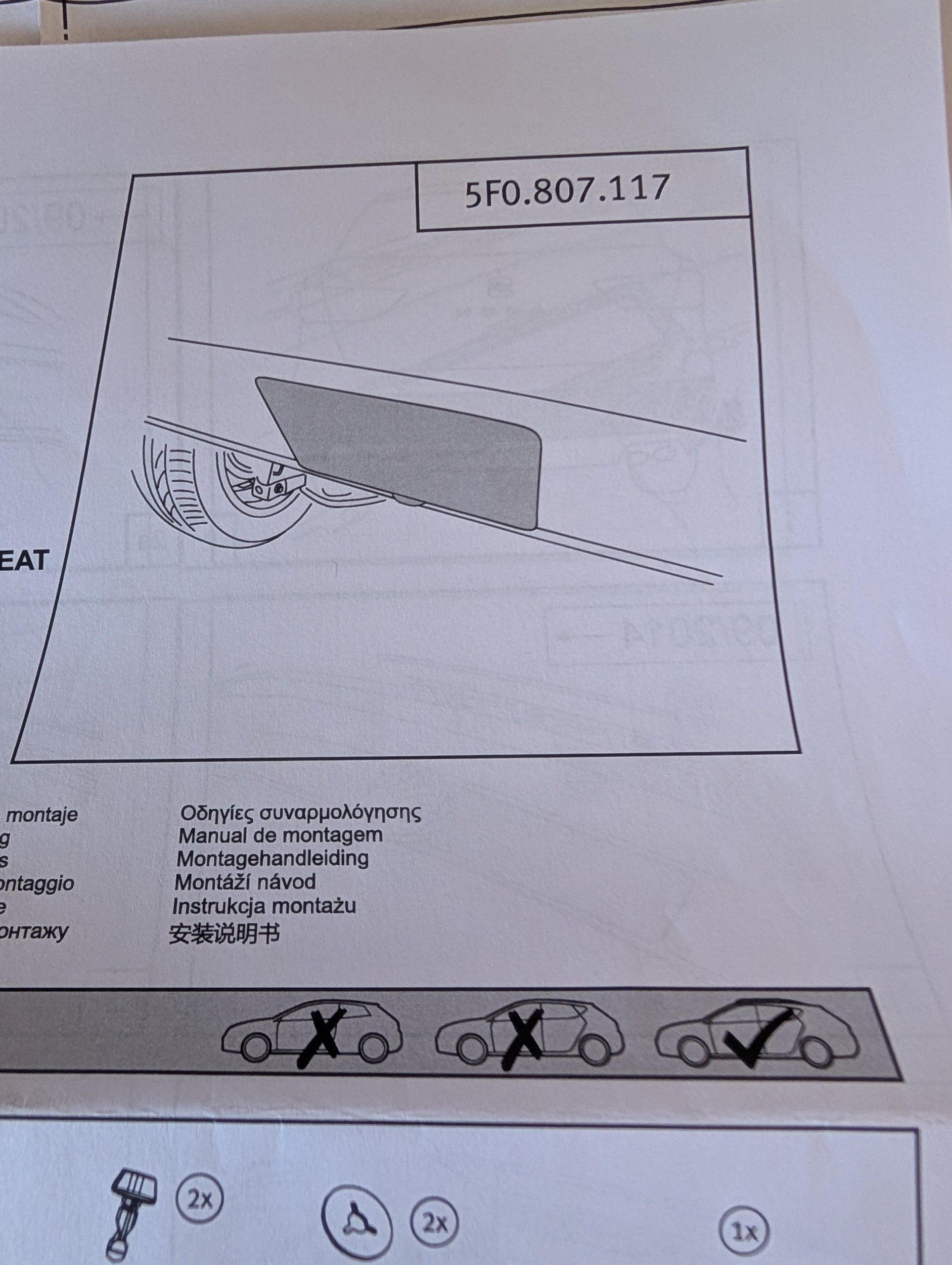

I have a question regarding my aftermartker towbar cutout. Regarding the Westfalia manual I'll need a cover with partnumber 5F0803595A. This is a smaller cover then what my cutout looks like. I have no clue what kind of cover I need.
It looks like this cutout, but the part @dj74 is using (5F0807819, he said in private chat) is not recognized as part number in The Netherlands.
I assume it must be part 5F0807117 but I can't confirm. I can't return wrong ordered parts.
Anyone can help me out? :S Anyone able to measure his towbar hole dimensions?
Car:
Seat Leon 5F 1.4 TSI 150bhp (hatchback 5 door)
My cars cutout:
Measurements (approx.)

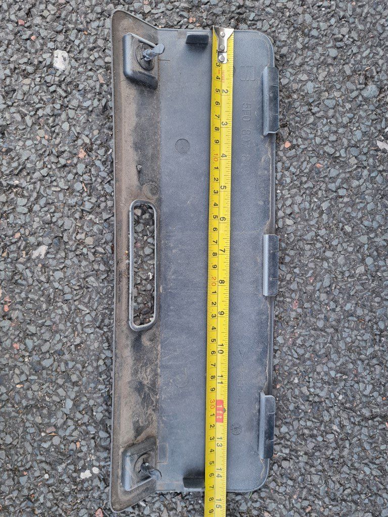

Sorry for the late reply I have been on holiday :) Anyway I've measured the cutout and the width is 360mm. Width of cover is 370mm. Other dimensions are the same as yours.
On the picture you have posted you don't seem to have the inside plastic bracket. This was glued to the inside of the bumper and this is what the cover screws into.
I hope this helps!
David

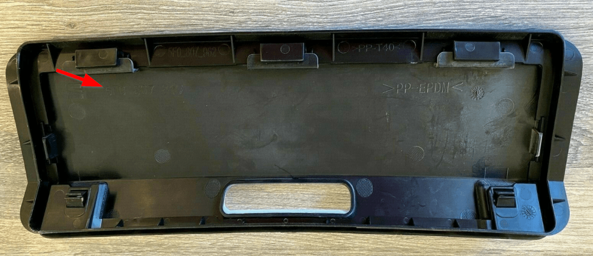

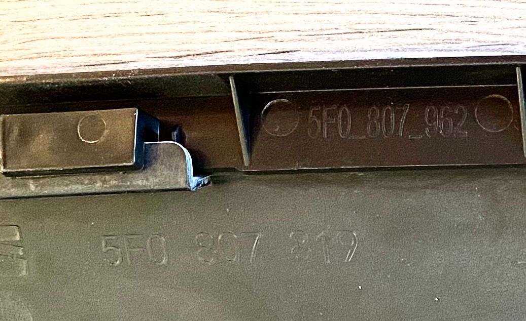

I've found something that might help. If you check out the pictures of this ebay ad for 5F0807117. On the pictures from the back you can just make out my part number!
This helps! Probably this 5F0807117 is the set-combination which includes:
5F0807819 (cover itself)
5F0807962 (bracket)
This bracket comes with set *117 as shown at the ebay pictures. I've contacted my local dealer and they confirmed. I'd ordered the part, I'll confirm it later on.
Bas H.
Jun 12, 2018
26
Ok so just to clear up some things for everyone:
5F0807117
This part number is the correct part number and contains:
5F0 807 962 (bracket)
5F0 807 819 (cover itself in primer)
Thanks y'all! Ordered the above part and this was the correct one.
