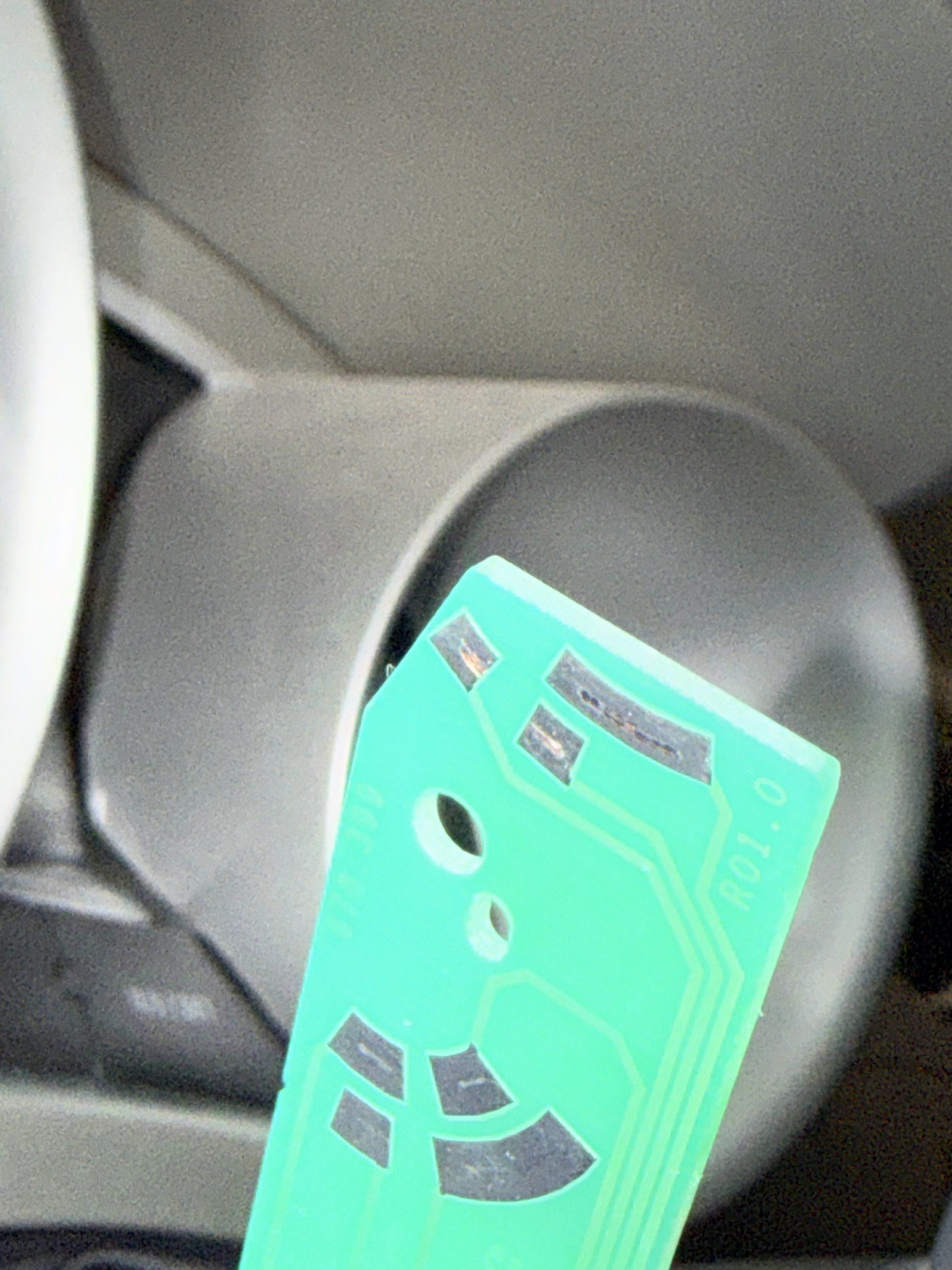

I have a 2012 Seat Ibiza 1.2 FR, and lately, my cruise control has been acting up. When I indicate, it deactivates the cruise control, and sometimes when I adjust the speed using the stalk, it turns on and off unexpectedly.
I plugged in an OBD reader and got the following error code:
00895 - CCS/ADR Control Unit: Implausible Signal
After reading some forums, I saw that cleaning the contact points in the stalk might help. So, I used a cotton bud and isopropyl alcohol to clean them . However, after reassembling everything and taking the car for a drive, the cruise control has now stopped working entirely.
Does anyone have any advice on what I should try next?
Images attached below
Thanks
