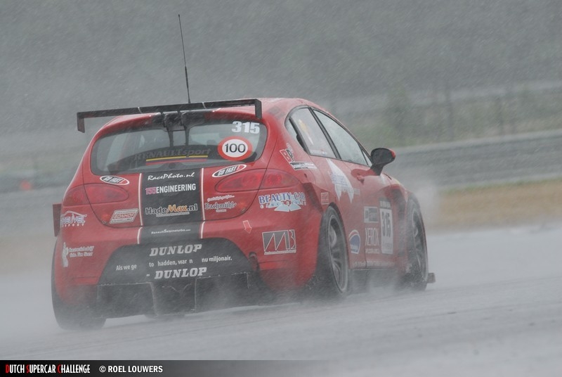

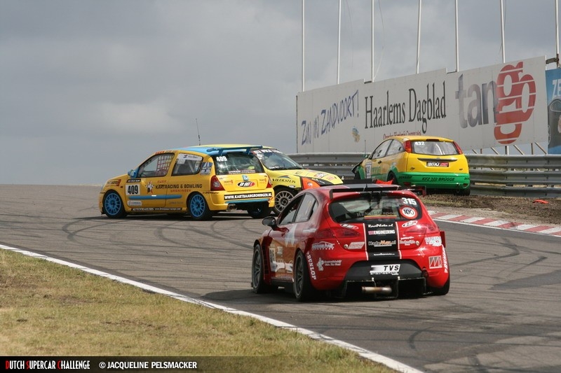

Luco Supercopa
This is my supercopa racecar.
specs:
Chassis type :
steel monocoque, welded roll-cage
Aerodynamics:
full aerodynamic package including front splitter,
flat bottem rear diffuser and adjustable rear wing
Engine :
- layout : front transversally mounted - type : 4 cylinder – 16 Valve – 1984 cc turbo engine
- bore x stroke : 82.5 x 92.8 mm
- power supply : Seat Sport management system
- max. power : 301 HP
- max. torque : 340 Nm at 2100 rpm
Transmission :
- type ; front wheel drive
- gearbox : 6 speed DSG gearbox
- gearshift : steering wheel with paddle shifts
- differential : limited slip differential
- launchcontrol
Suspension :
- shocks : Koni 2 way adjustable racing shocks
- springs : Eibach racing front springs
- stabilizer : front and rear stiffened adjustable anti roll-bars
- rear : Bilstein upside down coil-over racing shocks
Brakes :
- Front, ventilated discs 362/30 mm with AP Racing 6 piston calipers,
- racing pads
- Rear, 255/10mm with Seat callipers, racing pads
Wheels & tyres :
- 9.0 x 18 Braid racing wheels
- 250/640-18 Dunlop tyres
Dimensions :
- length 4475 mm
- width 1987mm
- height 1384mm
- wheelbase 2594mm
- front track 1662mm
- rear track 1591mm
- kerb weight 1130 kg
- fuel tank size 63 litre
We are busy to get the engine better
Now i have
- max. power : 330 HP
- max. torque : 410 Nm at 3100 rpm
We want to go to
- max. power : 360 HP
- max. torque : 480 Nm at 3100 rpm
