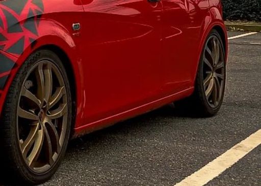

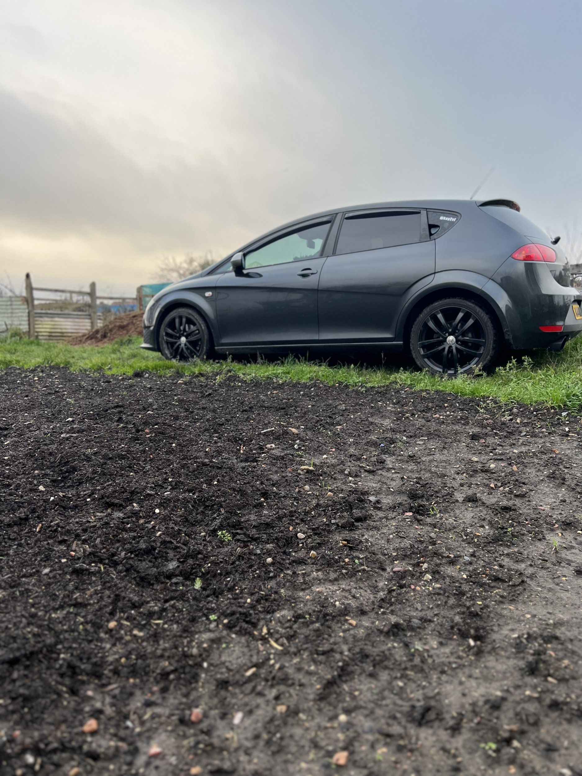

Nov 14, 2023
Hi Damian,
It was a relatively old post, believe 2013! Think they were amax, or at least was mentioned.
I'll attach a picture of my car from the side view to show the arch gap and what my options may be for dropping it.
The result I would like would be:

From looking at the picture I'd say to get that look you'd need coilovers. The lowest you'd get from springs alone on the FR would be around 30mm.
