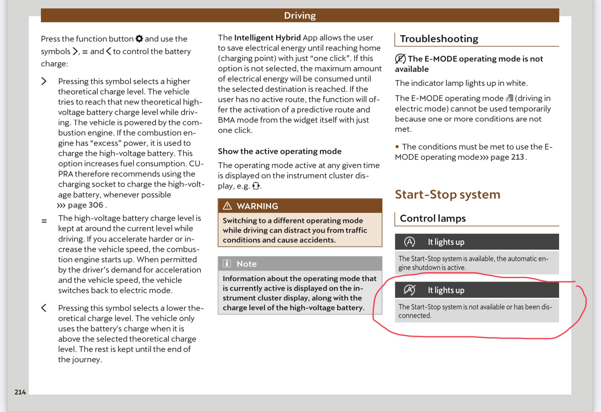

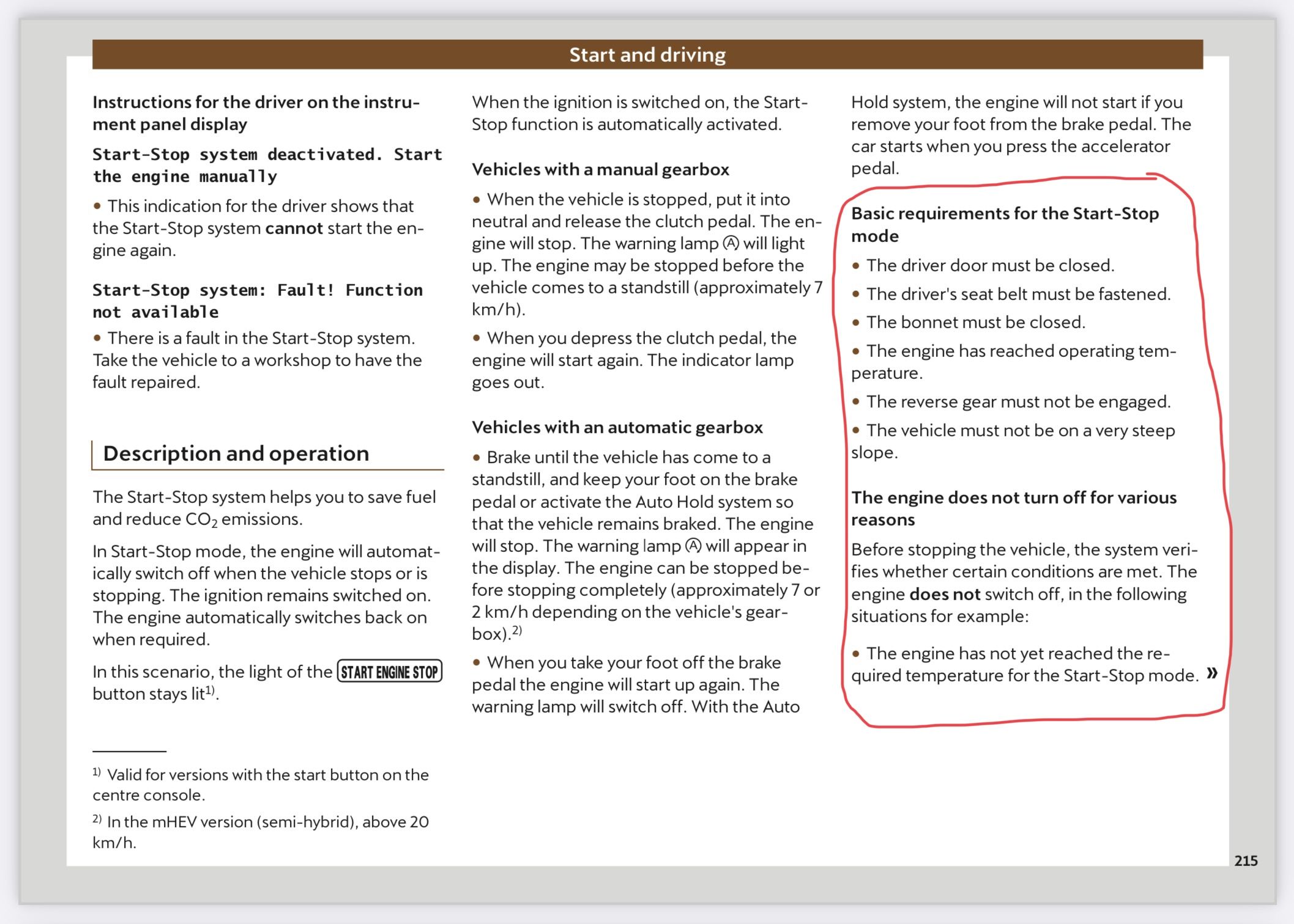

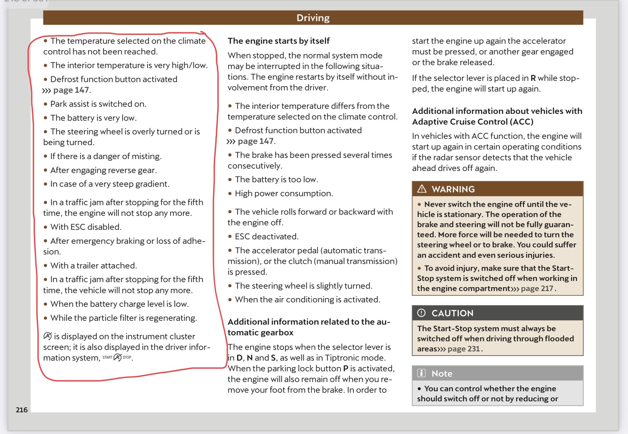

There are certain conditions that need to be met before stop start will activate. The stop start control lamp in the instrumentation display will also have a strikethrough line through it if stop start isn’t available. Screen shots below are from the June 2021 edition of the owner’s manual;

I think that may be the reason with my car, page 216, top left, 'the temperature selected on the climate control has not been reached'.
