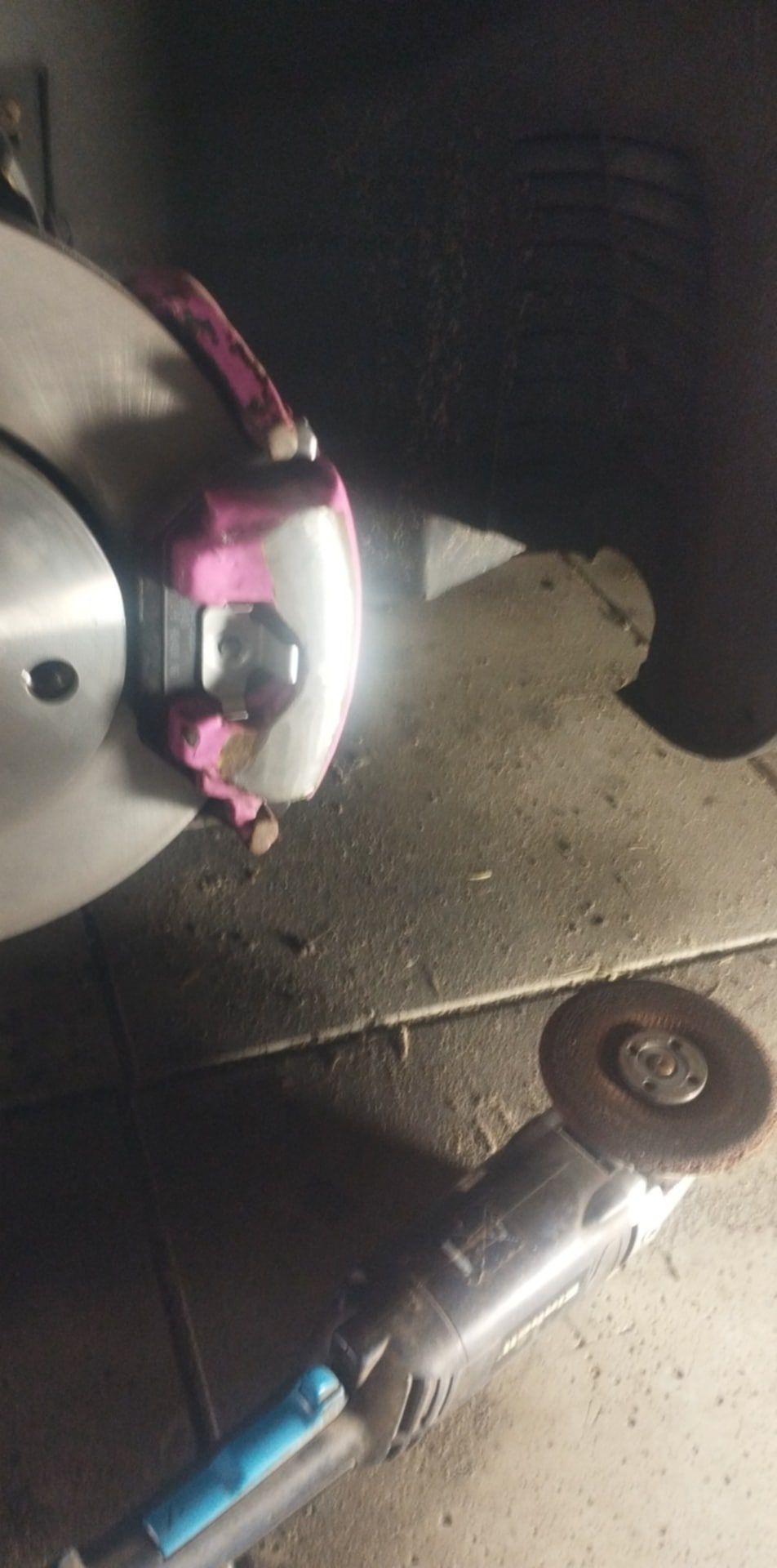

TaTechnix coilovers (no rear regulation, front max bottom without lock nut + bumpstops cutted 2/3 length)

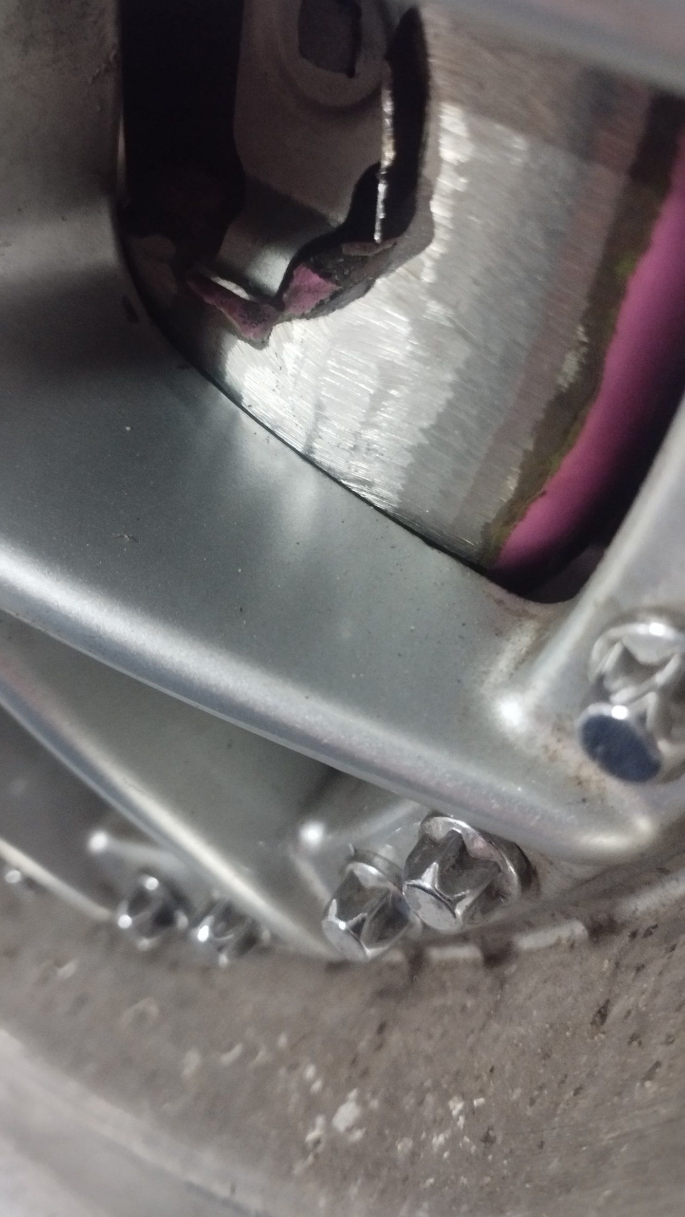

DZ1 Exklusiv 16x9 ET30 on 195/45 (+5mm front spacer because rim was hitting the strut, arches not rolled or flared, bone stock)

Nothing rubs 2-3mm clearance
