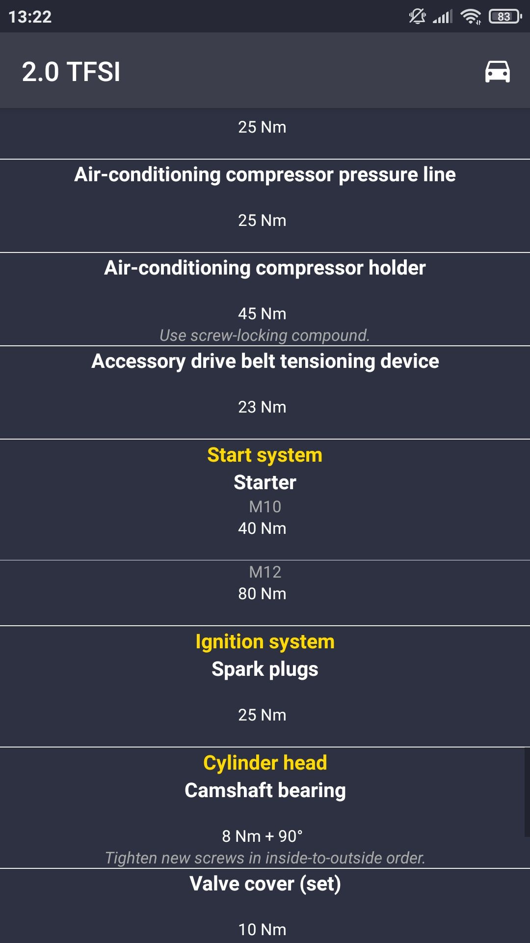

Hi all, next weekend I've got to replace the starter motor. Anyone know the torque settings for the bolts and is there anything I need to keep an eye open for?

Probably too late but the only thing I’d say is disconnect the battery first I’m sure you knew that anyway but just Incase otherwise it’ll make you jump when the cable hits the gearbox lol
Thanks
Fish
