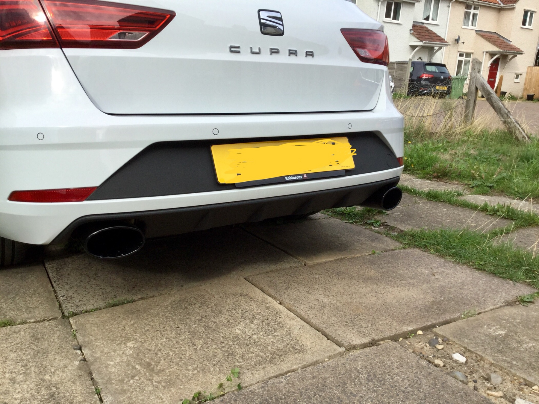

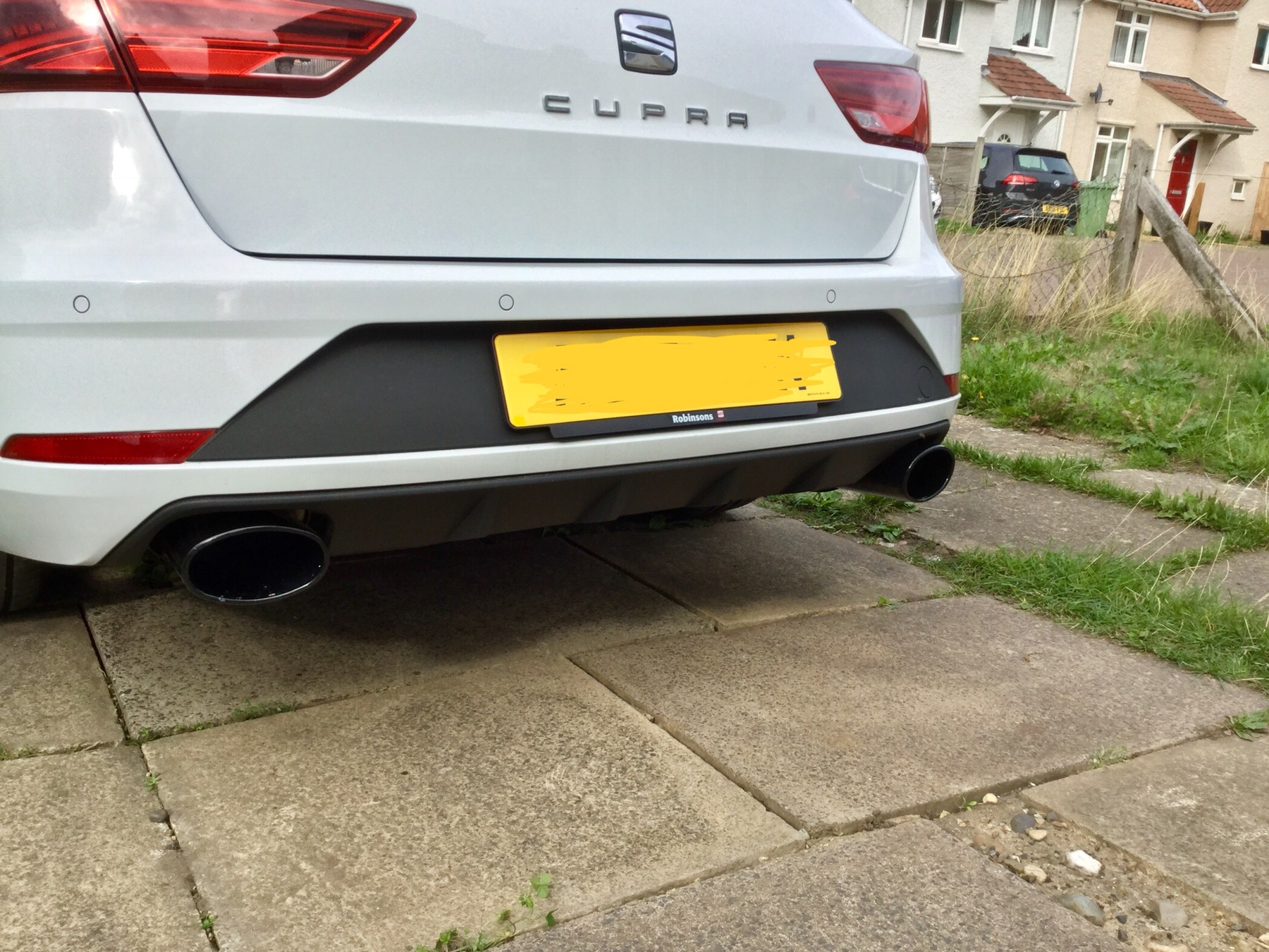

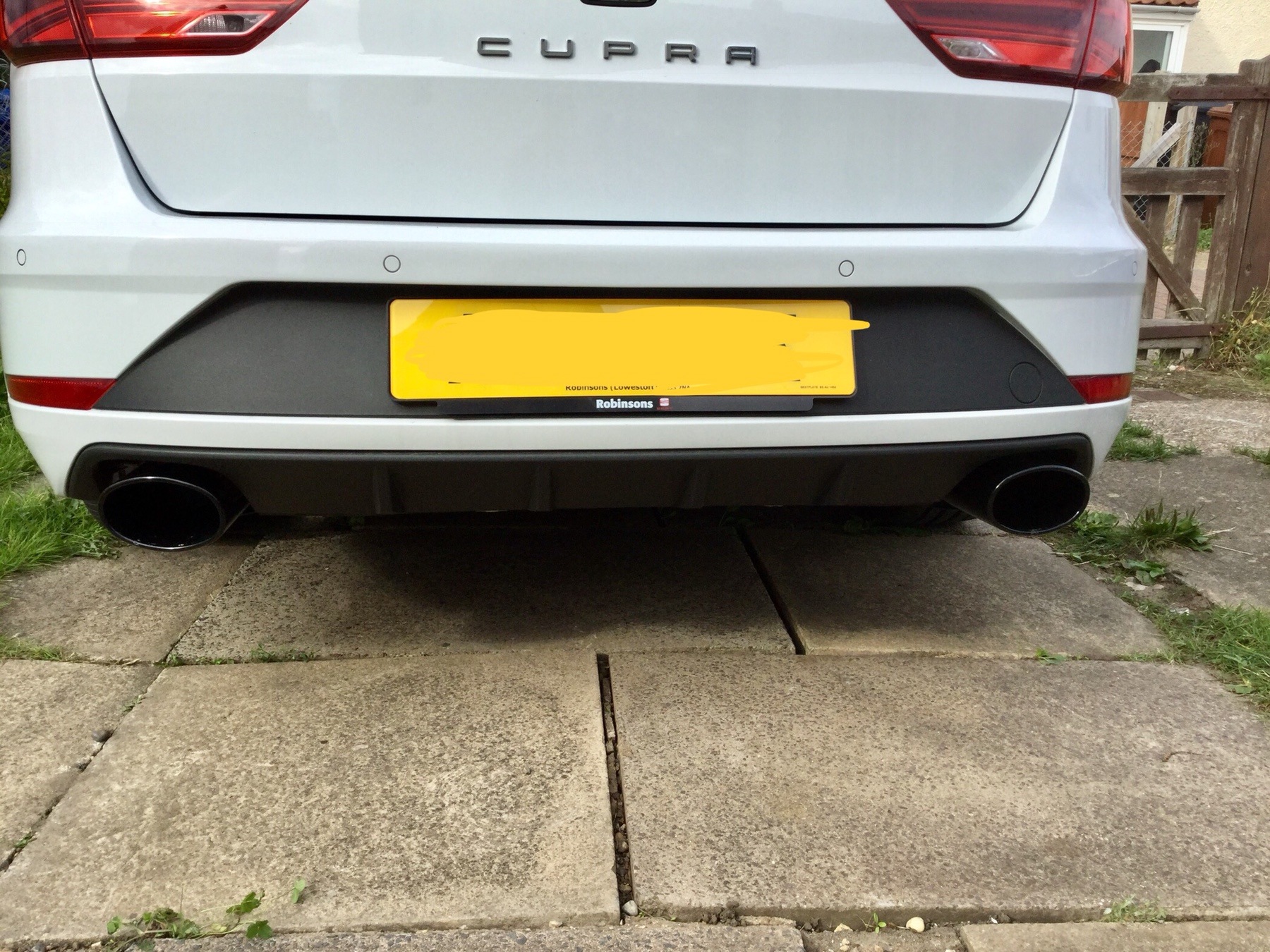

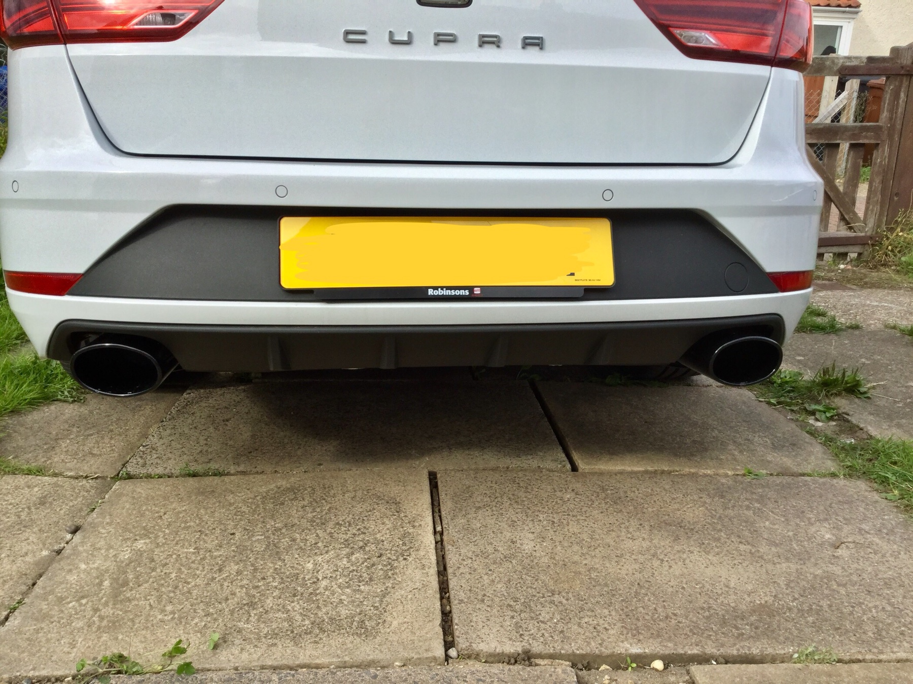

Ibizafrsy4.... had mine done for 5 months now and had no issues what so ever, even with a new cat back exhaust system fitted (which makes it sound even better) you having a a problem with your set up... View attachment 1670 View attachment 1671 View attachment 1672 View attachment 1673
Thanks for the reply, wish I could change my name! Now have a Cupra 300 SC and want a res delete on it but I’ve heard that at certain speeds there is a blatant drone noise, wouldn’t bother me too much as don’t go on the motorway all that often but would prefer if it was limited, but beggars can’t be choosers I suppose!
I also want new tail pipes, quad tips like your Akrapovic ones that you had (at least I think that was you!) but probably not going to fork out that much for those, but yeah quad tips of some sort. Not sure how to go about it as I find it a bit complicated and if I go to a garage (again not sure which one because I want an excellent job of it) I’m not sure if I would explain everything right!

deanoj1971 pointed me in the direction of alibaba.com for some Akrapovic tips
I didn't end up buying any though as there were lots to choose from and I wasn't sure which ones would fit my 300...
Reactions: cupra300uk
Deano j1971
Jan 5, 2018
586
632
Tully1980.... sorry fella should have told you that I ordered 63mm in/ 76mm out and this size will fit your rear diffuser if it’s stock or one from rieger...
Deano j1971
Jan 5, 2018
586
632
IbizafrSY4... there should be a few exhaust specialists round your way maybe powerflow etc, they should have some quad tips that you could choose from as well, and you could also try eBay.. your the customer so if you explain what you want doing they will listen to you, you just have to trust these people sometimes they have probably done what you are asking them to do a few dozen times.. I a bit ocd when it comes to this sort of thing especially to my car so just have a little faith you won’t regret it.
