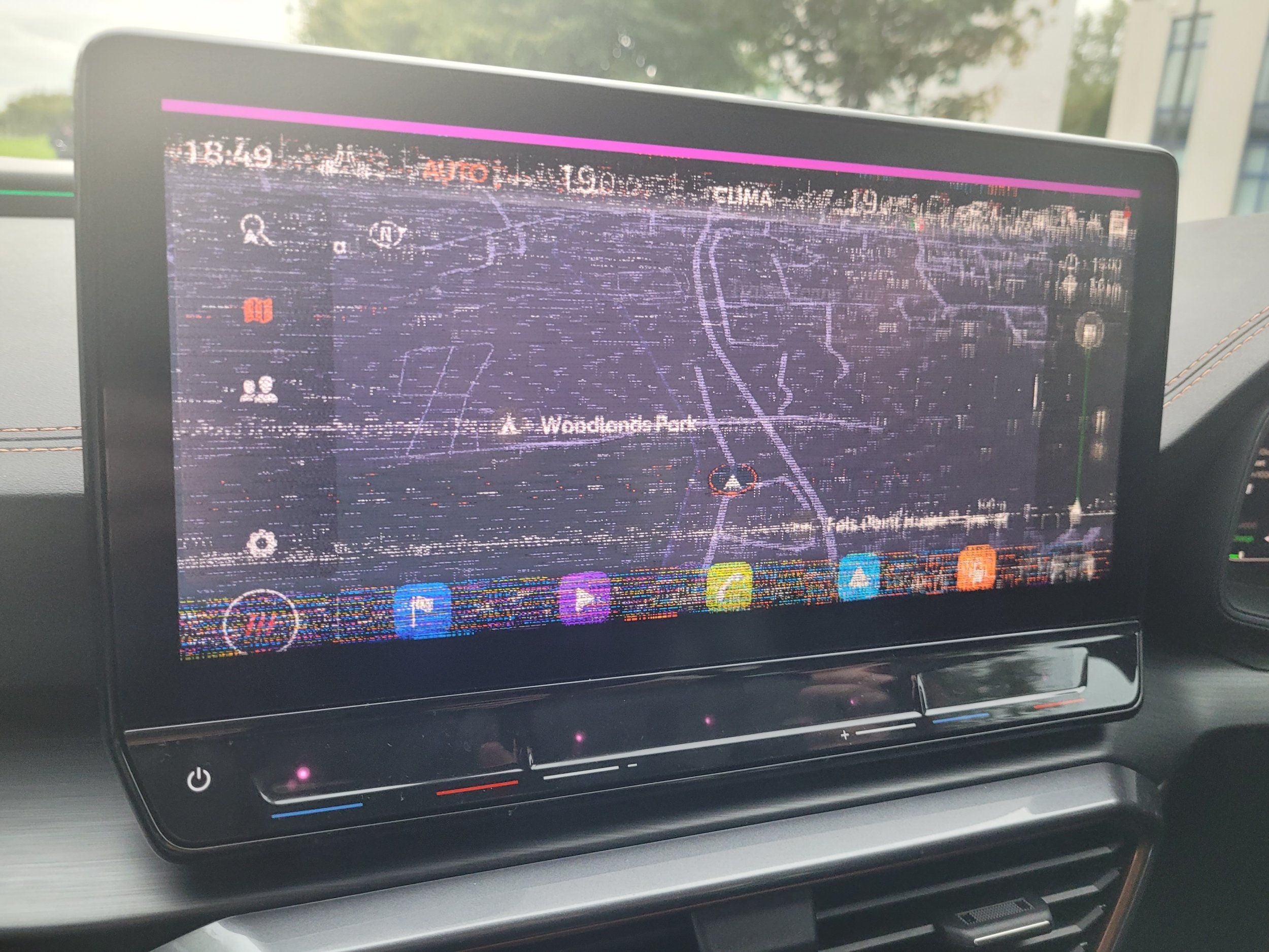

OMG - i have the car from new (2 weeks old and my screen went like this .- just now this evening...
A car restart "fixed" it - but i am also getting random restarts on the head unit...
Is this a symptom of NOT having the 1940 software?
My car has version 1900 on it.
That doesn't look good at all o_O. I'd say it's a display problem or some local major interference perhaps? Never seen anything like this tbh.
At least you have a photo so make sure the dealer sees it when you book it in for the issues you are having.
I wrote a list of my issues and snapped a few photos too. This really helped push the dealer to check everything and do the updates.
I'd be making a call to my dealership from the safety of a bunker, anything that looks that 'Independance Day' is not going to be good 😳🙈
