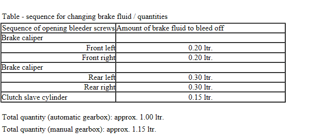

This is what I have, it was found on a VW Group motoring forum and I'm sure that the copies of the official workshop manuals use the same information:-
Both you and I and I'd think most other people, start at the rear of the car, maybe VW Group wrote it this way to make the task slightly quicker - ie time is money! Plus the above information will be for LHD cars, like you have.
Edit:- I don't think that the quantity of brake fluid you removed has any effect on how these brakes now seem to feel.
