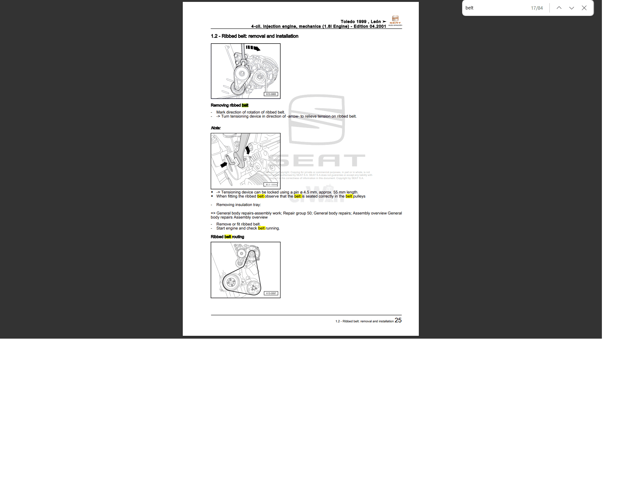

Hi mate.
Water pump is driven off the cambelt. Aux belt drives alternator, power steering pump and AC
I would remove the belt and spin all the pulleys by hand, make sure the bearings aren't seizing up on one of them. Easy to remove the belt. Attached pic.
