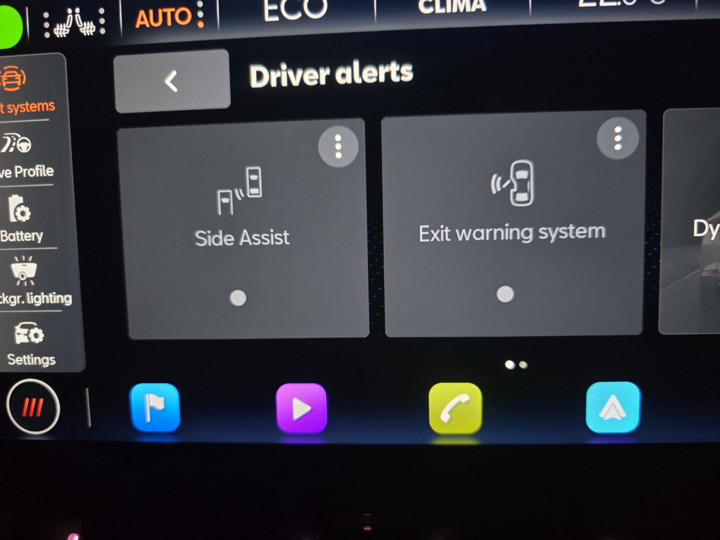

Hello everyone,
I'm hoping someone can shed some light on an issue I'm having with my 2021 Cupra Formentor. In the infotainment system, both Side Assist and Exit Assist are grayed out and unavailable.
I'm not sure if this is a software glitch, a fault with my specific vehicle, or if these features simply weren't included in the 2021 model year. I've noticed that the newer VZ2 trim level now has them as standard, and I've confirmed that they are indeed included. However, I haven't been able to confirm if they were available, even as options, on the 2021 model.
It would also be interesting to find out if others who don't have side assist and exit assist still have them show but greyed out or if they don't show at all.
Has anyone else experienced this? Any advice or suggestions would be greatly appreciated!

Jan 16, 2025
Thank you.
I had previously looked at that booklet but noticed the following at the bottom "
Specifications refer to Model Year 2022.
While CUPRA makes every effort to make
sure that specifications are accurate at time
of going to press (08/2021), you should
always check details with your CUPRA
Retailer as there may have been changes
in view of CUPRA’s policy of continuous
product improvement. The right is reserved
to change specification and colour at any
time. The information in this price list can
therefore be given as guidance only"
The car was first registered in September 2021, but i suppose it could have been ordered before the above August date.
It seems a tricky one to find out for sure.

Jan 16, 2025
Thank you, I will send over later I'm on mobile and don't have it with me. I do however have the full list of pr codes for me car, do you know what I should be looking for ?
None of the codes mention side assist, I can see Lane assist etc. I wasn't sure though what code to check for.

Jan 16, 2025
I have the lane change assist and and i have exit warning system 79H i also have WDL and this appears to be the XL package but nothing says side assist.
I will send VIN over shortly
  • PR CHECK.pdf
Side Assist *is* the Lane Change Assist.
Jan 16, 2025
So now i need to work out why the options are greyed out lol :)
You will see from the picture they are just greyed out.
Jan 16, 2025
Yes, i have no faults though. Going to check through the "3C Lane Change Assistance" module tomorrow to see if there are any coding options where it could have been disabled by a previous owner.
Any coding to completely disable it would be more likely on the gateway installation list.
