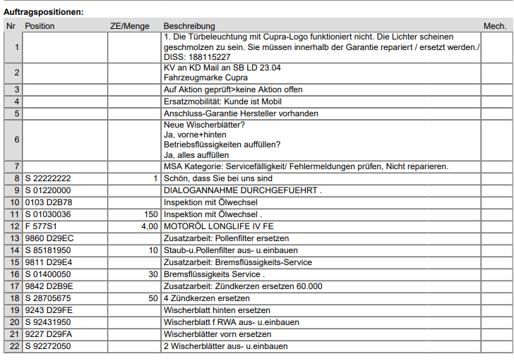

I can speak for German one. Once a year oil change, and every two years heavy maintenance. You can see the same on the infotainment panel too.

Oil change every year
Oil change service and inspection every two years.
That is the schedule for my VZ e-Hybrid. Maybe it is different for normal benzin or diesel cars.
