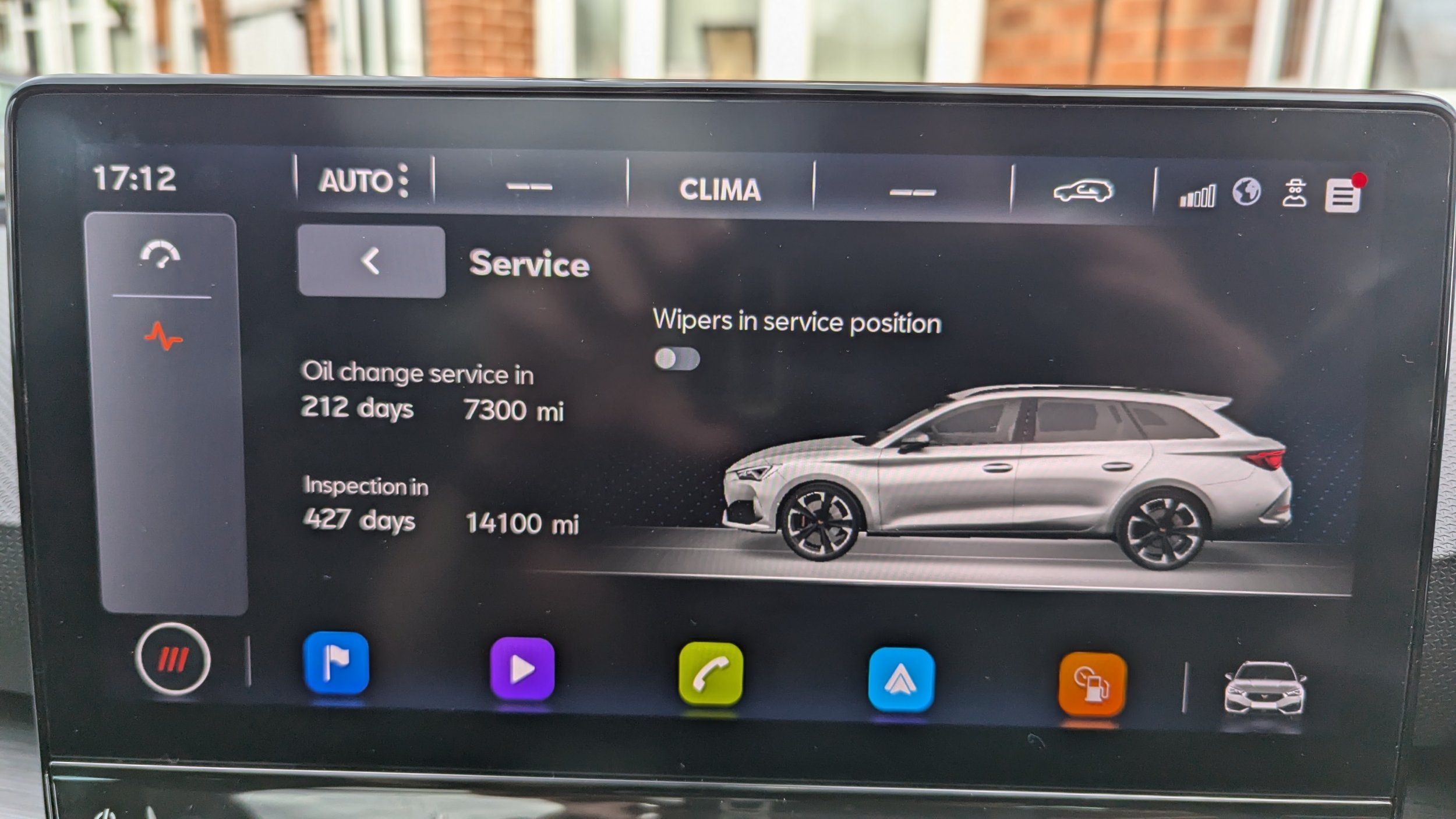

It's currently on the flexible service schedule but as I do sub 10k pa I'm going to alter this and get it serviced yearly.
I've checked the service details on the car's infotainment system and this backs up the dealer who sold me the car saying it didn't require a service till Sept 2025...but for me that just doesn't feel right.

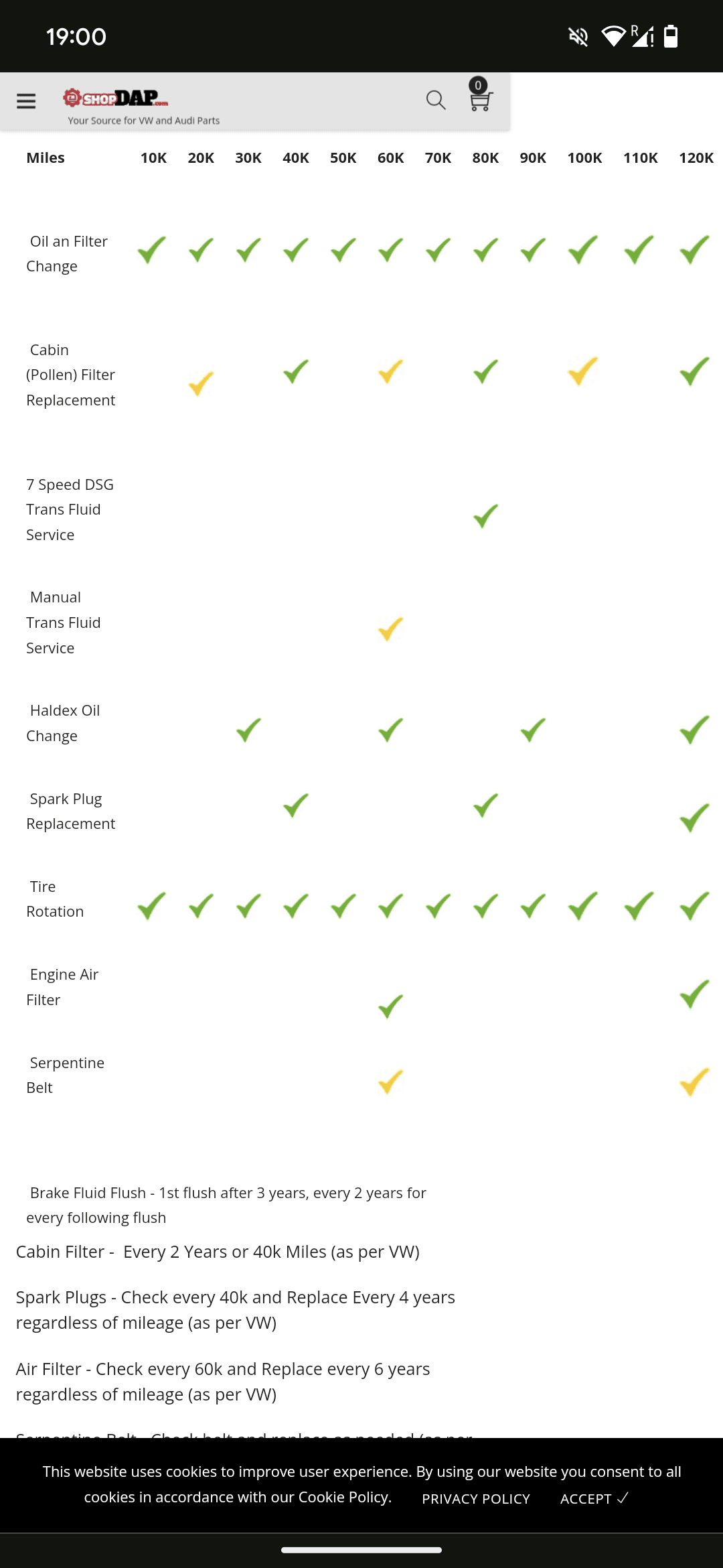

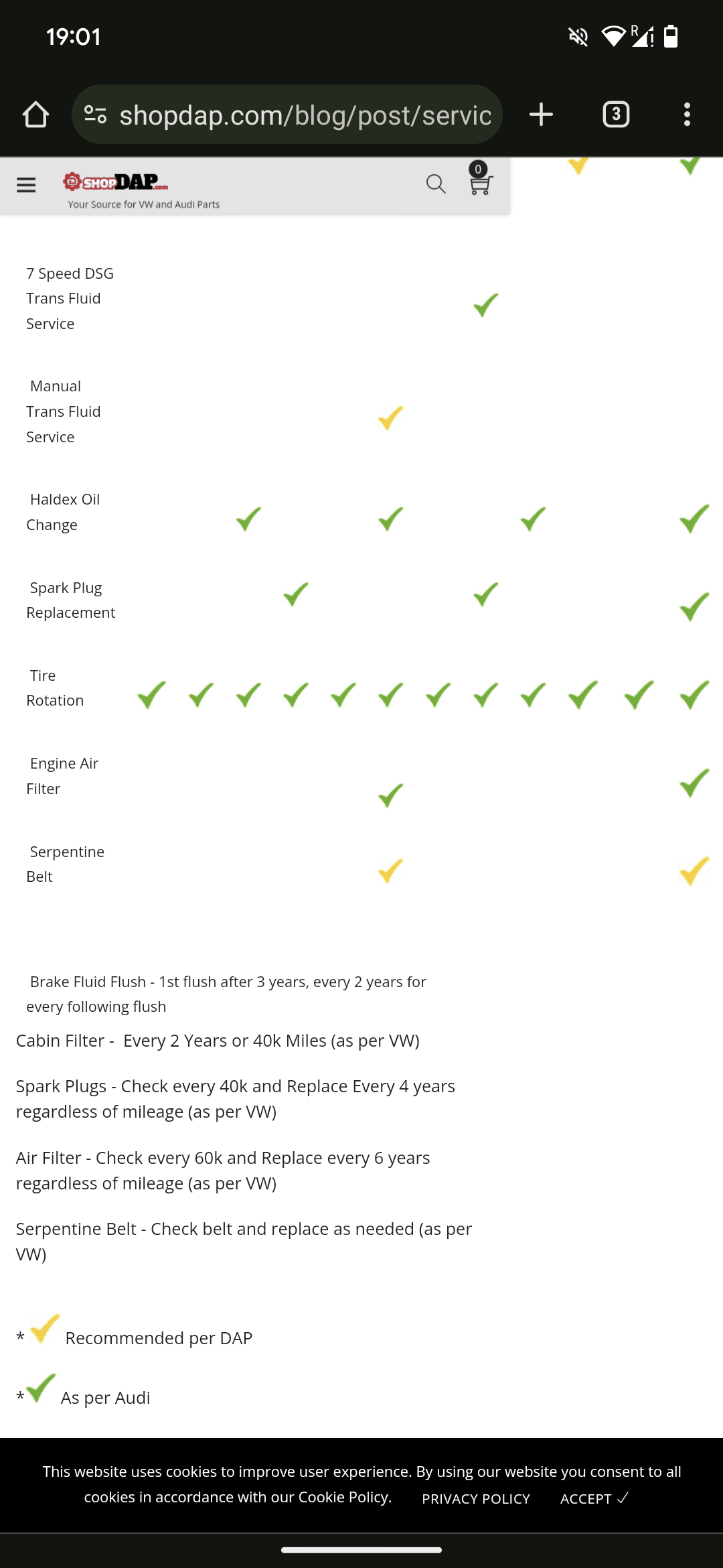

I've looked over this service plan but cannot see where the DSG and Haldex are going to be serviced. Any idea what age / mileage these should be done? I can see break fluid mentioned though.
