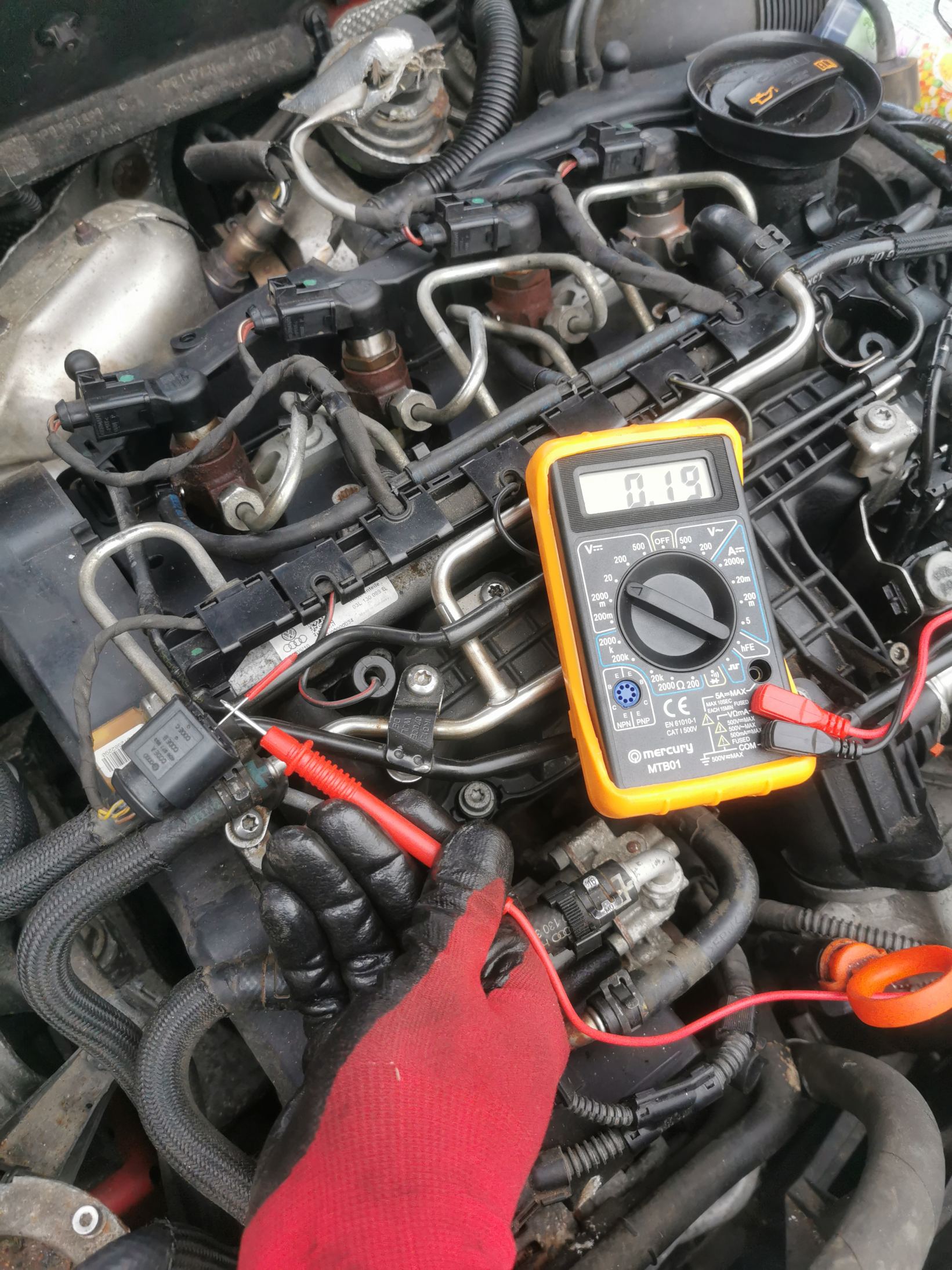

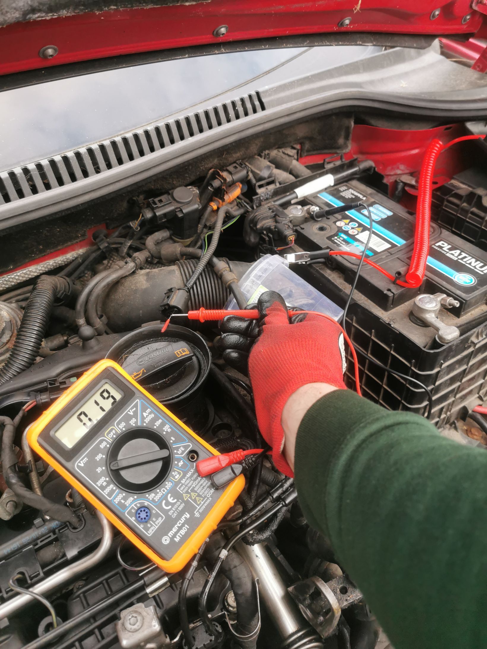

- Tried to find 5V reference from the ECU, but instead found 0.19V volt in two connector places. One fuel related other not sure.

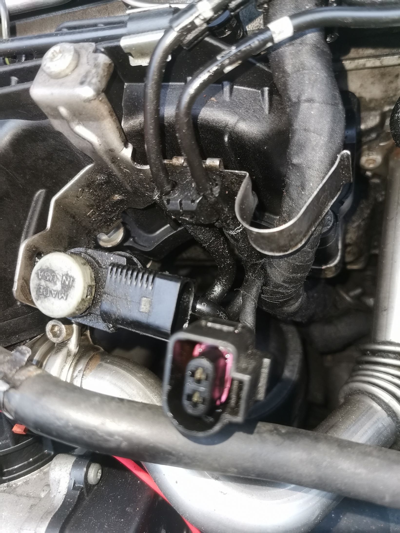

- one connector is fully covered in something (last picture below). when i inserted needle inside it came out black. i believe this is turbo related sensor.

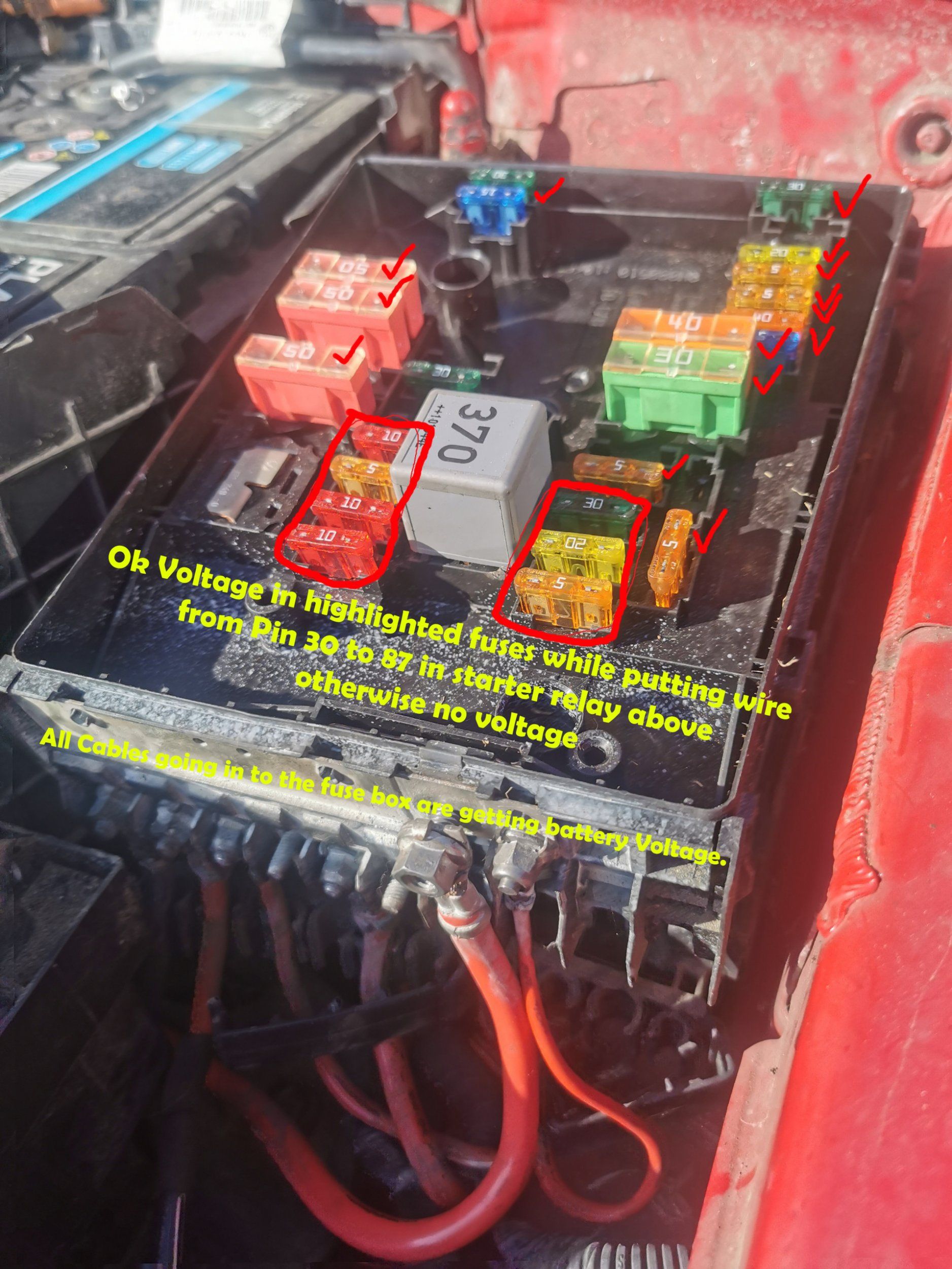

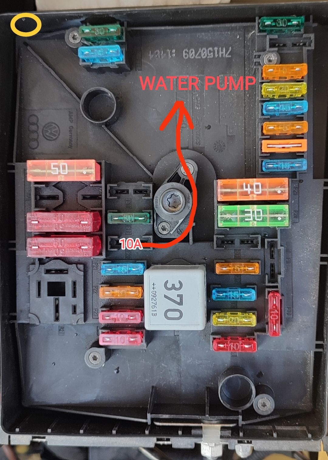

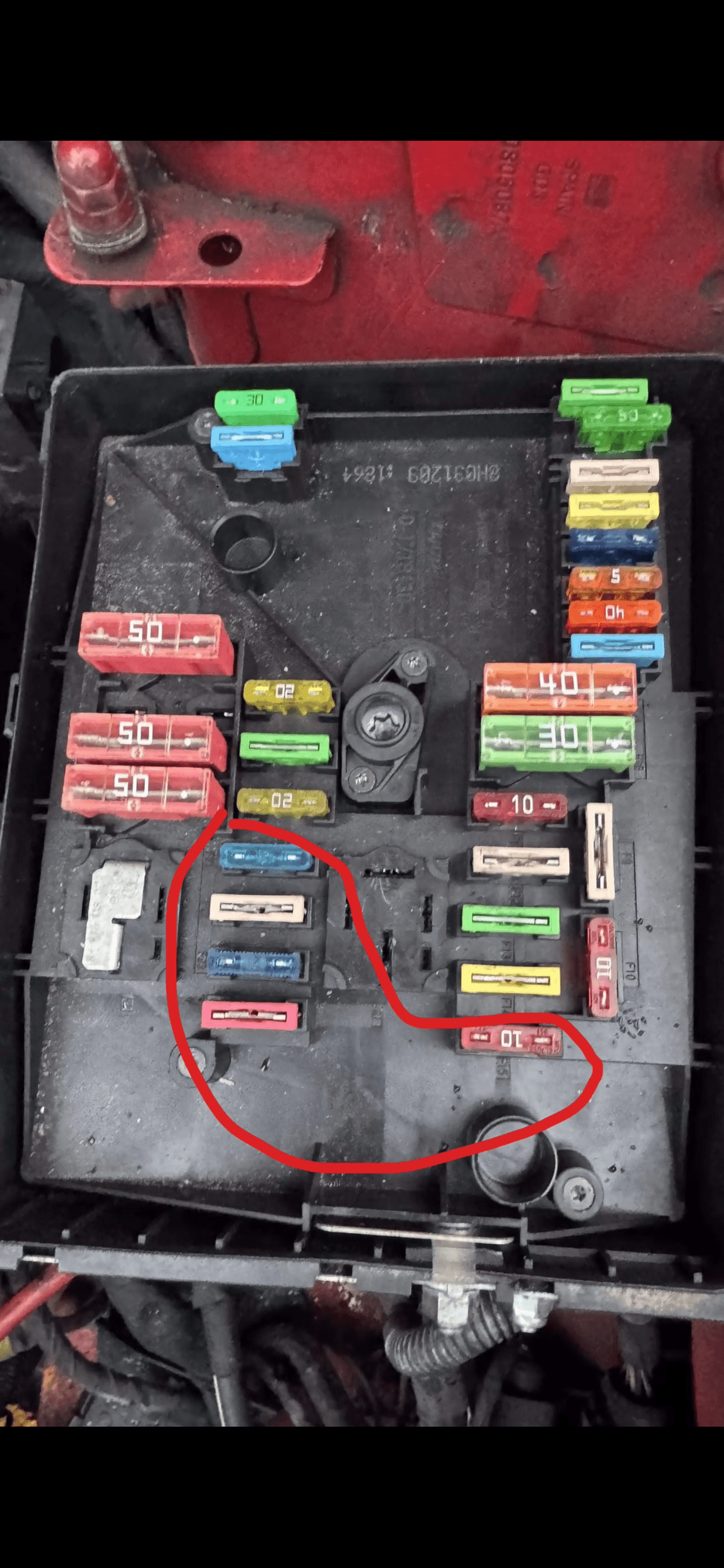

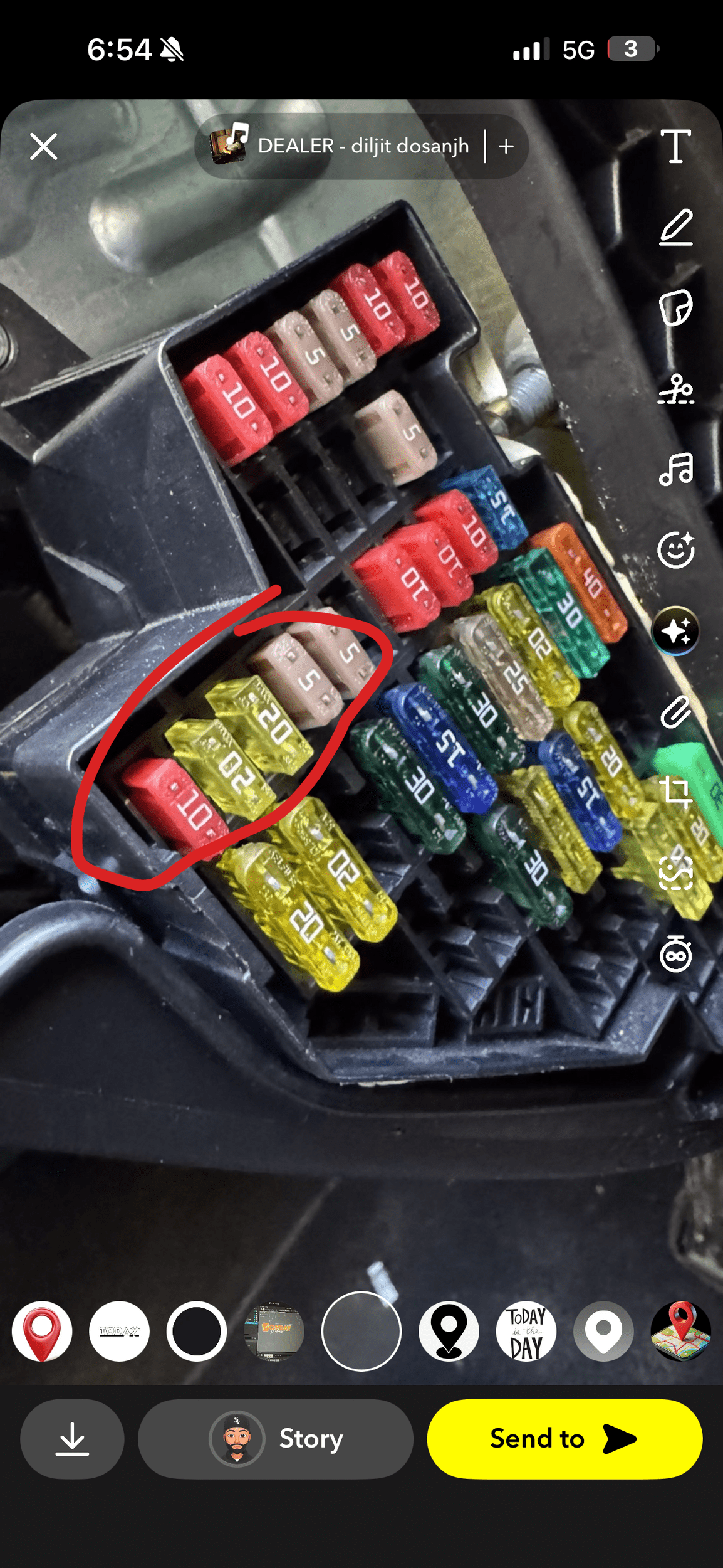

- I have checked all fuses under the hood as well next to the steering wheel and all fine.

- the starter relay R1, does not receive voltage on pin 87 at all. Grounds on 85 & 86 are fine. Battery Voltage present on Pin 30.
