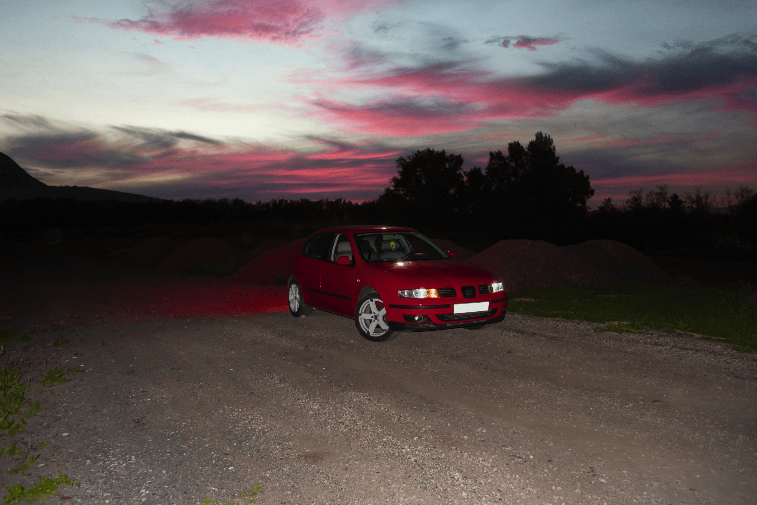

I got a Seat Leon 2002 1.4 16v car for graduation and it does have a couple issues what I'd like to solve.
