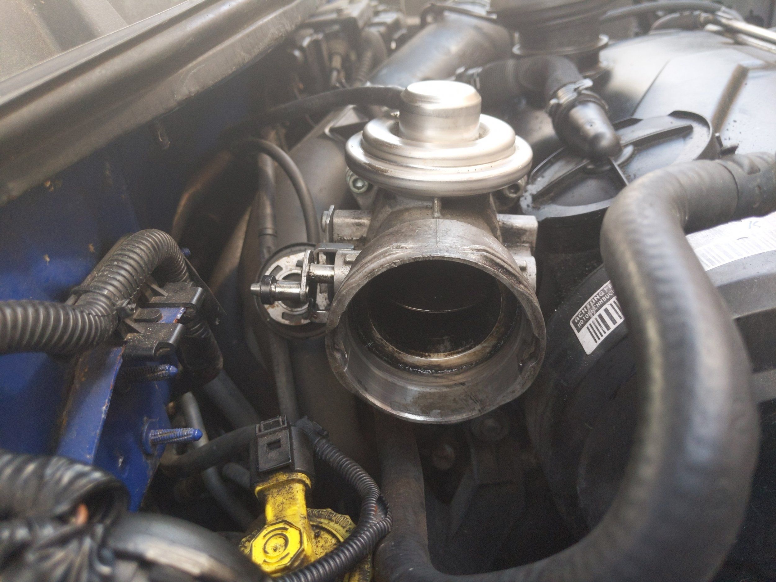

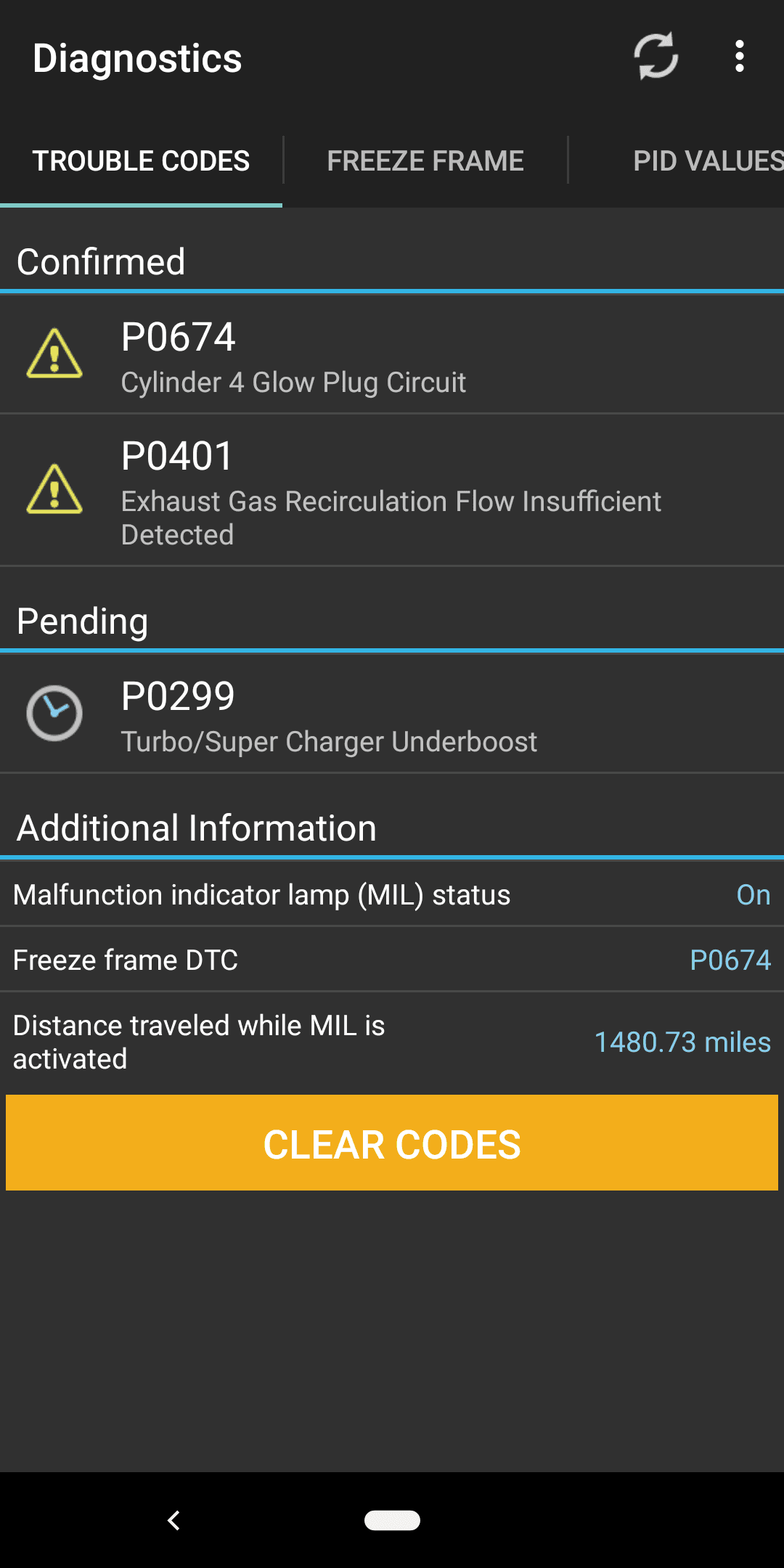

Noob here, to save me starting a new thread does anyone have any advice on taking it off? I can only see 2 bolts but loosening them does nothing, and trying to clean without removing is probably not that effective.
I want to give mine a proper clean as it looks absolutely filthy and I am getting extremely bad mpg and power loss, this is what came up on the OBD.

There are 3 bolts holding the EGR onto the manifold plus 2 bolts underneath which connects the metal flexi pipe to exhaust manifold
And they're horrible. Don't forget that.
Put something under the EGR when you undo the bolts, because you're almost certain to drop either an allen key, one of the bolts or the gasket.
I used both a 1/4" ratchet and a normal allen key to get at the bolts. They're easy enough to get undone, but they're just very awkward to get your hand in enough to get them undone without having a really weak grip on the ratchet or allen key, hence the dropping risk. They'll go straight through the engine bay most of the time, but I have an undertray, which makes it more of a faff finding anything.
that's pretty clean for a EGR when cleaning it use wynns EGR cleaner just use gloves as its strong stuff, its the other codes id be worried about and driving 1500 miles on ML light , the rail that holds the heater plugs can break up and crumble i changed mine when did the heater plugs a while back think it was 27 quid for rail at time.
