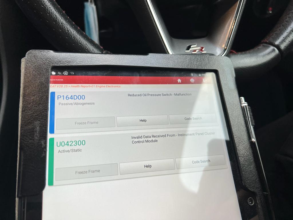

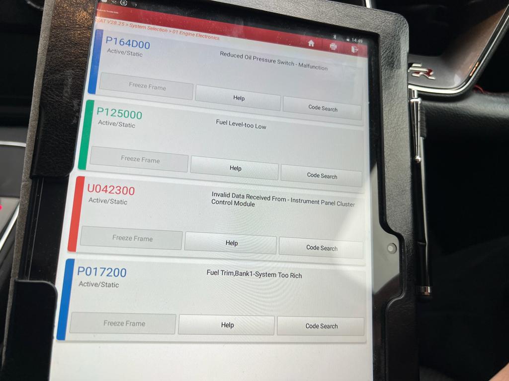

As the car is now, there is a jumping misfire. The car will start from cold and it will run okay for 5 minutes at best before it reaches optimum and the EPC and engine light forces the car to shut off. If it decides to crank over the car will go into limp, the car will judder hard and obviously won't go past a certain RPM, there is no white smoke this time around but the more you drive and the more it shuts off the less likely it is to crank over. I'll attach the diagnostic notes from SEAT along with fault codes. Based on the fault codes and previous work, I myself am ruling out the possibility of faulty fuel injectors and looking at the possibility of a vacuum leak somewhere or maybe electrics. I am by no means an expert in cars but I am grateful if anyone can shed some light on the topic, really struggling for ideas and anything will help.
