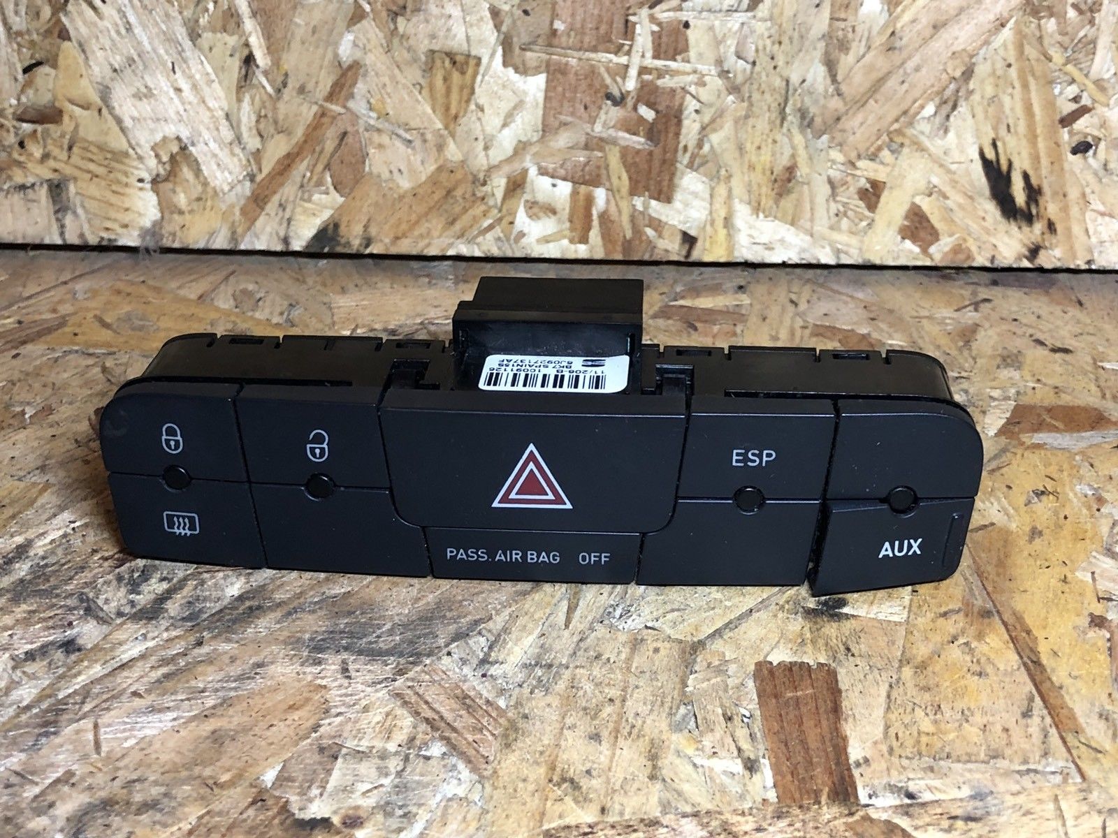

Yep, I got the Button pack from the preface-lift model. Model number 6J0927137AF.
How much does VCDS cost?

After looking at picture I don’t have the same button
As you
Ibrahim
Aug 1, 2018
20
As you
I got this button pack as it was the closest one that I needed. It had the original door lock/unlock and heated windows along with the 3 relocation that I needed ( Hazard, ESP and Airbag off light ). The Aux is not connected to anything. I only got this button pack as it was only £35 compared to the ones Connects2 was selling
