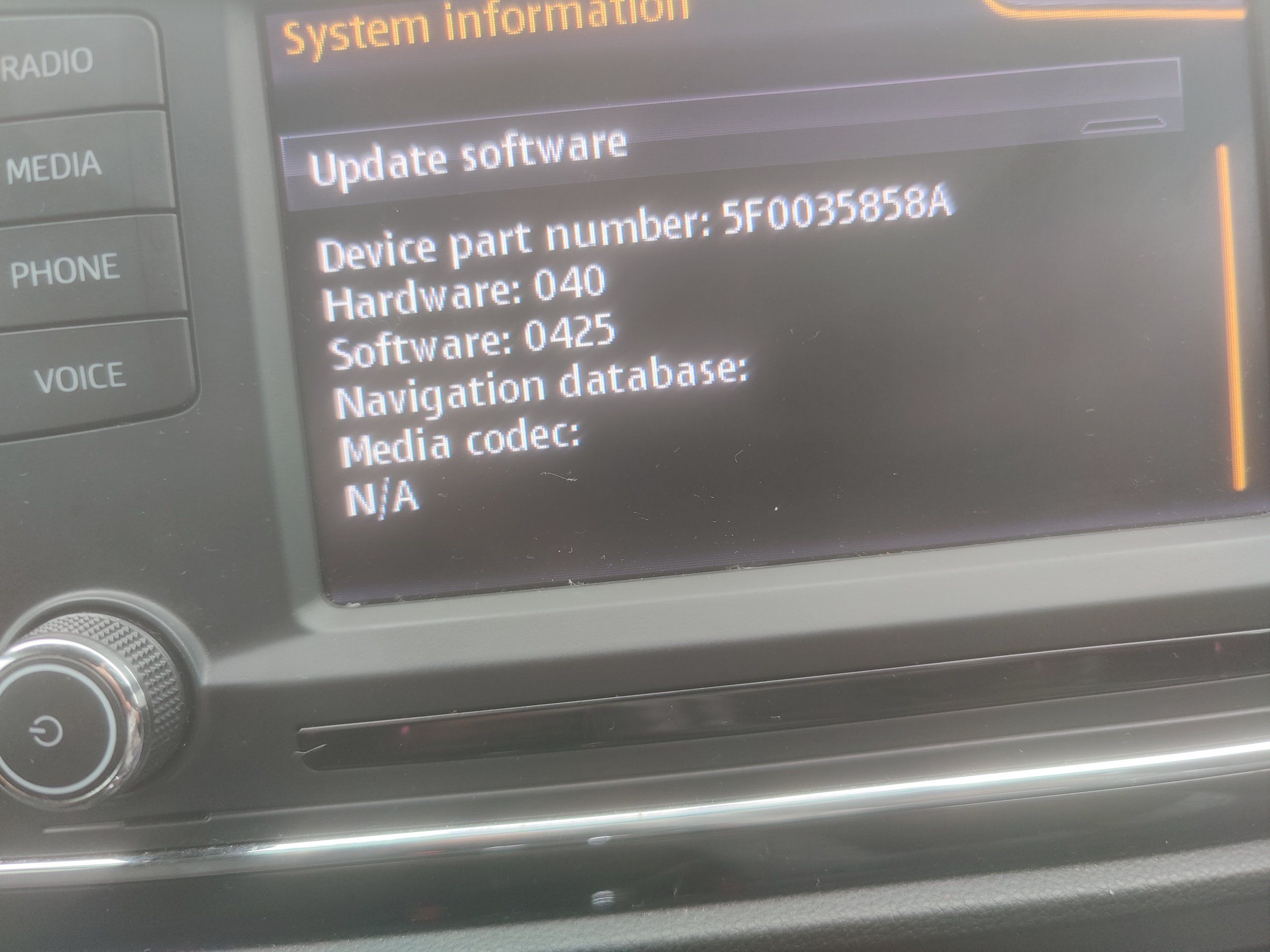

Hi guys I recently bought a 64reg Leon 1.6tdi ecomotive from a used car dealer. Nav gives error message please insert a data medium with valid navigation data. Can you please advise what I need to do to get this to work? Attached is pic of system info.

Hmmmm re-reading and looking at the picture it might very well be a mib1 unit. 2015/16 is when mib2 came in and reckon you got 2014/15. On that basis the lost and found mib1 card. It has been tricky to find historic downloads on those. Two were found 2014/15 and 2015.
If that's the case you can blag a mib2 card that has the VAG CID on it. Delete what is on it and try those two downloads I outlined in the resource. Afraid your mib1 maps will be frozen in time. Nobody has worked out a way of updating mib1 maps. Ofcourse the community here might come to your rescue. You just need an image of the SD that was associated with the unit at the time. Unlike mib2 no easy catch all saves. You might even need to go back before 2014/15 in your search for the map. 2013 and forward

Based on the part number it is a MIB1 :(
Yes what we say on the navigation thread if you love your car you can go for a mib2 retrofit but you do need to be carefull if you do it yourself.... I'm sure the boards retrofitter sponsor could help in one way or another. I mean being careful if you pick up second hand units with CP on, retrofit ones are supplied ready to be installed by yourself or you get a retrofitter to do it. Quite a few people went that route from mib1 to mib2. You then get AA and Car Play and map upgrades good to 2025. You could be a devil and get mib2 high in it with Seat Sound or go off on an audio project. Think it's far too early for mib3 retrofit units.
