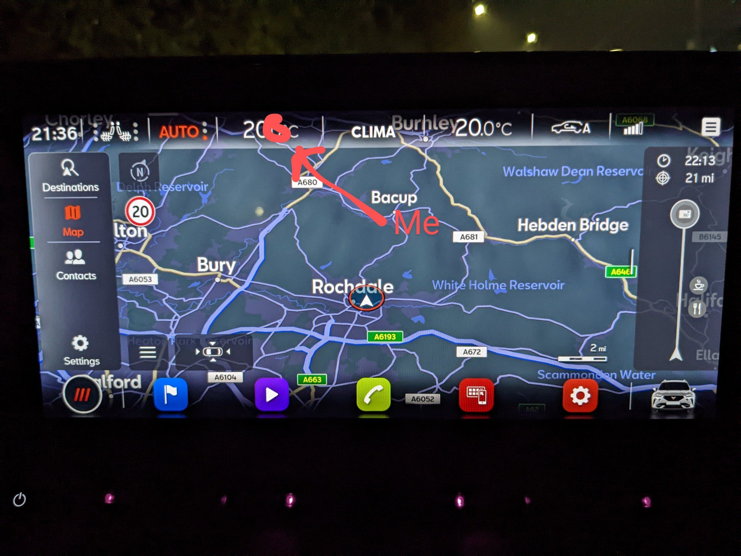

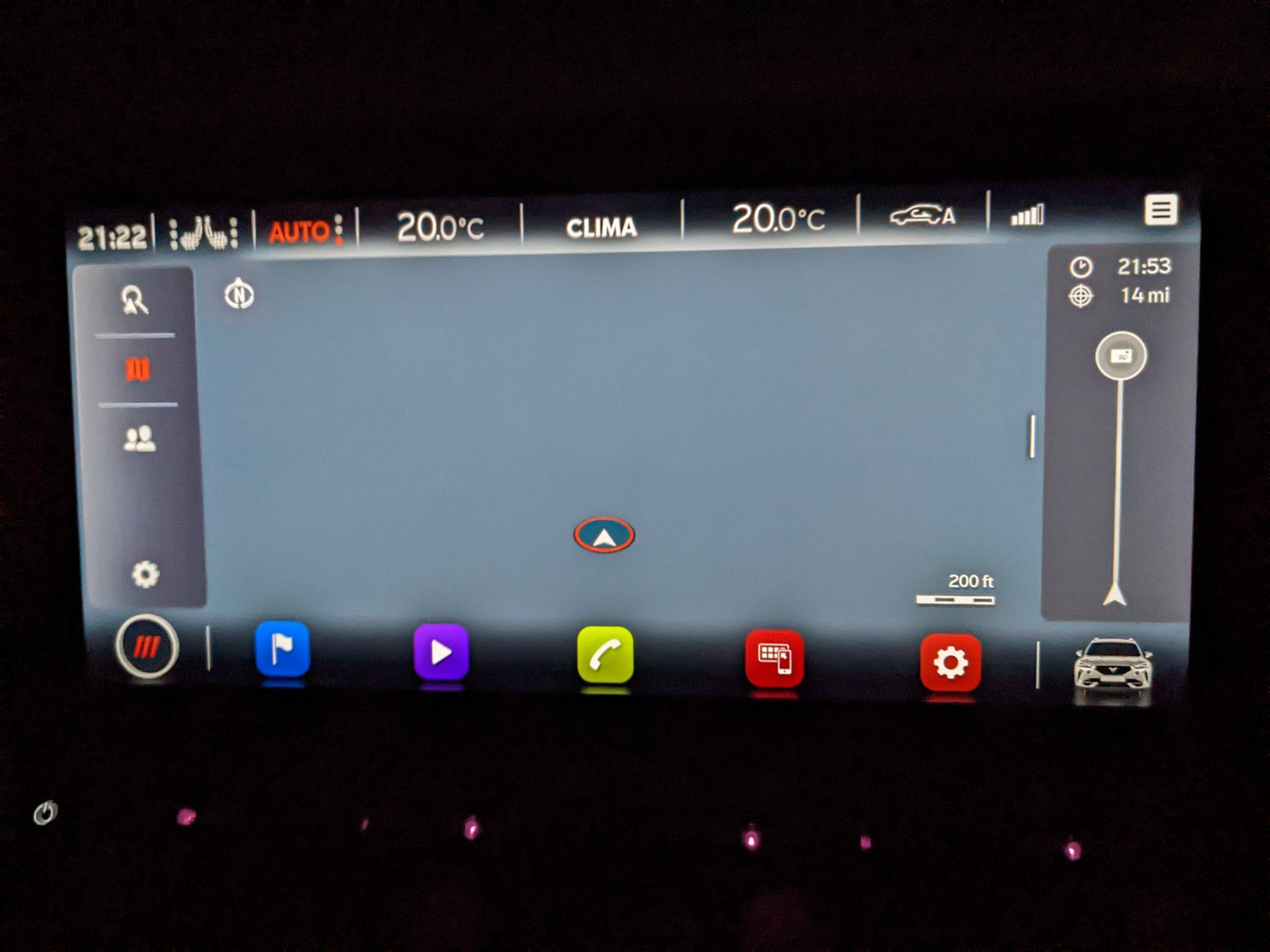

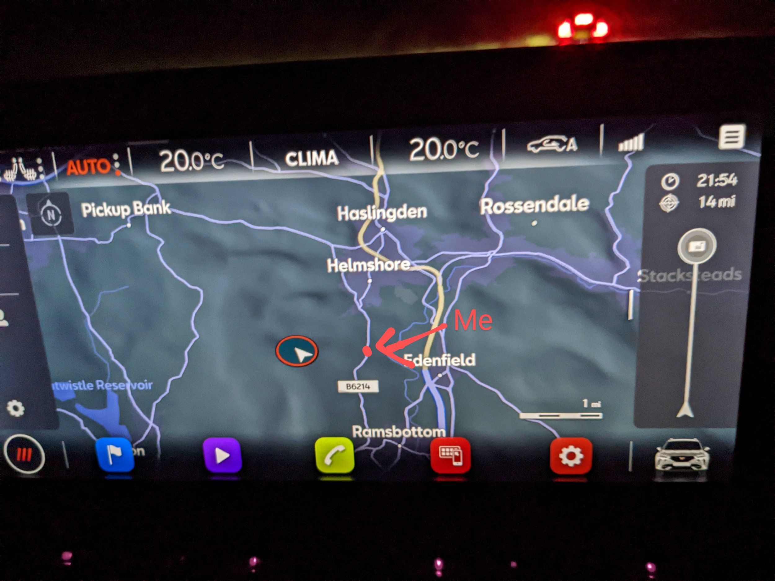

So last night I did a journey about 15 miles from home, all normal, didn't use the sat nav at it's a regular trip. On my way home I got a popup on the dash saying *something like* "no data for this area" with a navigation icon. I checked the sat nav and it showed me driving in a completely blank area (see pic). I then zoomed out, and it was showing me driving parallel to the road I was in but in a field! Now this wasn't a few metres out, it was probably several miles (see pic).
Anyway, I carry on driving the sat nav eventually finds a road, however nowhere near the one I was on. It showed me as being near Rochdale when in fact I was near junction 8 of the m65 (about 20 miles away). I pulled over, restarted the infotainment with a long press of the power button, but after coming back on it was exactly the same. This is probably about 20 minutes after originally happening.

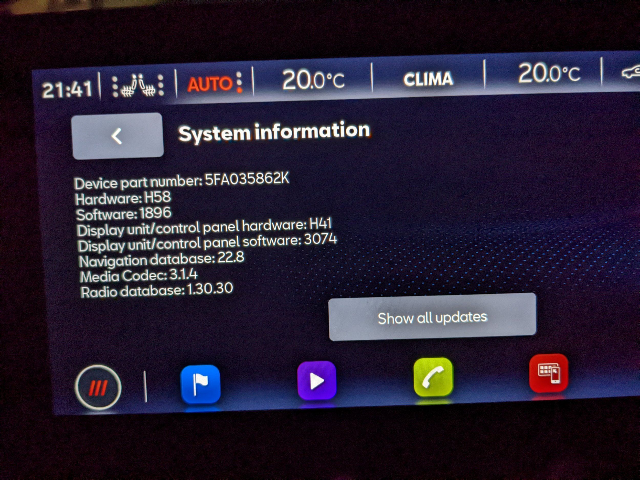

Sw is 1896, showing no updates.
